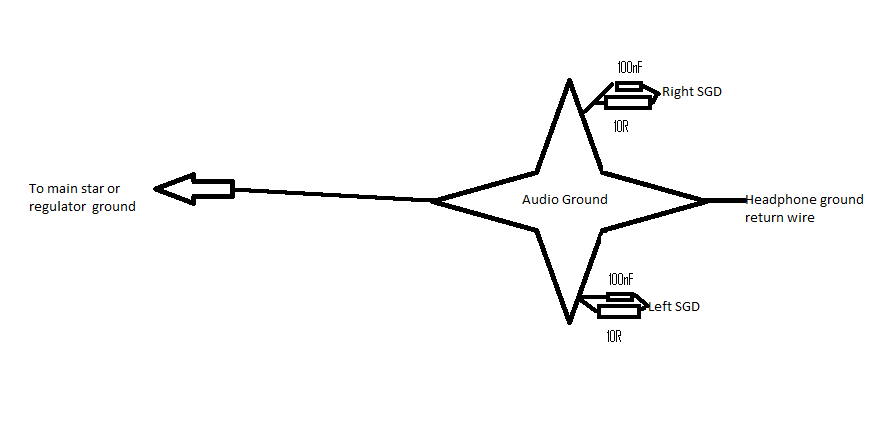

What about this.
Headphone ground return wire goes directly to audio ground and the left/right SGD are each connected to the audio ground through 10R//100nF.
The audio ground is then directly connectd to regulator/cap multiplier ground.
In my opinion this should be the best solution.

Yes, jackinnj introduced the idea in an addendum to your pcb.

about having ground plane
No. Thats fine. can also put a bypass cap across the 10 ohms so the ground is low at Hf and only affective at 'hum' frequencies.
Also can try using shunt caps, as shown on pcb, withOUT lowest esr for damping, if needed.

once again you need to know the frequency dependence - his digital current concentration plot only applies for MHz signal components
the partial mutual inductance Fast Henry sim I posted shows that you're only ~ 1/2 way there by 20 kHz
most Power Supply gnd contamination effects happen at low multiples of the line frequency - your only hope of controlling these currents is by physically restricting the path - discrete pwr/return trace routing - not planes
most audio current effects are also too low for the single plane concept to work
hierarchical gnds, star on star, “clean’, “dirty” paths established by explicit wires, trace geometry, ordering are the audio frequency tools you need
Ott shows how to get these low frequency effects right too - just not emphasized in that link

Dont rule out shielding for use of planes opposite the pcb wires and for low Z at Mhz for stability. -RNM

For perfectionist way -- I always advocate having the power supply reg right at the amp circuit. .. shortest distance from circuit and ditto for the grounds.
Integrate the pwr supply onto the amp pcb is best way. Or, second best, locate the pwr supply pcb right close to the amp pcb.
