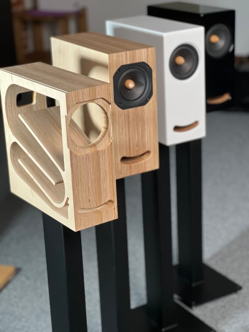

Closer Acoustics OGY
Nicely pretty, but counterproductive curves on that TL.

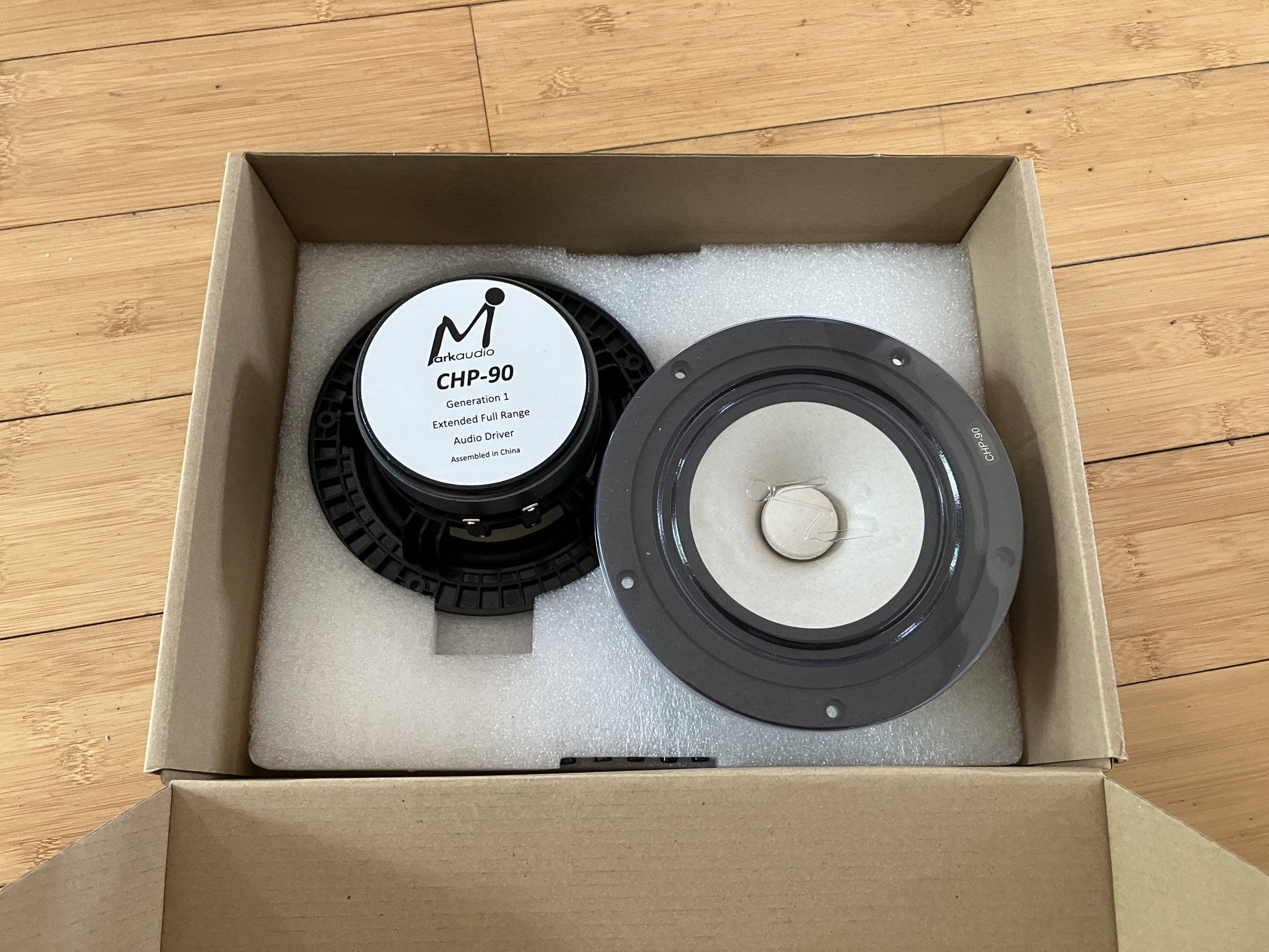

Very different animals other than being paper cone wideband drivers.anyone know how the new CHP-90 driver from MarkAudio compares to the ElectroMagneSpeaker EMS LB5 driver used in the Closer Acoustics OGY speaker?
The LB5, at least using the data on the Solen link, is basically a 4in with an Sd of approximately 50cm^2 or about 59% of CHP90. The general spec. is completely different too; rated travel is 2mm, and it's heavily over-damped with a Q of about 0.13, putting it firmly in the midrange / horn category as its -3dB mass corner is up at 769.23Hz sans any series R or a high output impedance / impedance matching amplifier.
Other than cone area, CHP90 by contrast has a similar Fs, a Q of just over 0.36, double the Vas, and if we derive an Xmax as a voltage input percentage of Xmech, a 1-way travel of 4.96mm. Within the context of modestly sized fullrange drivers, it's 'bass capable' as you can probably see from some of the designs I've done for it on the MA site.
None of this is to say or imply one or the other is 'better' or 'worse' -they're just different, & as-is, meant for different things. It's possible that Closer are using a different version of the LB5 that hasn't made it onto the EMS site yet -IIRC this happened once or twice with the speakers Dave & I designed for Yves using EMS units.

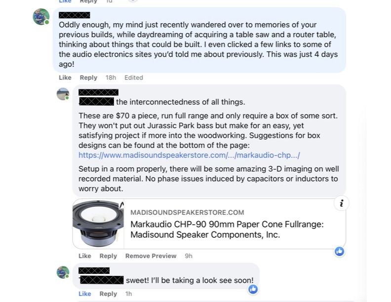

used the new drivers to suck another person into the wonderful world of diyAudio:
Mission accomplished?
