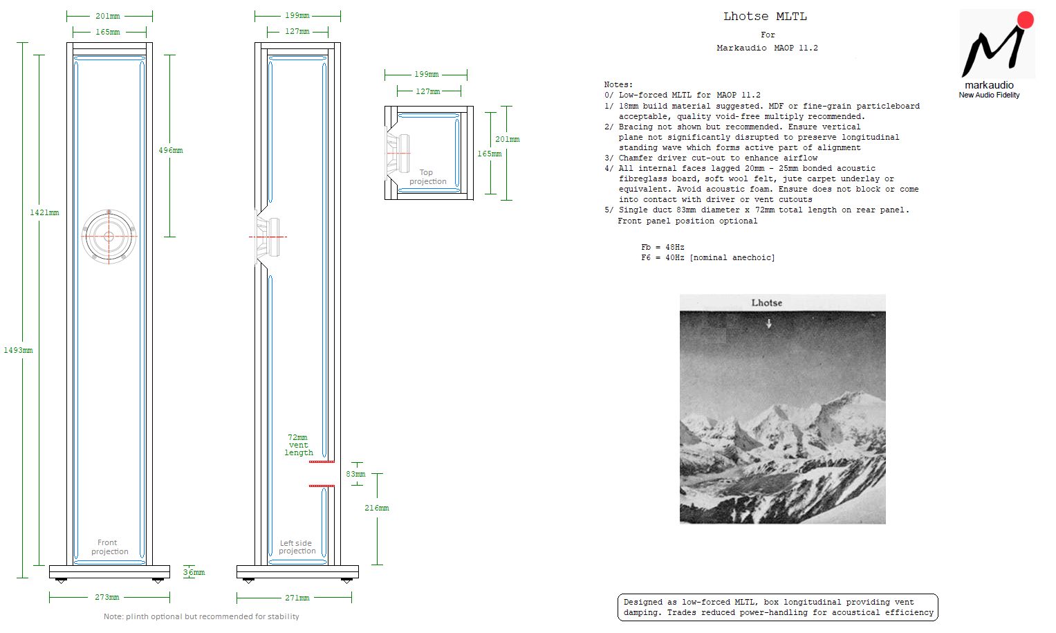

Any cabinet design guidance ... the MAOP 11 being a new driver very few tested cabinet designs around....

I have four on Markaudio's MAOP11 page under the box-plans section. Lhotse is my favourite, as a [relatively] unforced MLTL. I should probably do some more.Any cabinet design guidance ... the MAOP 11 being a new driver very few tested cabinet designs around....

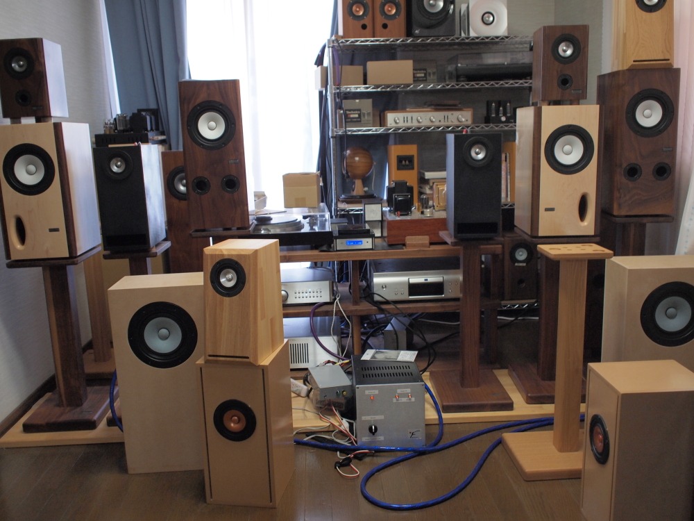

quite a collection of full rangers
This is an audition speaker for sale, not for collection.
Mr.Nakajima of the Japanese distributor does not like the sound of resonance (BH, ML-TL, and TQWT, etc).
So the Japanese distributor sells only bass reflex.
I may be the only one who has built frugel-horn in Japan.
The definition of optimum being? You didn't give me any feedback on the overall dimensions I forwarded, what you liked, what you would have prefered etc., so without that I can't do more.
You have mail: I've forwarded my email of the 17th & 21st again, as it seems to have gone astray. You'll see it includes the basic external dimensions of two enclosure options, one of which is on your specified height limit, the second being a little shorter and slightly wider to compensate.
Hello,You have mail: I've forwarded my email of the 17th & 21st again, as it seems to have gone astray. You'll see it includes the basic external dimensions of two enclosure options, one of which is on your specified height limit, the second being a little shorter and slightly wider to compensate.
What would be the best way to place the speaker wire inside the cabinet in case of a MLTL design ......
Same as any other enclosure really: quite literally 'as you like', just ensuring it doesn't rattle against the walls, driver, duct or braces, or if it punches through an internal baffle, that the gap is properly sealed (last three as / where relevant). It's more an aesthetic choice than a functional one about where you prefer to connect the external speaker leads.

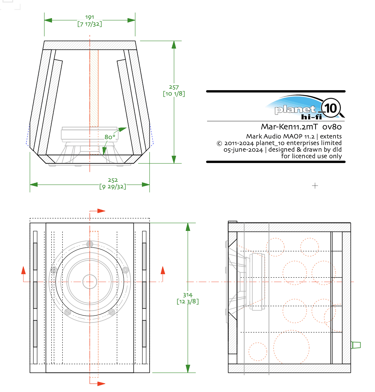

I have an early version of the MAOP 11 trapezoid miniOnken. Asked earlier, a Compact Floorstander isn’t going to happen, uness someone is interested in a Twin.
Like the M10.2, M11.2 fits a different box than the P11 it is derived from.

I like to built the Lhotse with these beauties.

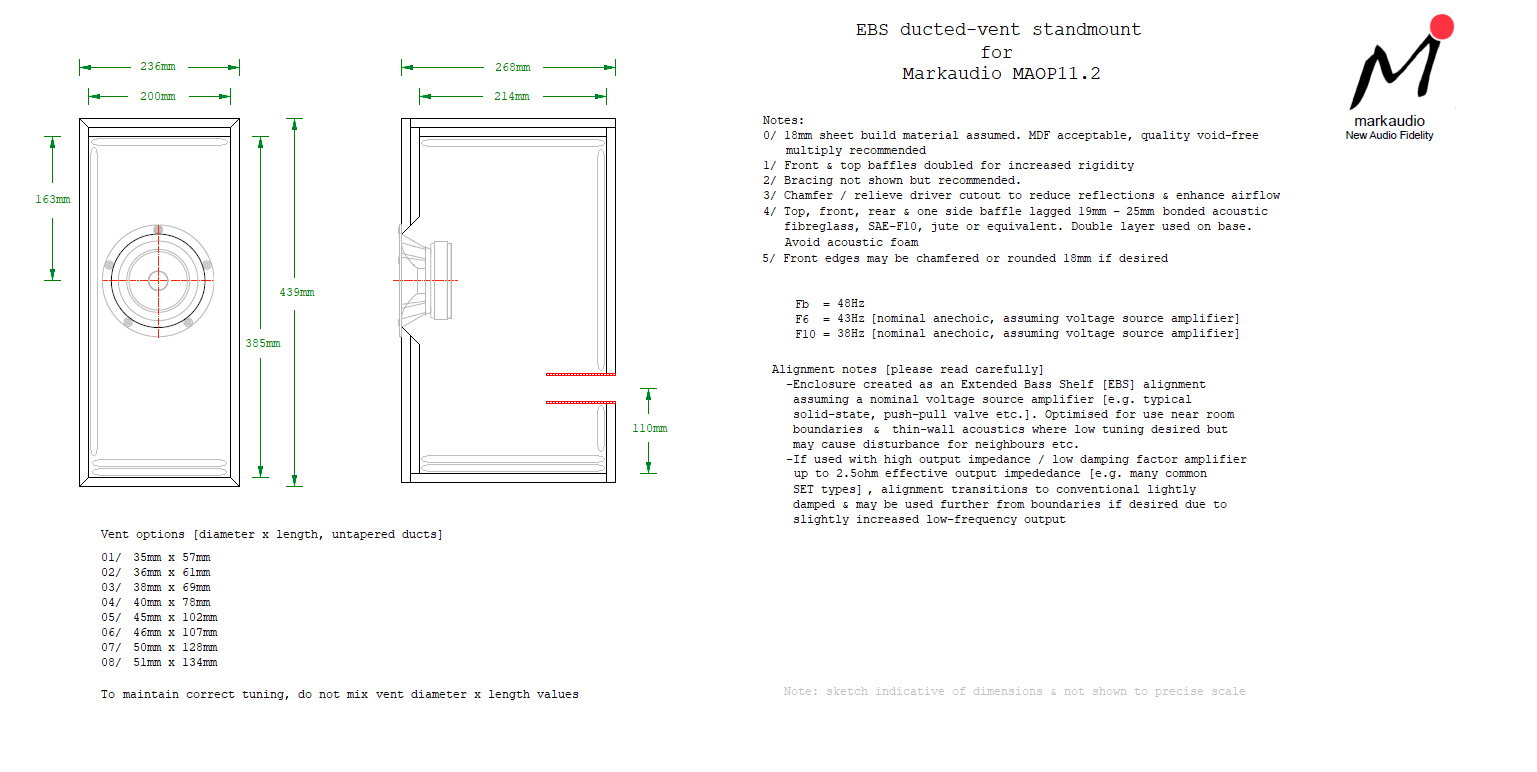

Or EBS?
