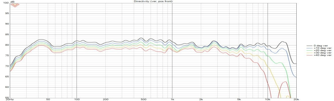

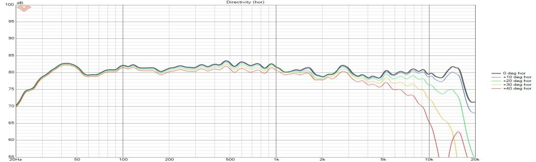

Sim and posted concept for a WAW with cheapo drivers and rather large
cabinet for deep bass, but uses high Qts driver sealed
12" and 2.5"
With baffle compensation and efficiency of 2.5" driver
82 dB.
