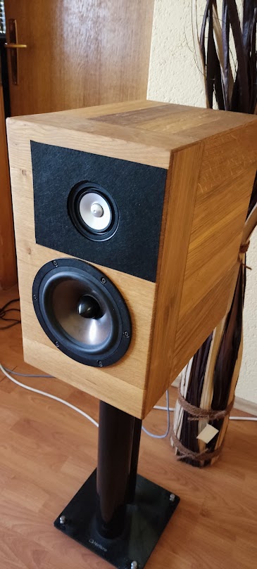

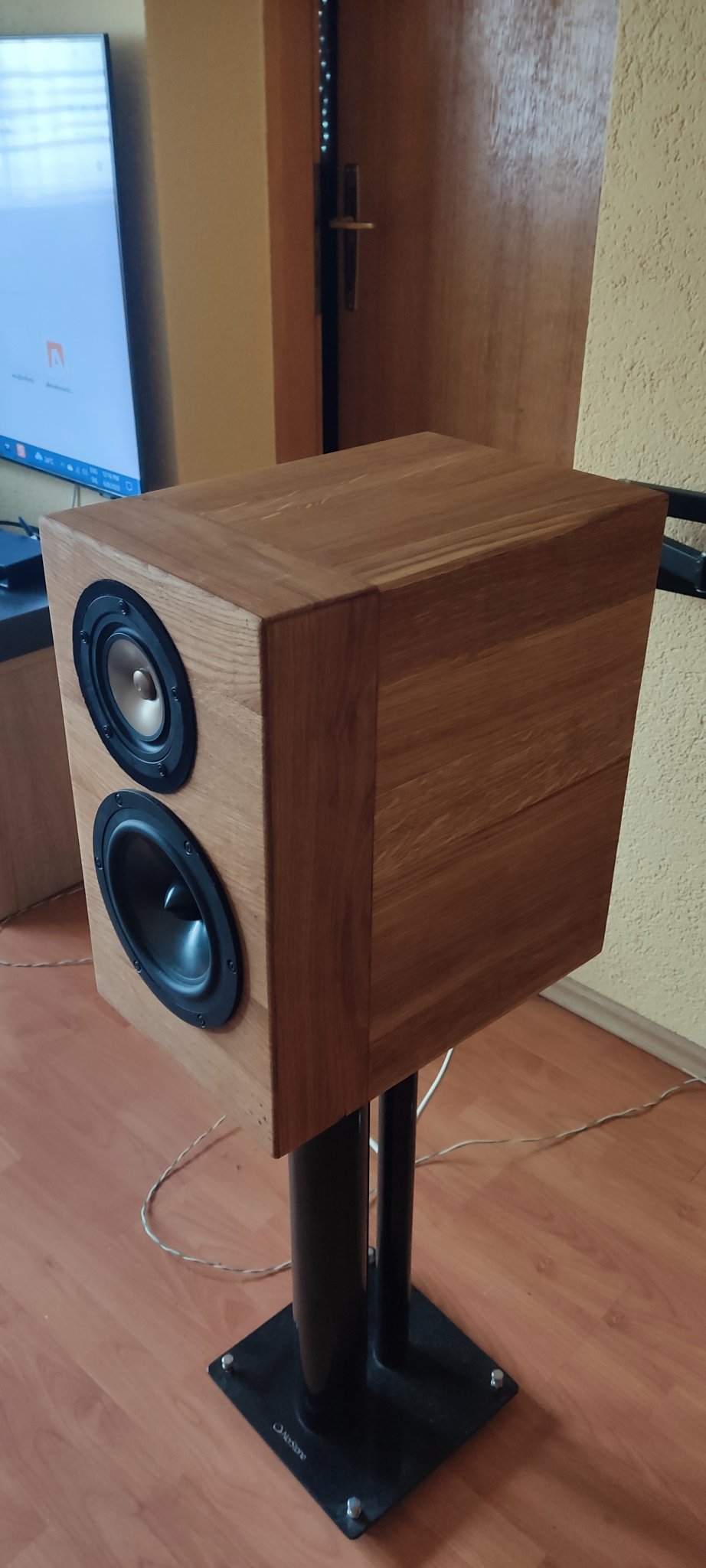

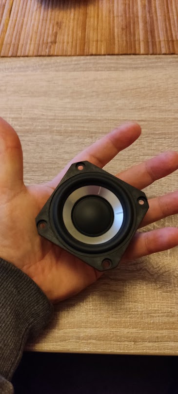

Hy folks,this is my recent diy fast speaker build.The first version was with pluvia 7.2 hd as midtweet from 400hz -20khz in separate 4 lit volumen ,and the second version is with chn50 from 600hz-20 khz...and i preferred the second one because chn50 rendenered high freq much better.
Dayton rs180-8 woofer is tuned at 40hz in 19 lit br box ,and its great woofer for fast type speakers.

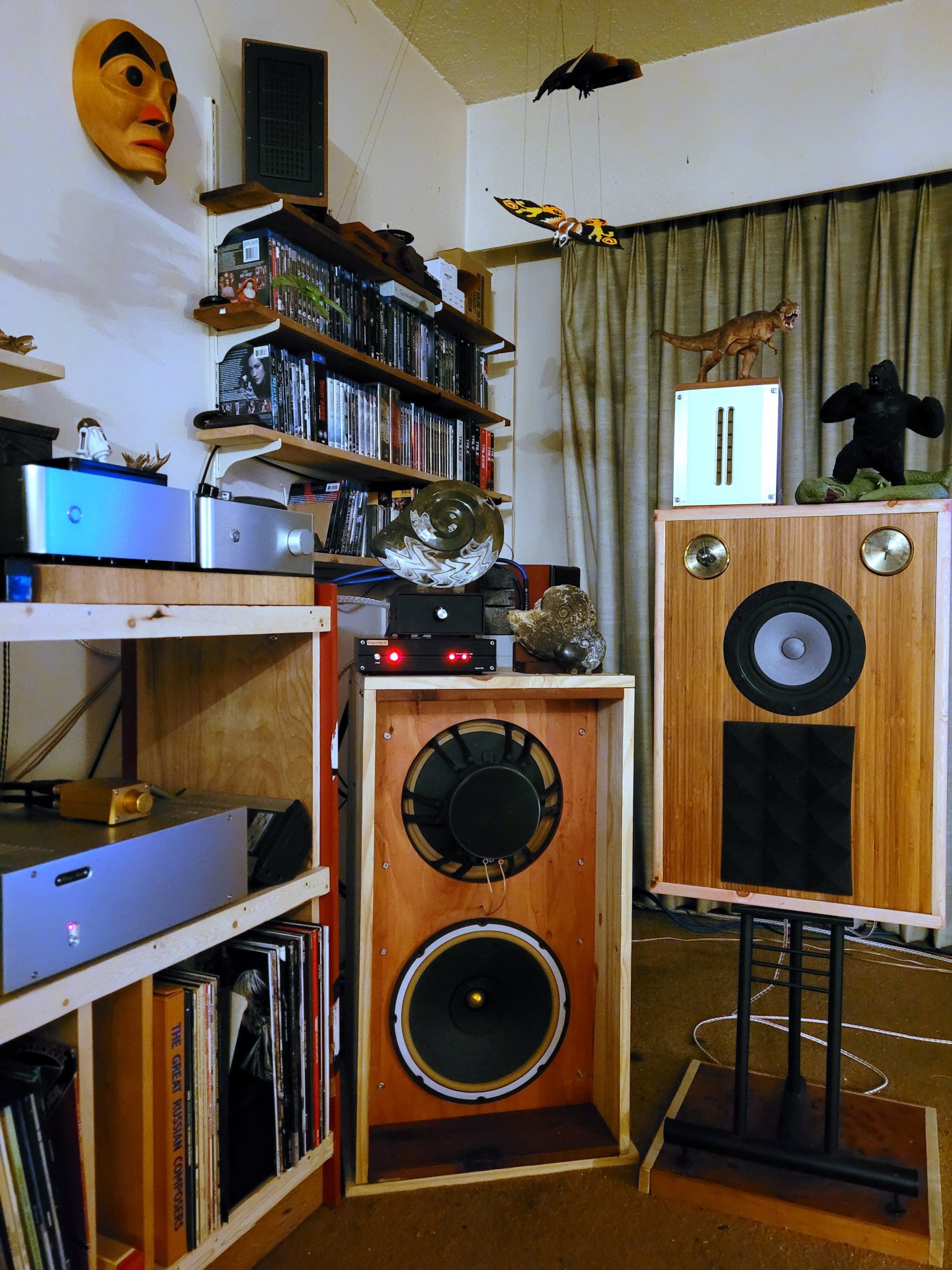

Tysen’s sidefiring drivers cross at 450 Hz which is higher than i expected possible. It is th erhighest we have crossed a WAW. 250 Hz is a more common target.
By voicing I assume you mean similar cone materials?
Not necessarily. For instance the paper cone A12pWeN in the MTM i posted above matches very well with the metal cone A7.3eN. Do keep in mind that much of the character of a midWoofer is highe rup in frequency than when using them in a WAW.
The A12pw match a tiny but better than the more exotic composition of the SDX7 we used in my favourite WAW (comes down to the shape in my room). Sadly another really good midBass MIA.
Nice looking speakers. Have you published the design?

Thanks Trevor,i didnt publish anything because its still in development and iam using dsp software(EKIO) instead of passive,its easier to change cutoff freq,bsc and etc....and i recently bought sb acoustics sb65wbac25-4 drivers,and i havent test them yet.
