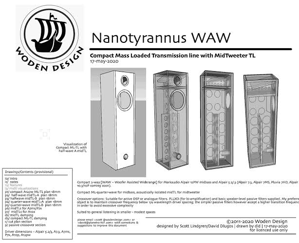

Employing the Nanotyrannus cabinet from Planet10.
From Woden Design.
Scott’s design, i did the drawings (and helped with the midTLs).

If you are on a budget, Tysen V2 has somethign like a $200 driver budget (less with CHN-50 [an absolute bargain]), or all the way to things like the WAW i helped design with A7.3 and a pair of push-push scan woofers.
Things like Halcyon, our big MTM, Scott’s Nanotyrannus are limited by NLA woofers.
