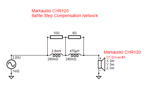

Definitely try it with my suggested schematic. Personally I was not able to enjoy the driver without the circuit in place. The sound is much more balanced and allows listening on-axis. Listening even just 15 degrees off-axis causes 10kHz and above to fall off quickly, losing critical spatial information.I've listened to recordings on the CHR-120 and they actually sound good in the treble. I am suprised. That should be consistent with the low distortion. Thanks for the good info.

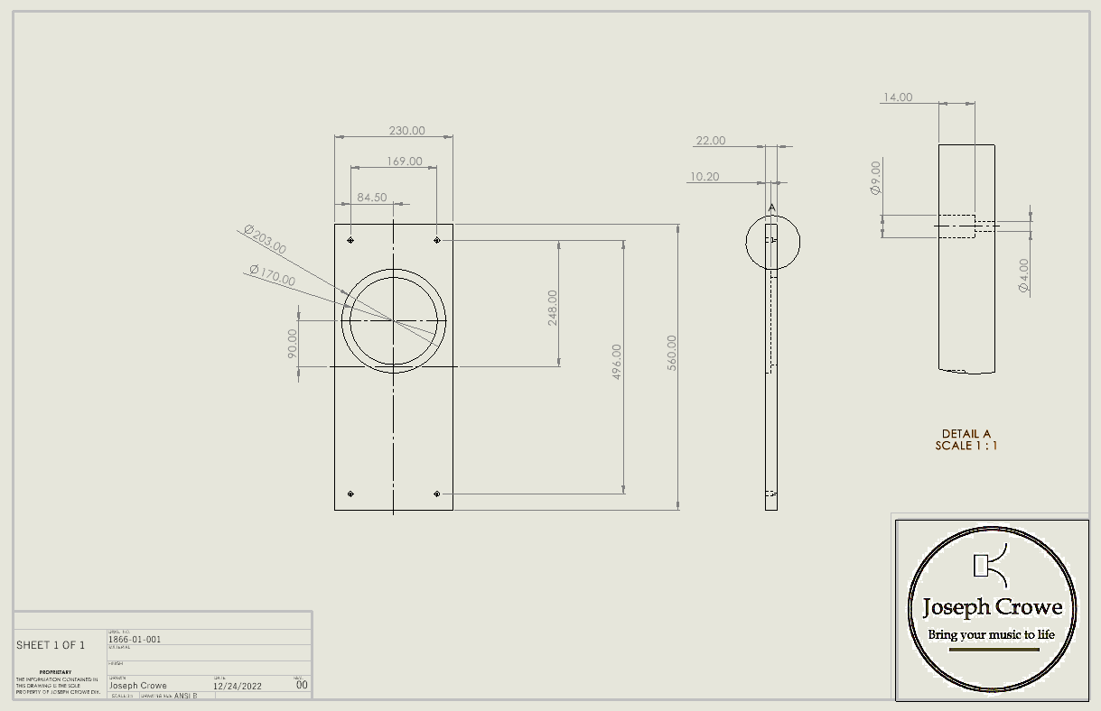

Could you please share the box dimensions ?

Looking at the CSD, would this be a good case where you would want to introduce notch filters in your dsp if you use one?
