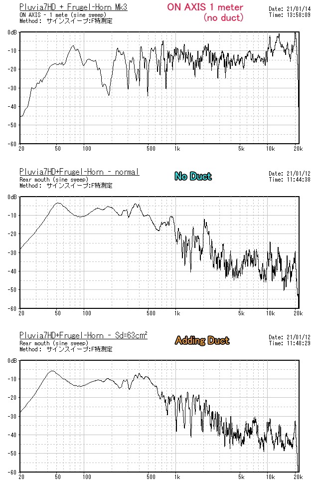

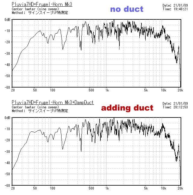

The rear mouth chart looks to me like there is significant drop (-5 db) in bass output below 200hz with the duct added.
What am I missing? It looks much worse to me. The sound was too "boomy" too much upper bass before the duct?
Please don't trust the words or graphs of others.
By all means, do your own follow-up tests.

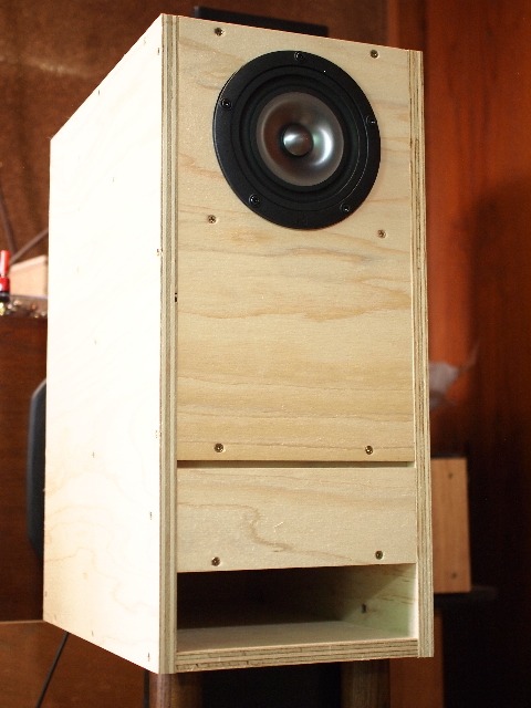

This enclosure has a unique construction and does not use sound absorbing materials.
Compared to enclosures of other structures, it produces a unique sound.

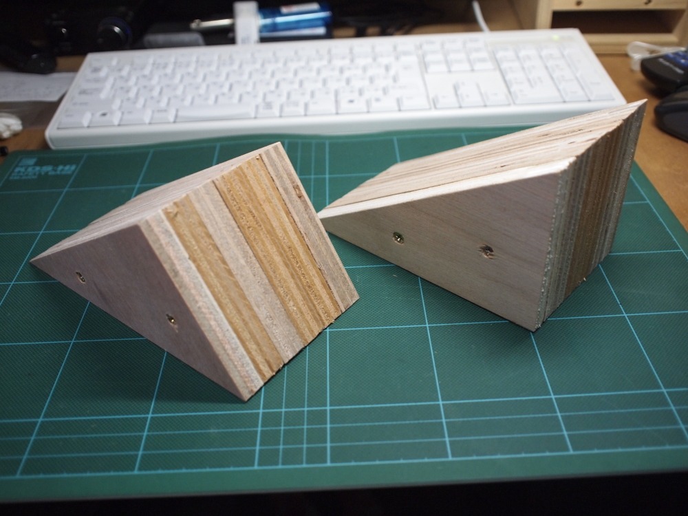

Nandappe No 4 & No15 are forming triangle cavities ? From the videos you have uploaded to youtube the sound to my ears is clean and balanced . Not "bright" as with DDBH.
The touching points between 2&3 , 8&9 (and some more) are left "just touching" and not airtight joined on purpose ?

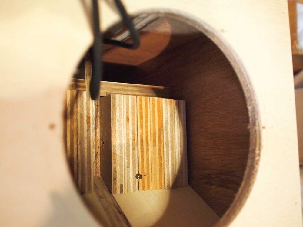

Parts 4 and 15 are for volume adjustment.
They are currently removed and adjust the volume of the back chamber.
In CHP-90, used two triangular block.
2 and 3, 8 and 9, and the other line adhesion, but it is not cut diagonally because it is troublesome.
If you use glue and screws together, I don't think there will be any gaps.
Please use any kind of wood you like.
Hard wood will sound hard and soft wood will sound soft.

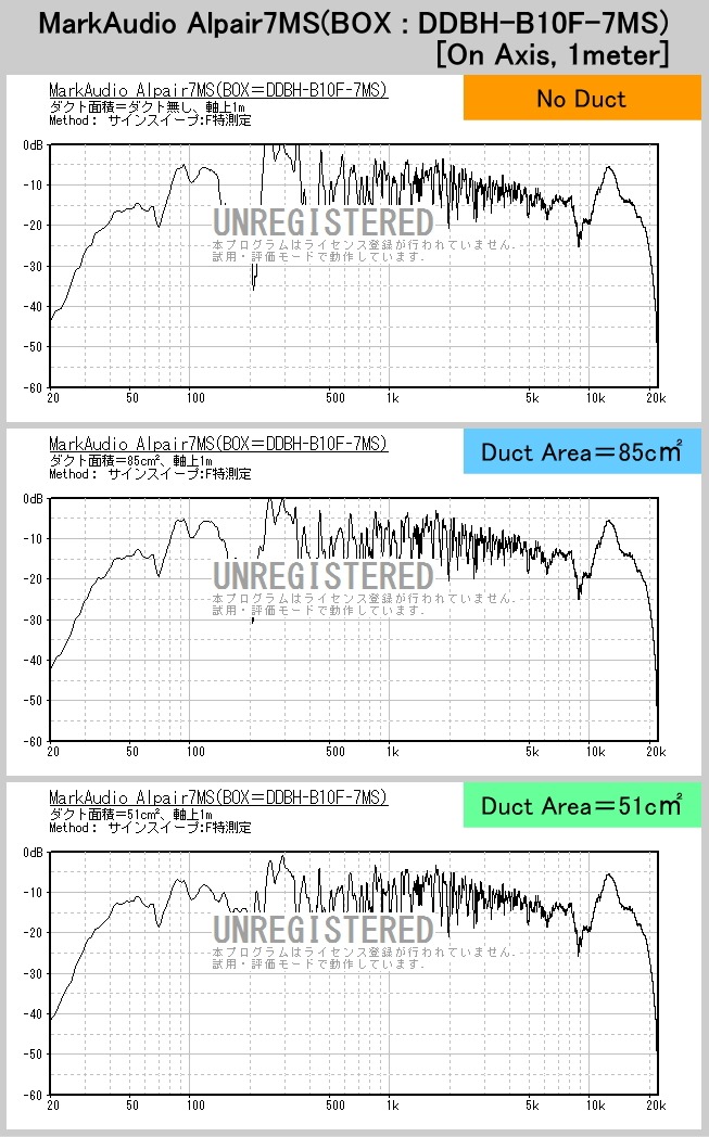

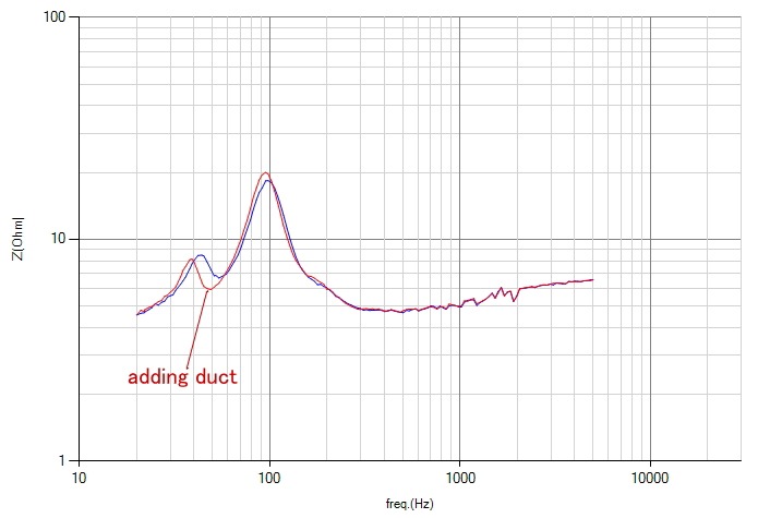

I get that about the adjustable ducts, but once decided for a specific driver they are not that useful. The 1 m response is OK but more usefull when testing the duct opening is to measure the response of the driver at very close distance. There will be dips in the frequency response at the driver corresponding to output from the pipe. Reducing the duct area should just lower the frequency of the dip until the area is substantially less than the cone area say 0.5-0.7 of cone area. Then losses will start to reduce the output.
The effective output is a bit more complicated due to phase differences in the outputs ducts and driver, vector additions anyone?
