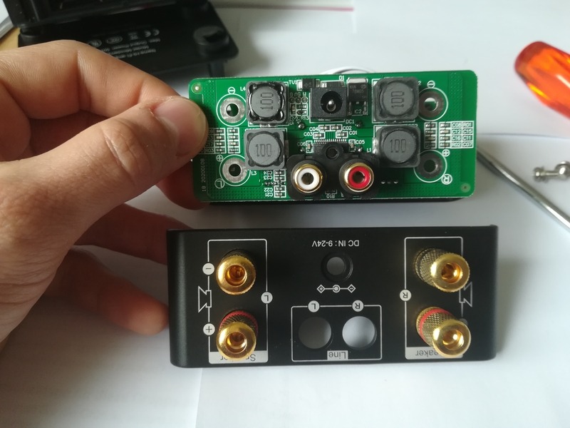

Texas Instrument TPA3116D2
MAX 50Wx2, 9V-24V supply, class-D
I used 20V.
It's an extremely cheap amp you can find for $30.
Naturally they had to cut lots of corners for that price but I'm surprised it sounds as good as it does.
check out pics of disassembly of it here.
There are some interesting design choices they made to reduce cost that may actually help the sound.
Like how the both the RCA connectors and speaker binding posts connect directly to the PCB for no wires and short signal path.

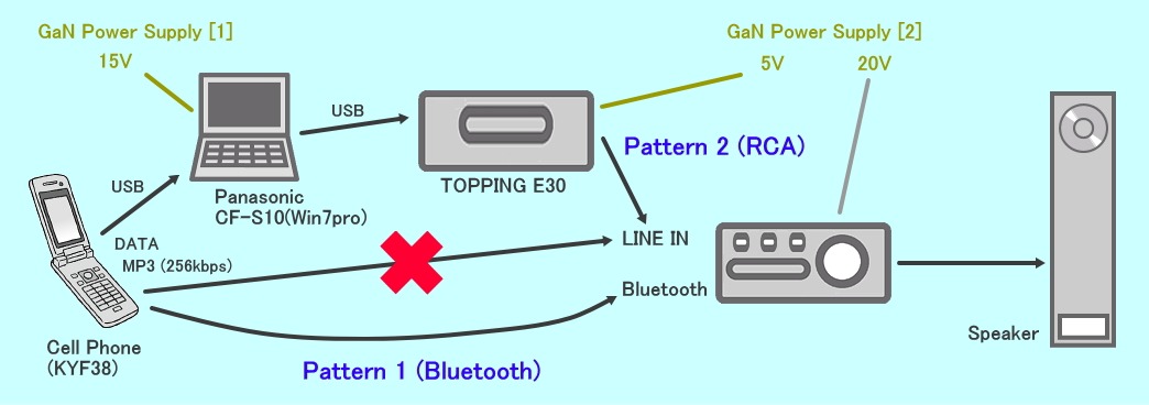

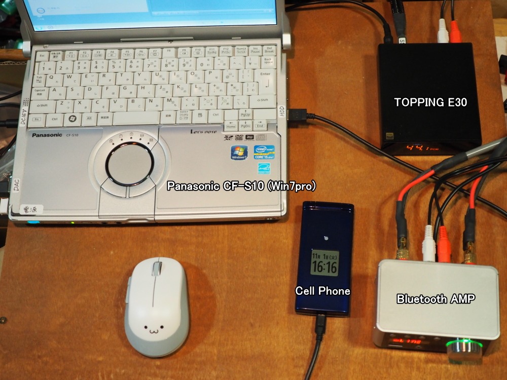

Cell Phone(KYF38) does not have LINE output, so I used RCA output from PC and DAC.
I also recorded Bluetooth so I can compare with CHP-90 mica.
Now, can you tell the difference?
Pattern 1 (Bluetooth) - SB20FRPC30-8
Pattern 2 (RCA)- SB20FRPC30-8
Pattern 2 - The singer and the musical accompaniment sound better balanced.
I opened a little the distance between my desktop speakers (2 m apart) and listening at the sweet spot.Now, can you tell the difference?
The singer at the left side of the stage , close to drums. Not a wide stage. The impression is that all instruments are "electrical" - plugged-in . I have some reservations about the percussion. Maybe it is "real".
But after 2 listening to both tracks, no difference. Maybe this

This is awesome, thanks for taking the time to do this. 👍
To me pattern 2 through the PC sounds a little better. But is the difference big? not to my ears and the cheap headphones I'm using atm.
And both recordings with the SB speakers (to me) sound better than the recording using the MarkAudio speakers.
To my ears the more forward mids of the MA obscures some of the low level details and the SBs just sound smoother and more relaxed and musical to me. Perhaps the MA provides more detail in the mids at the expense of being a little "bright" sounding. I't a subjective opinion of course.
PS. a good trick would have been to not tell us which recording was pattern-1 vs pattern-2 and let us decide blindly which we prefer 😉
Also, obviously just using this one song/recording is hard to judge the overall quality of the system and speakers' differences, but it's still interesting and enlightening!

amp disassembly video for you DIY hardware hackers/tweakers ;-)

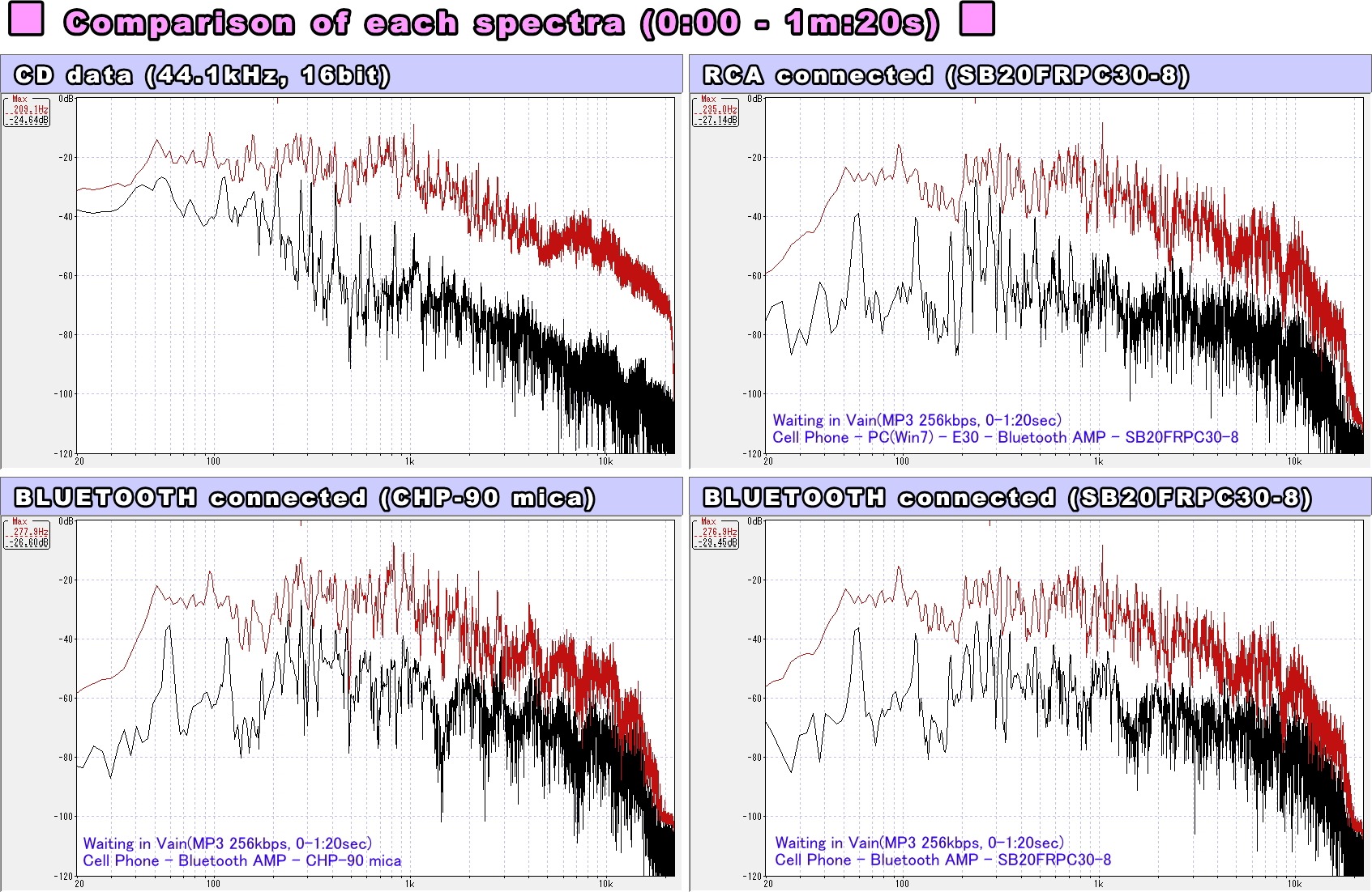

TPA3116D2 chip is a perfect match for the CHP90 and SB20FRPC30-8.
If we listen with our eyes closed, no one will think it's a $30 amp.
I compared the spectra.
It's satisfying to hear and see.

I think the power supply is more important than the power chip for a class-D amplifier.
Changing from a switching power supply or analog power supply to a GaN(gallium nitride) power supply can improve sound quality.
This time I used a 100W (20V, 5A) PD(power delivery) power supply.

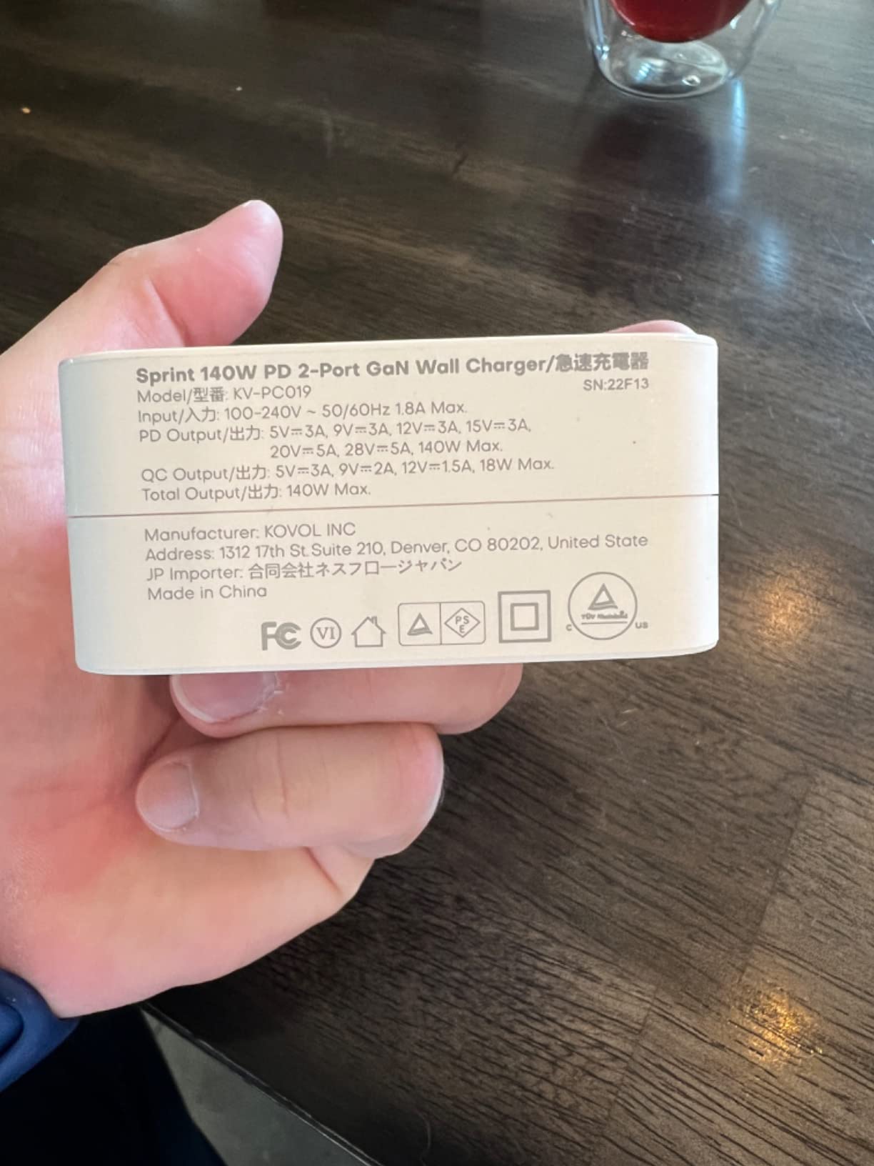

@nandappe or anyone, do you know how these switching "rechargers" power supplies act when connected to an audio amplifier that does not operate according to the "QC" (quick charge) protocols? do they just supply their max voltage?
eg., the Kovol KV-PC019 in the pic below it will supply it's maxiumum 28 volts to the amplifier?
the spec's say it can produce 5V⎓3A, 9V⎓3A, 12V⎓3A, 15V⎓3A, 20V⎓5A, 28V⎓5A, 140W Max.
Although elsewhere on their site it says the type-c port can produce 120 watts
eh, I just read that these PD 3.1 adapters (power delivery) won't go above 100 watts without the power sink negotiating that. So I guess they won't work well for amps.
It appears that using the "Trigger Cable with e-Marker (20V)" for the PD power supply can take up to 20V, 5A.
So far, 20V, 5A, 100W seems to be the upper limit for the cable.
I do not know about the KV-PC019.
I have never seen a cable that can take out 28V, 5A, 140W.
The amp I used is 12V-24V (max,50W+50W) compatible, so I could use it.

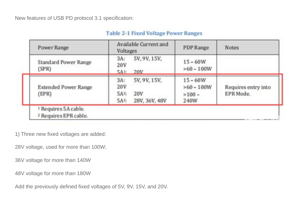

yeah that works OK for a TPA3116 amp but I bought a TPA3250 amp and want to use a 24 volt (minimum) supply.
I was hoping I could find a GaN supply like this that would output 24v and 4 amps at least, but I'm not having luck so will prob buy a more traditional laptop-charger type. The 3250 can use up to 32v supply and often recommended is 24V 5A
maybe I can find a notebook style charger that uses GaN technology.
I think the key is in PD 3.1 this requirement "entry into EPR mode"
and maybe the power sink device (laptop, amplifier, LED lights) need to trigger this or maybe a special USB-C cable can do it? I don't know.
