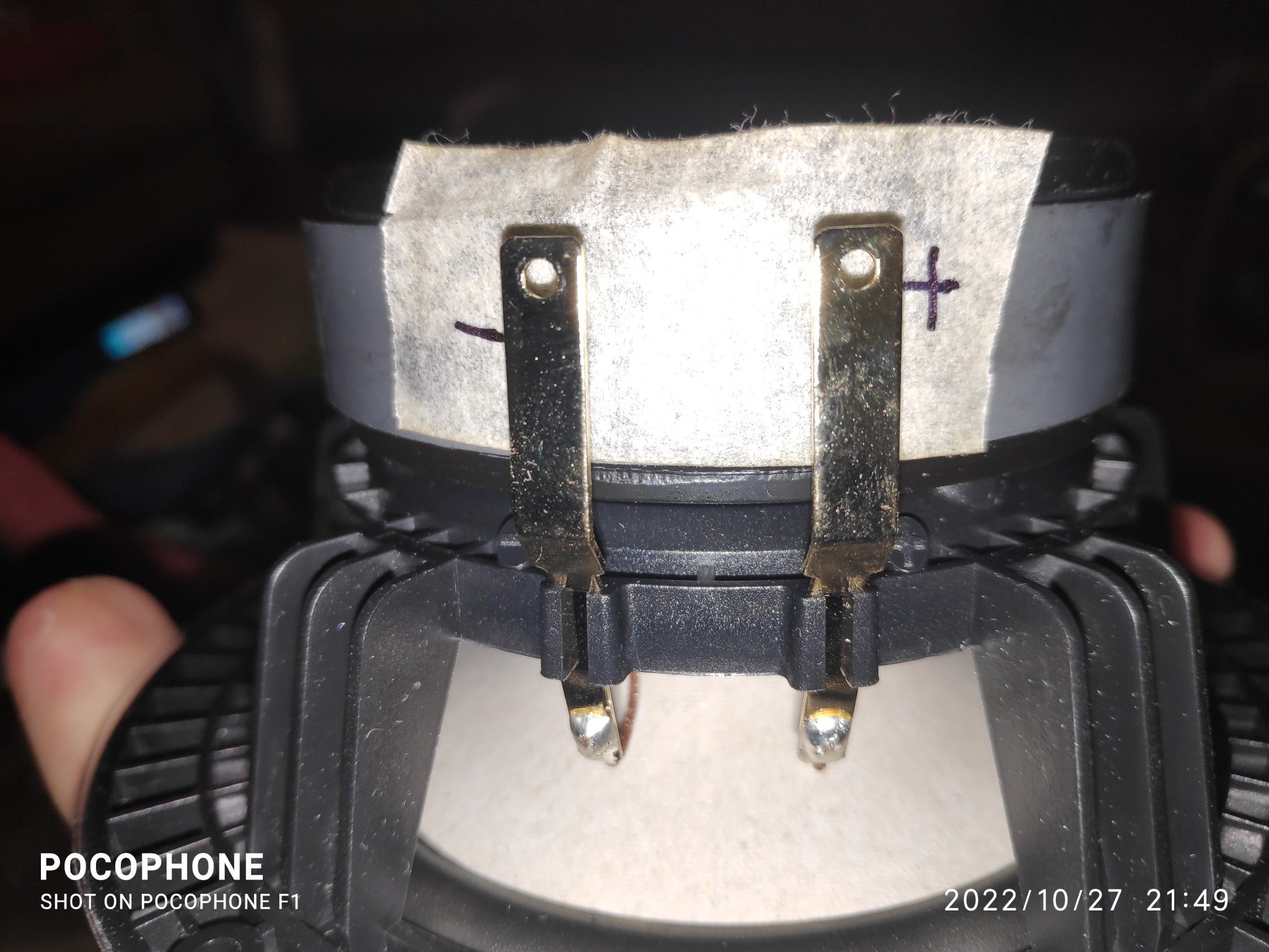

Me too. Best way to find out who is + and -.When I will return from shopping I will try to investigate polarity, using an almost "dead" 1,5V AAA battery.

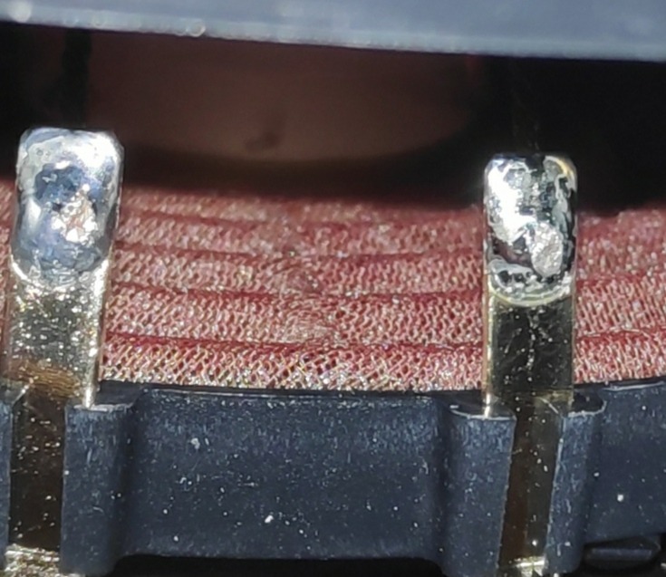

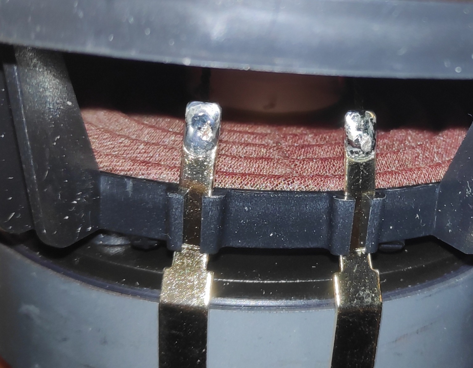

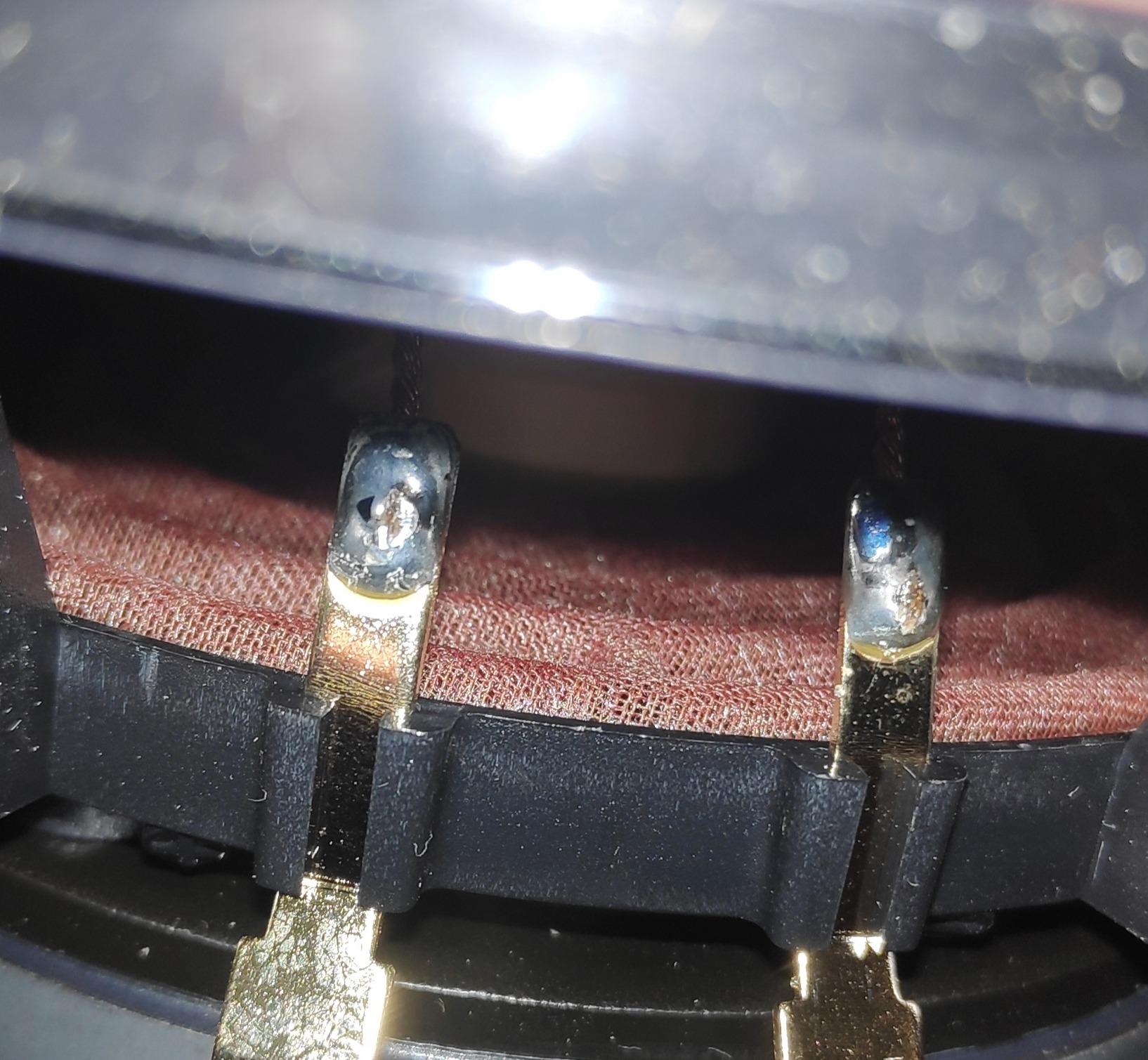

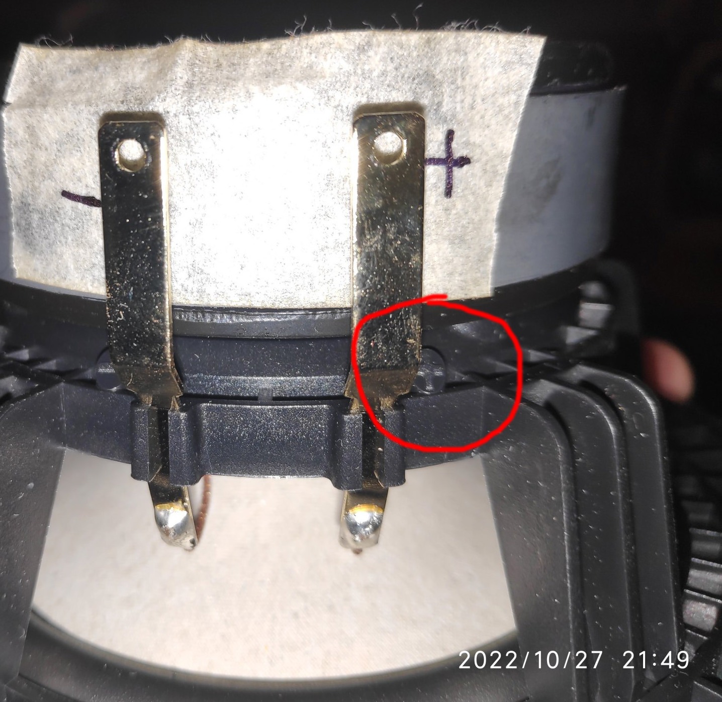

DC resistance Driver 1 : 6.1 Ohm
Driver 2 : 6.1 ~ 6.7 Ohm
(if you observe the photos you will see a very poor soldering + small drops of solder on the spider - 1st & 3rd photo - and maybe a scratch)
Very badly surprised if you look carefully the photos .
The polarity (luckily) is the same for both drivers.
If this is the typical Mark Audio quality it is almost waist of my money

I can assure you that mine are top notch quality.
The only complaint I have is that + and - are not marked.
Sad for you. Maybe you can complain about the quality at the dealer and get them replaced.

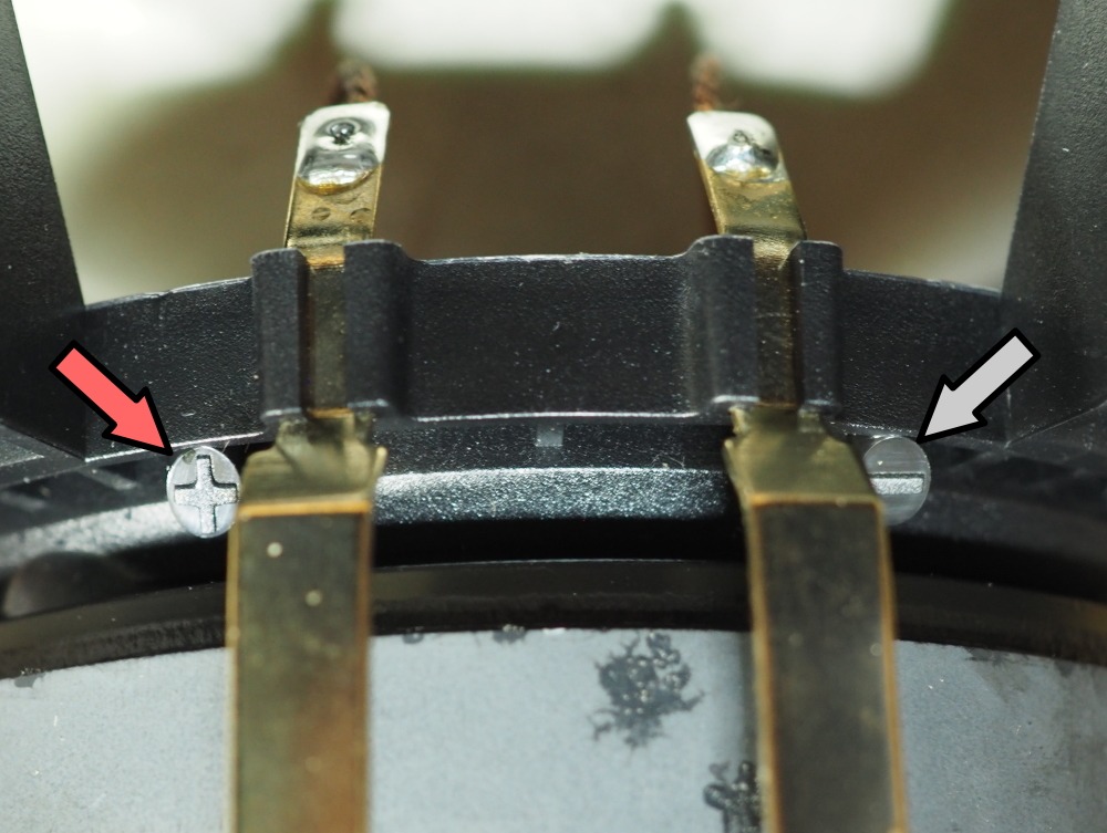

MarkAudio's polarity indicator is hard to find.

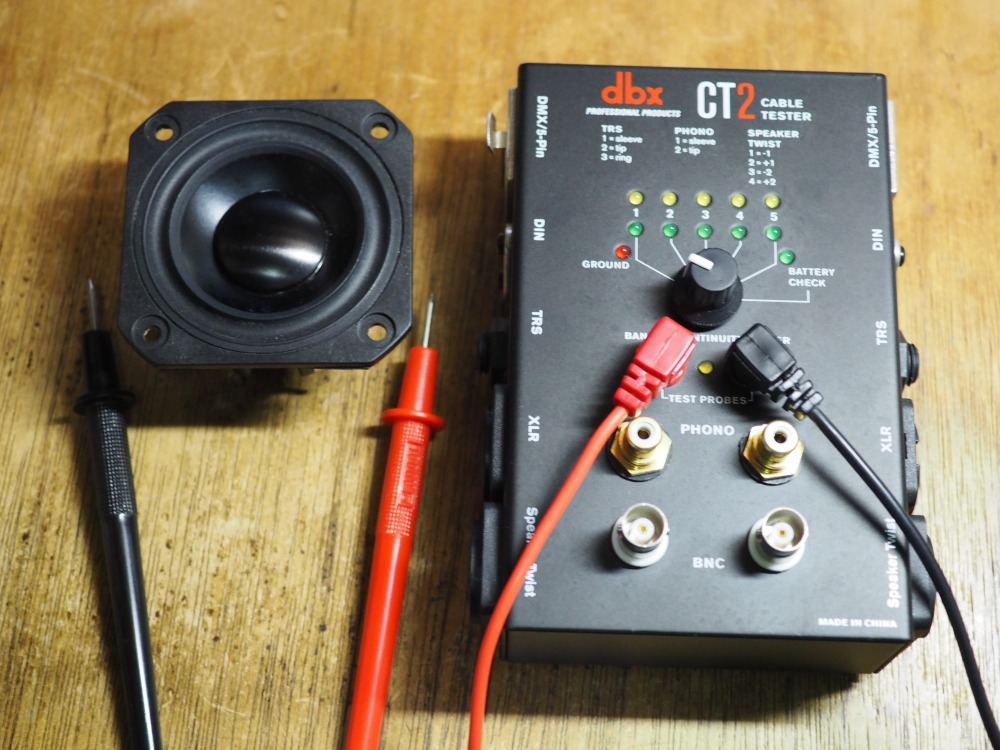

I use dbx CT2 to check polarity.
I think MarkAudio's assembly quality is better than other companies, and my CHP-90 seems to have no problems.
If you are concerned about it, why don't you have it replaced?
Incidentally, Fostex had a magnet that was out of alignment, and Scan-speak had a magnet that fell off.

I already e-mail to soundimports and I had an answer. Οbviously I don't blame them for the sloppiness of the production chain. Ι doubt if they opened the boxes they received from china. After my close and intend inspection (professional perversion 😒😒) of the drivers I left those as they were iin their box waiting "support" to examine the photos I attached (same as in my previews post). I like to believe that it is the results of "cutting the cost" for this driver and not the standard orientation of the company (Mark Audio)I'm sorry you received substandard elements.
The only complaint I have is that + and - are not marked. waiting

my professional eye caught the imperfection (common in multi stranded conductors) that leads to partially poor joint (the left pole "+" ) .
dbx CT2 . Nice you have it . As for polarity indexing you are right ! It was tricky to see the marks on that little inclined plastic blobs.

It would be better if soundimports forwarded my e-mail to MarkAudio's production manager. It is very tricky and maybe risky to try remove with a very thin curling tongs those very tiny soldering blobs from the spider. New drivers ? Maybe is the best but will they accepted it ? At whose expense ? After how many months ?Good that you contacted them. It is the fault of the Chinese that they are not so thorough.
Mark Audio certainly does not want to ruin their reputation.
Although have seen a few mistakes lately.
You can't complain about the supplier, but of course it can happen at all levels.
Hope to get new drivers so you will be satisfied. 😉
The + and - are in an unusual place but they're there!!!Me too. Best way to find out who is + and -.
Took a bit to find them... 😉

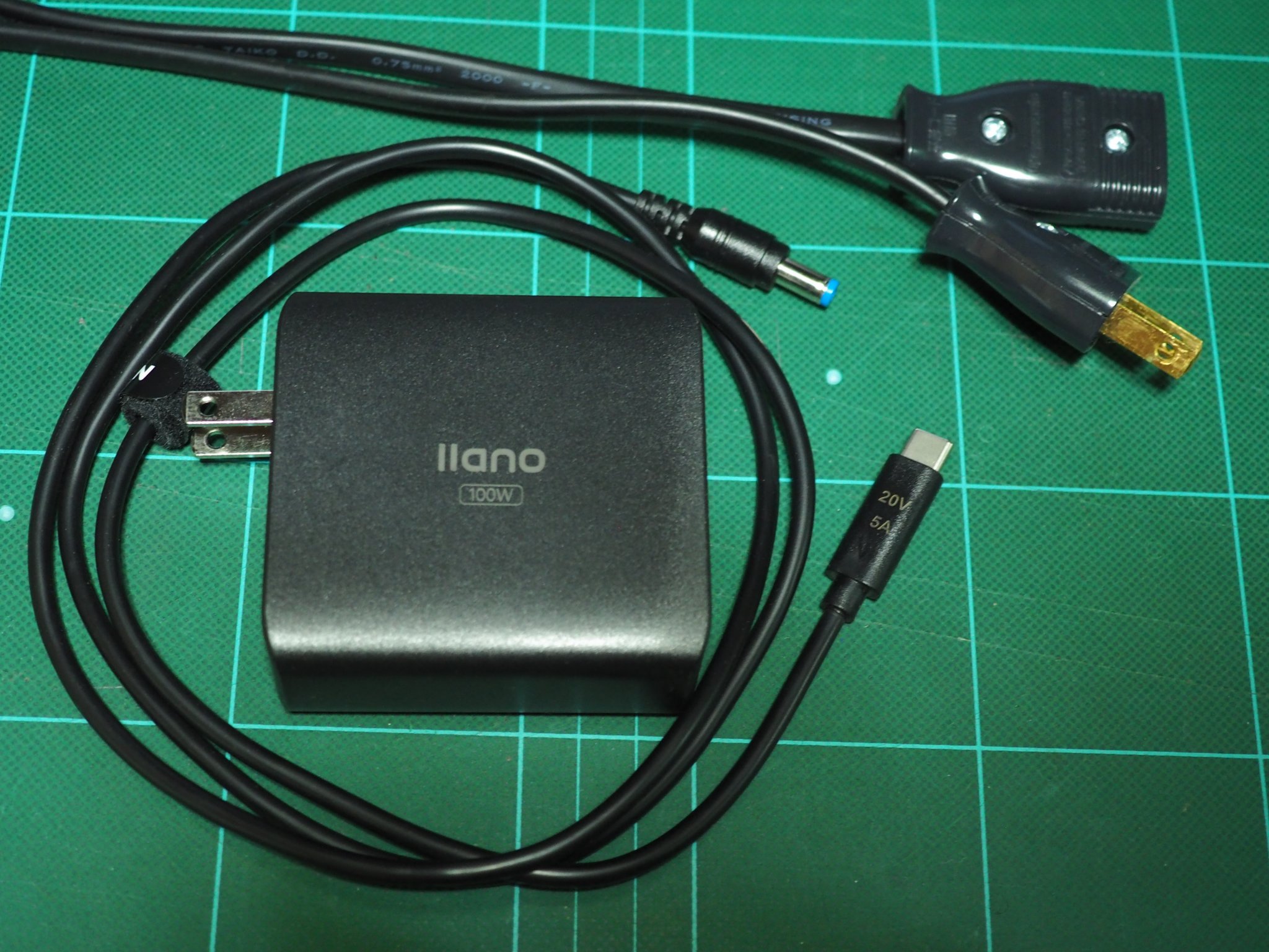

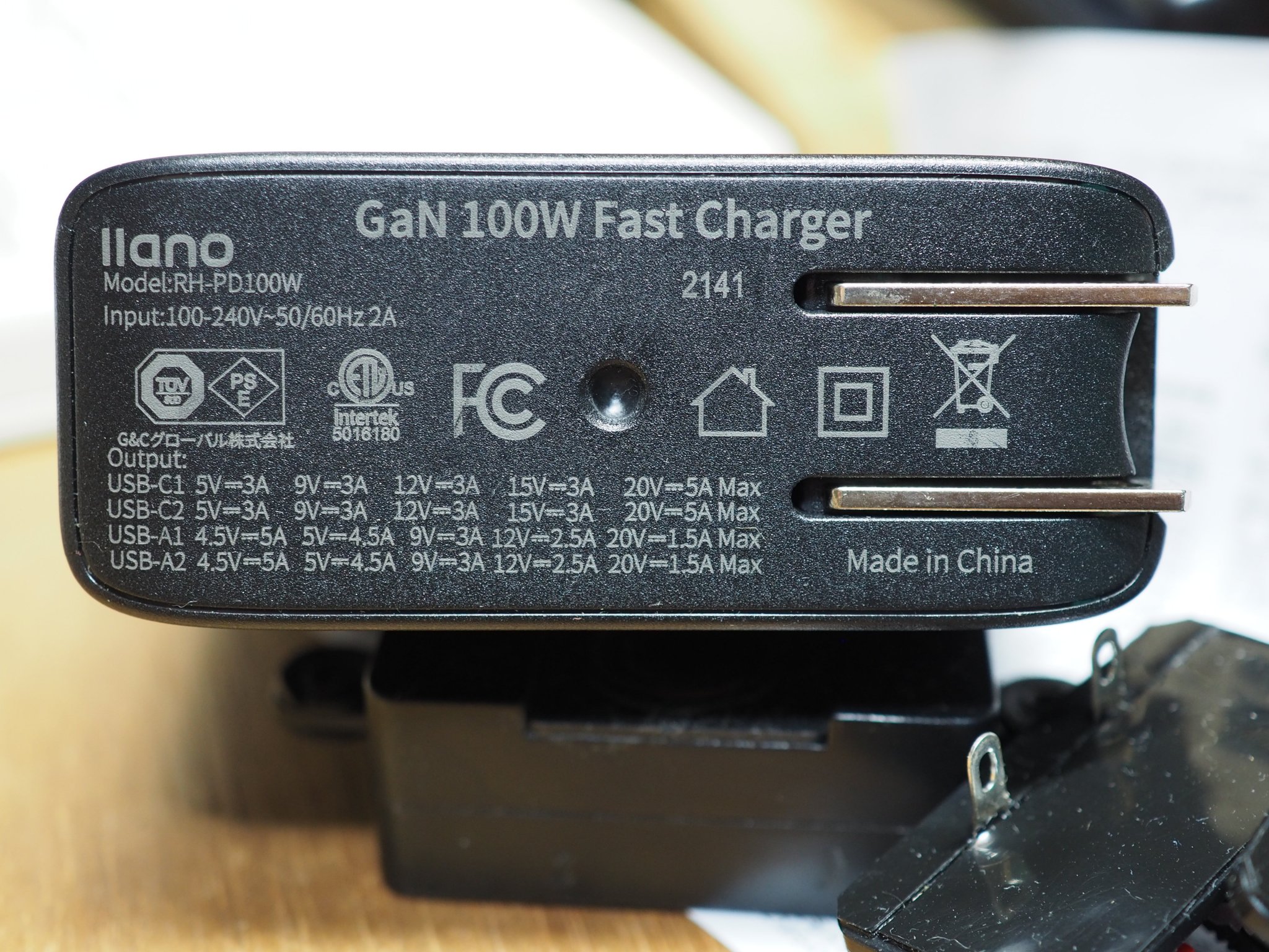

I think the power supply is more important than the power chip for a class-D amplifier.
Changing from a switching power supply or analog power supply to a GaN(gallium nitride) power supply can improve sound quality.
This time I used a 100W (20V, 5A) PD(power delivery) power supply.
I just found a "paper" of Texas Instrument about GaN semiconductors and yes, maybe they have some benefits over MosFET semiconductors in lower power demanding applications (chargers USB Type-C). On the other hand, using SMPS for over 35 years (professionally) I know that the design of the circuit dominates. To clarify more, when there is a load that has (large) step current demand NON periodically, but the current demand is "more frequent" than the alternative current of the mains (50Hz in Europe) then a humble linear power supply with big smoothing capacitors + schottky-diodes rectifier is superb BUT it is balky + the capacitors aren't cheap. For now , in resident, I'm using almost always C-L//R-C-L//R-C filters after a SMPS when I need low ripple, BUT I don't have the charger you have, in hands "for a test ride"😉 (I think the power supply is more important than the power chip for a class-D amplifier.
