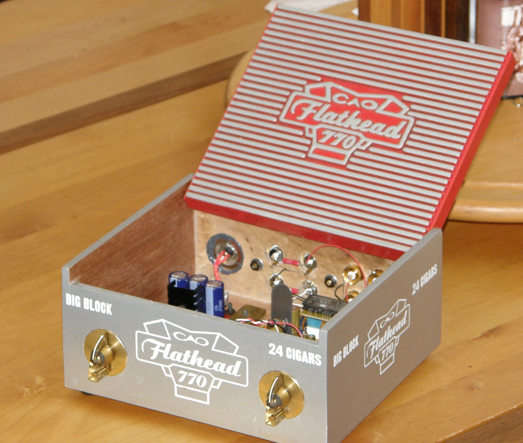

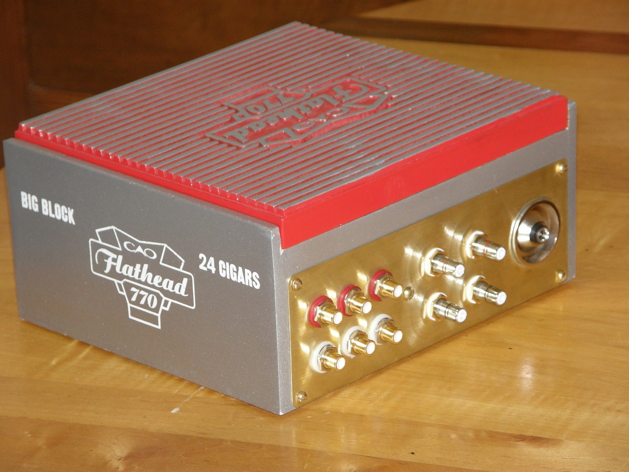

I could consider a trade if that works for anyone. I built a NuTube preamp that is for sale, and in this case would make a pretty clean swap.

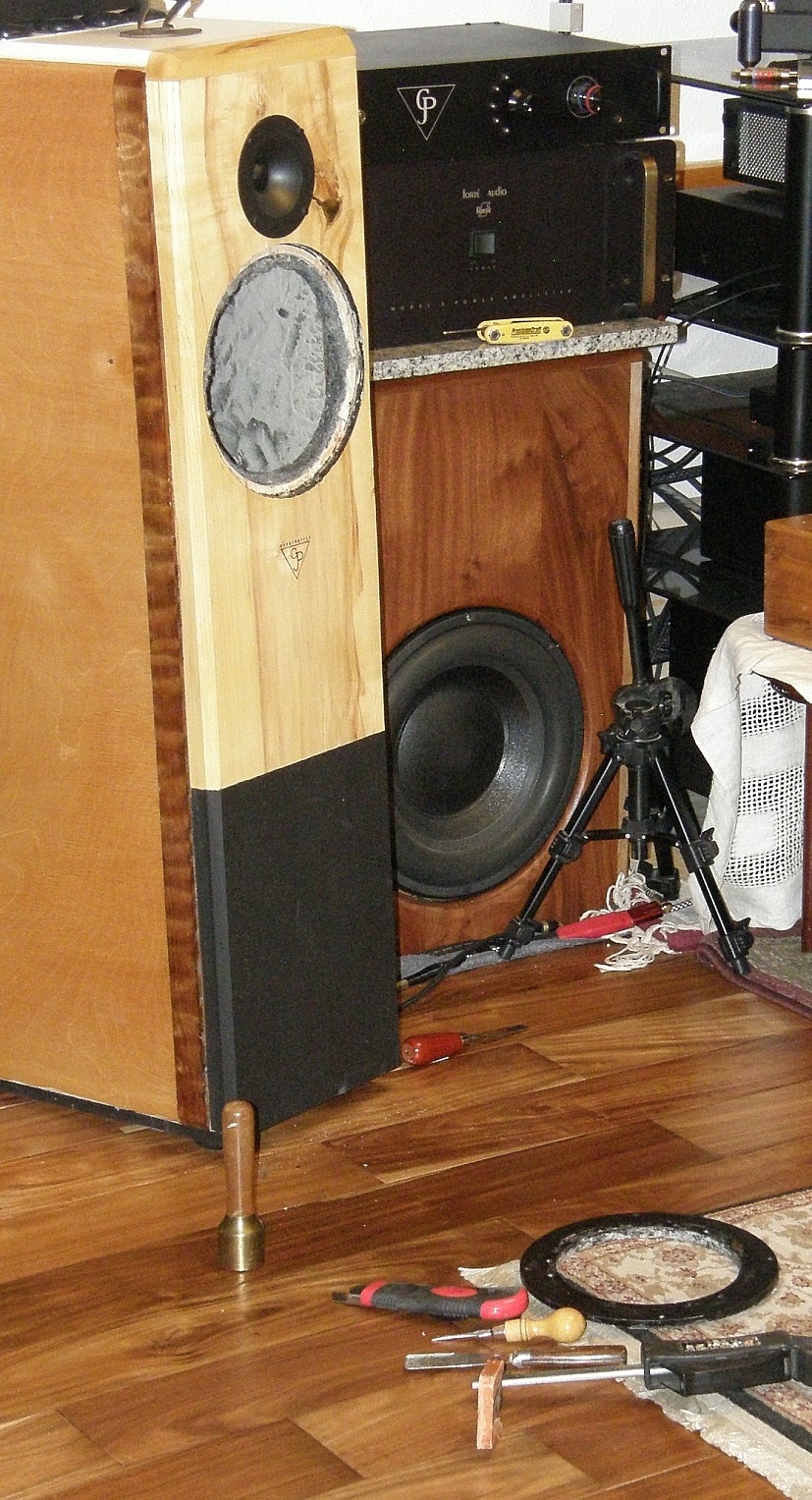

well, it shows that the drivers are in the states. New York so far, but it will be a week easy to make it to Wyoming. I am trying not to think about what it will take retrofit these drivers in the cabinets that are housing the Scan Speak drivers. Best way is to simply pull out the drivers and adapters, but you see when I do job like this, you can bet that the present adapters are really in there good and solid. Too bad there isn't such a thing as reliable, completely sealed bayonet type adapters for different drivers.
Ah, the Scan Speak drivers. There is a story behind those. In fact I have built for a customer two pairs of speakers using these drivers. They are 18WU/8741T-007. So I raved about the drivers so much that the customer gifted two of them to me! Now as far as that sounding great, the truth is that these drivers exaggerate the bass in the cabinets that I am using. I have tried a lot of stuff to reduce the bass without affecting the total sound, but no, it would be better to build proper cabinets for these drivers.
In the meantime, the Mark Audio drivers are on the way. I originally had the MA12P drivers in the cabinets and they did everything well except the bass! feast or famine folks. So, says I, let's try the 12PW in these cabinets. Yes, I get it. I am taking yet another chance. But don't worry. I have the plans for a cabinet from Planet10 Audio designed for the 12PW. I just want to hear these drivers in my existing cabinets first.
Yes, I must be careful, surgically remove the adapters if need be from the cabinets. I can get lucky only so many times. (that's what she said)

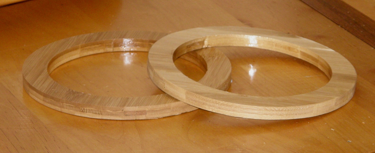

Today, I will try and make the new adapters for the drivers using bamboo. I bought two cutting boards at the pawn shop for $11 ea. Still heating up the shop for this endeavor.

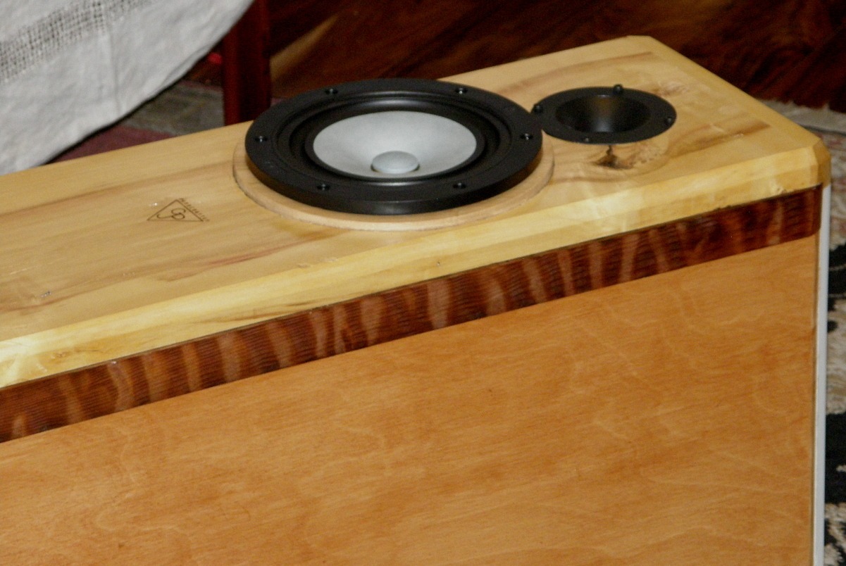

Well, it was a bit more than changing a light bulb, I tell ya. So now, I listen. If I think it is worth the effort, then I will take the adapters back out and finish them with the proper bevel and such.

I know that you are correct but it is really hard for me to do. But I must. Even at low volume, I am liking what I hear. Murpheys law crqacks me up though. Every little mistake was made while trying to get it all together. The scary news is that it is possible that I made some trouble in my poor little Iron Pre by hooking up the output from the DAC to the output of the Iron Pre. I am just going to forget for tonight. Too much drama.
Just listening to light classical music. I think that a speaker or entire system can be listened to at a lower volume and still have the needed sound to create a real experience. I am pleasantly surprised by this as it has been some time since I have heard a driver do this. I now remember what it is about the 12P drivers that I previously owned that caught my attention. A mid bass that isn't overdone, and a midrange that isn't thick. Later during the break in period, I will be listening to voice recordings and that is an acid test for FR drivers. Egads, some of them come out with slicing sibilance. You know it when you hear it and it is a deal breaker for me.
