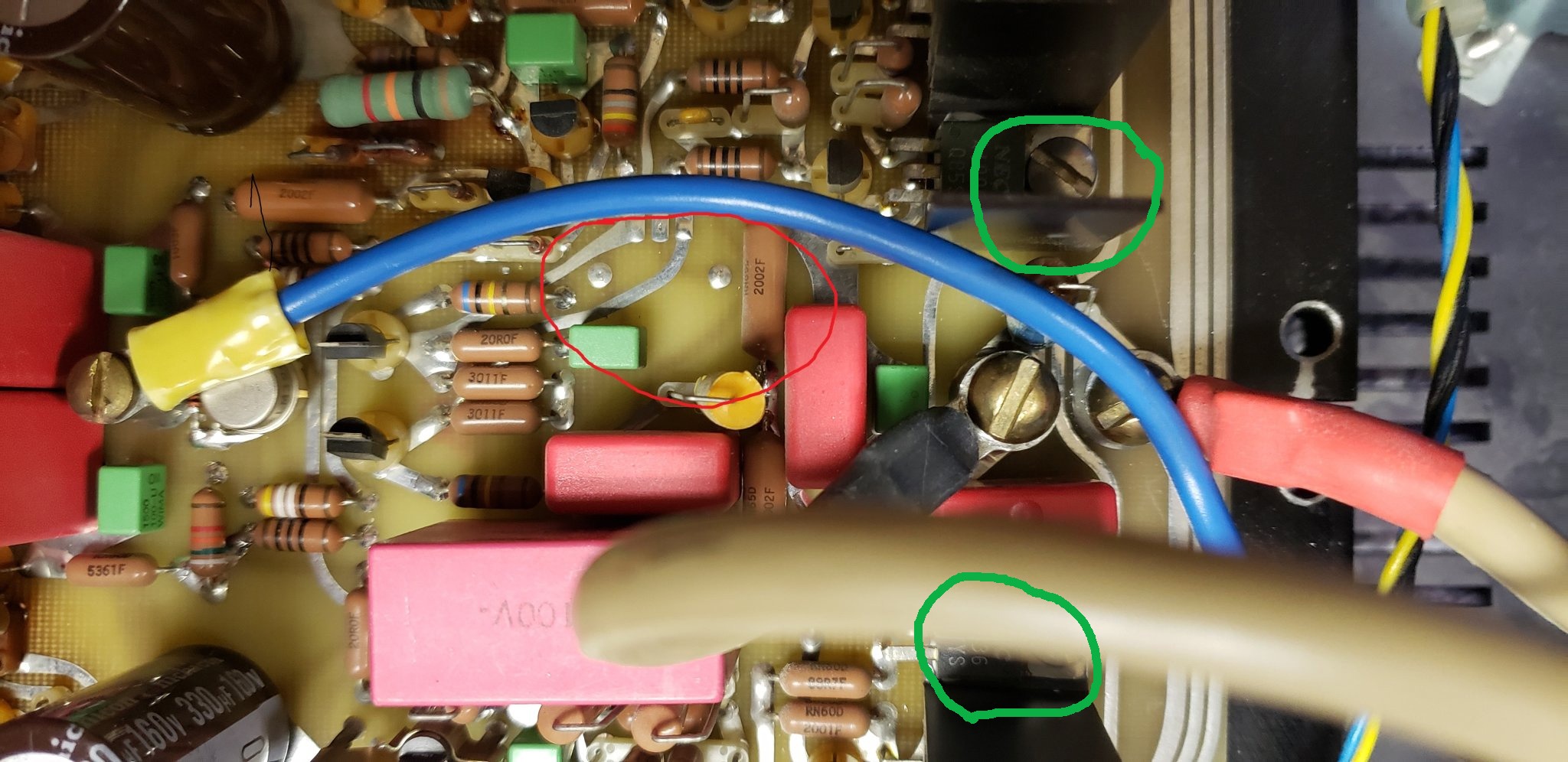

I disconnected power from the left channel VCC bridge and powered up full power. The soft start relay clicked and the right channel functions fine. So the problem is in the end stage of the left channel. With my proposed screw removal the output transistors will be powered but the bias related ones would not so I could see where the problem lies. If you think this is safe I would try it.

This is my data informed guess to the problem. I replaced seven of the output transistors. Since I could not find a closely matched MJ15024 I had to replace all of them. I have one good match '25 so just replaced the damaged one. When I turned the amp on using the bulb limiter I measured the emitter voltages on the '25s, and except for one which was a little higher than the rest (about .3mV), they seem balanced. That leaves the bias transistor (s) as the possible culprit.
Here they are

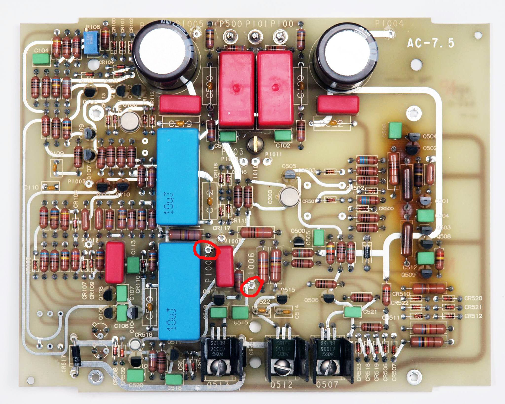

This is for a 23.5
But when you have a 23 these points are called WH.1 and WH.5
This is for a 23.5

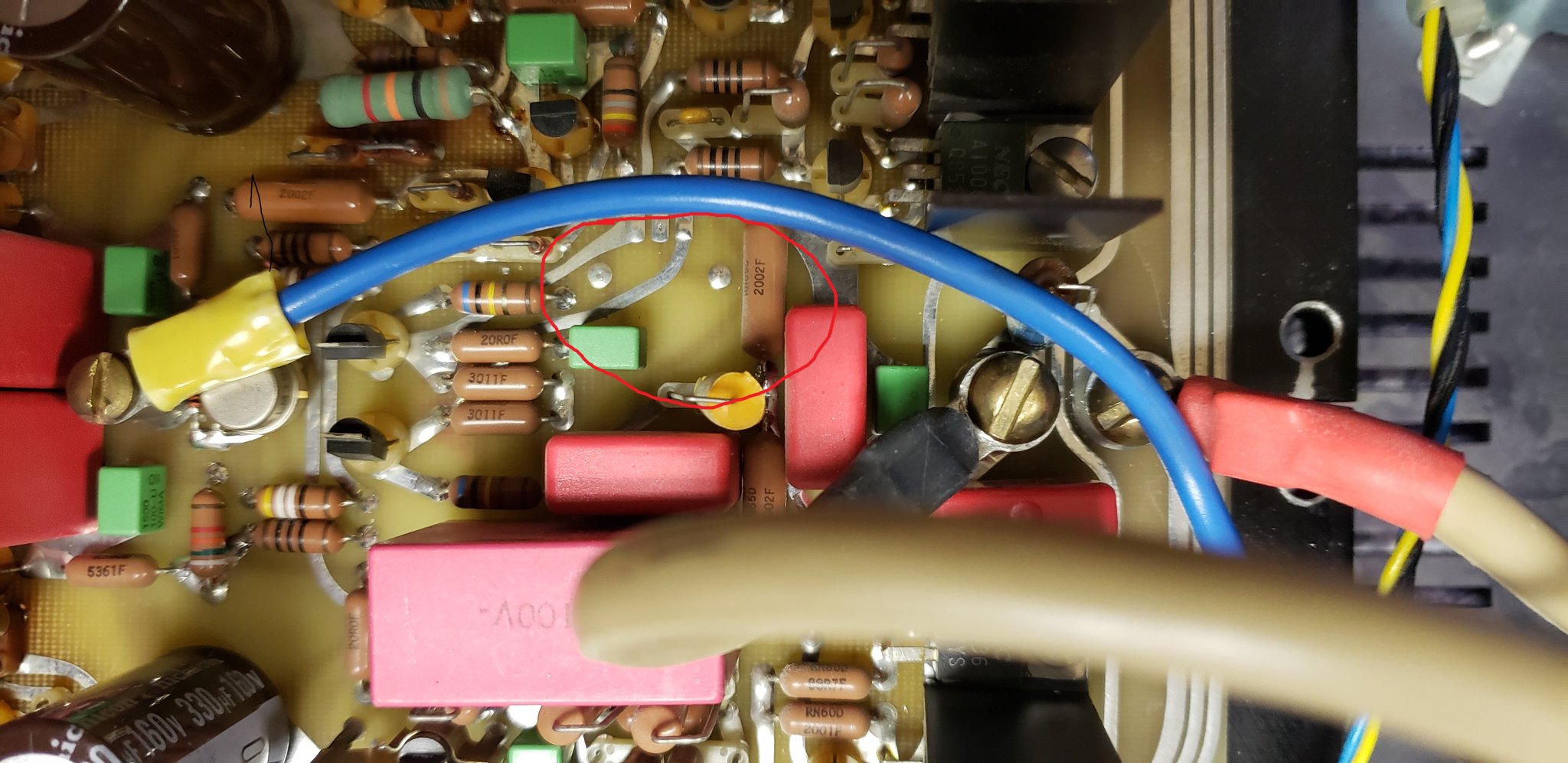

The 23 doesn't look quite the same but here are the two points I measured powering the amp through one 75W bulb.
value = 9.8mV
value = 9.8mV
Stop using the 75Watt bulb in the AC line, just have the two DC lines disconnected from the large rectifier, thereby interupting +/-VCC.
The Voltage amp should have it’s full VCC Reg of ca. +/- 85Volt.
Then measure between WH.1 and WH.5.
Hans
