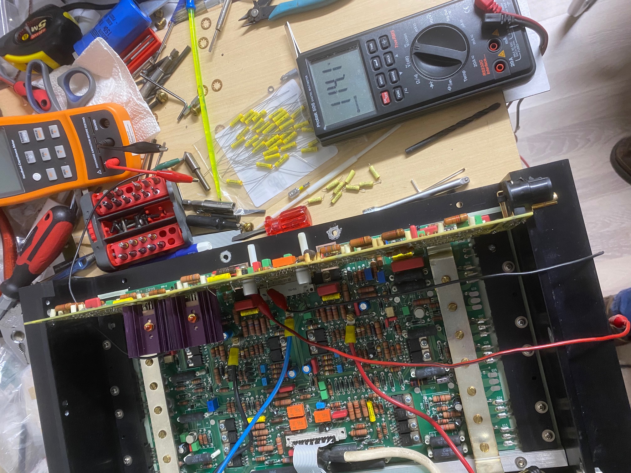

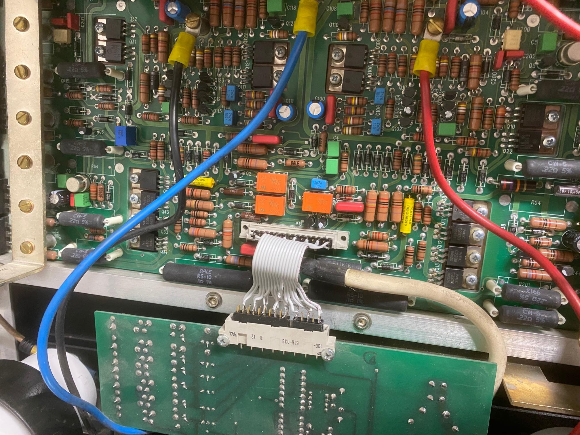

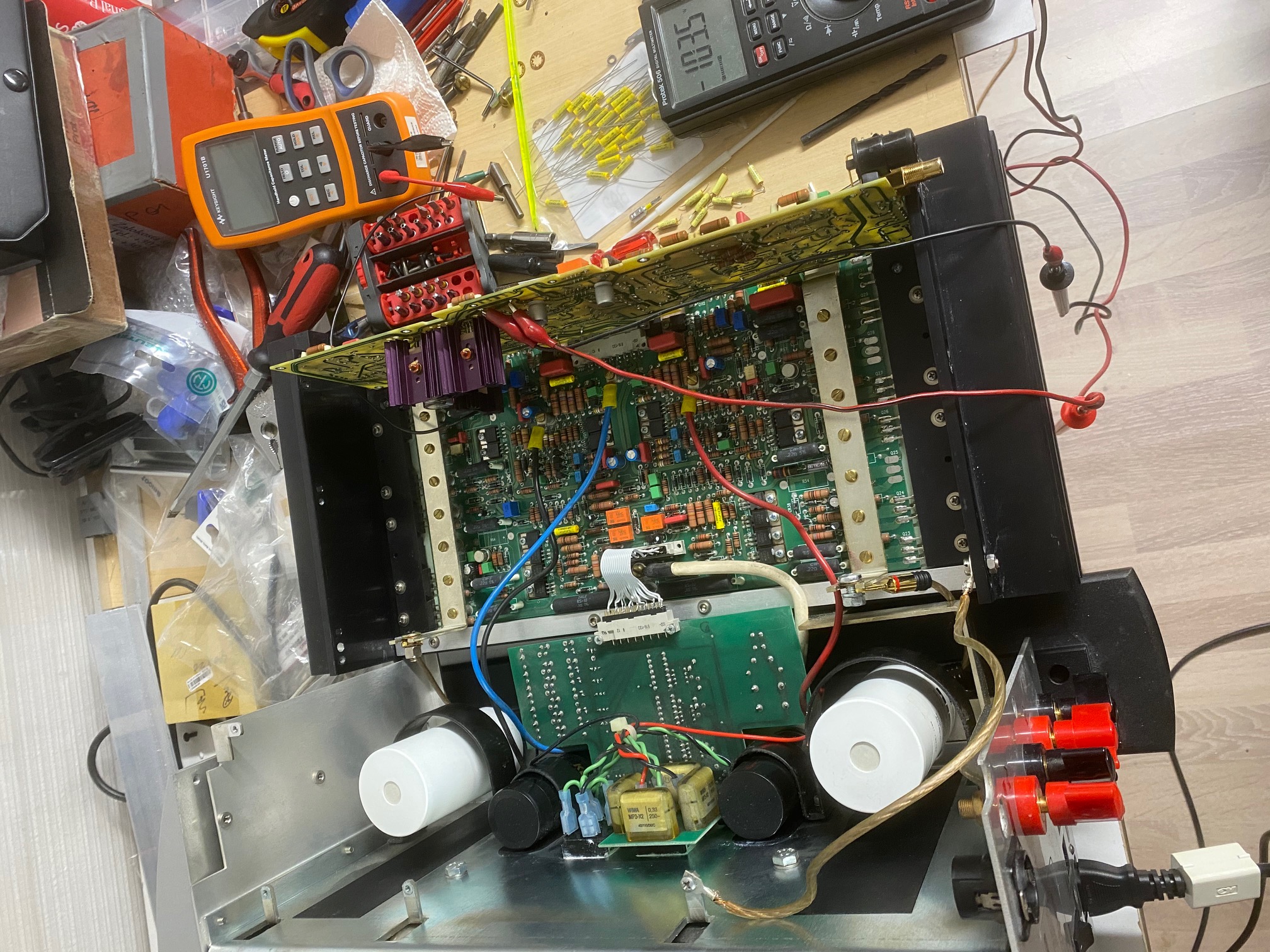

Just to explain few details:
-I have disassembled the faulty channel to be able to work better with. I constructed a short connection between VSMB and CG board (as you see in third photo).
- Don't give importance on the RIFA (10000uf/100V, main power supply) and KEMET (1800uf/200V) capacitors. I just had them in lab and used them to avoid damaging the new (and extremely expensive) CDE DCMCs caps.
The other channel is working correctly, although i have not performed any upgrade there yet.
Th.

Mooly: few photos of what i mean. if you need more or other infos, just let me know.
It is circuit diagrams rather than pictures that are needed 🙂

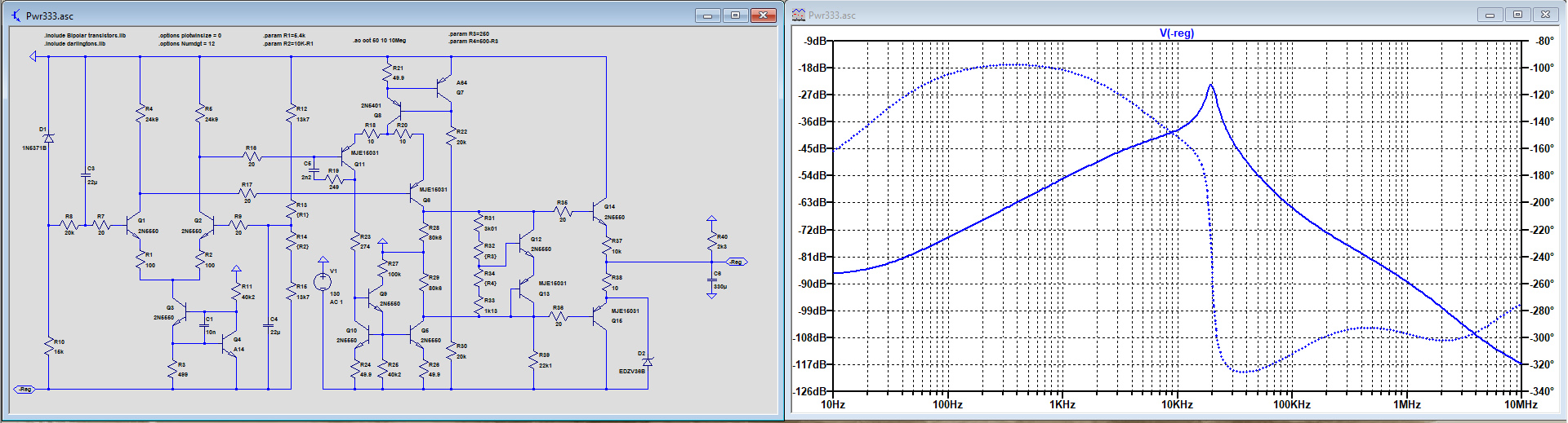

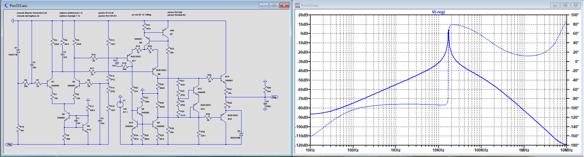

I've put your supply in LTSpice, hoping that you can use this.
In the first image below, I have shown the power supply rejection ratio, assuming that on your Amp board there is still a 330uF connected to Vreg.
Looking at the graph, I'm not really impressed by this PSRR.
When removing C113, it becomes already a lot better, see second image.
Anyhow, you can use the Sim file and compare all the voltages in your Amp.
Hans

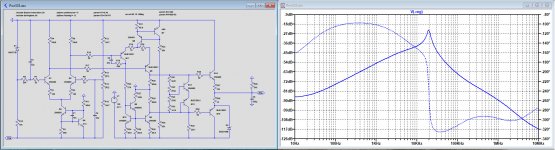

Hans
