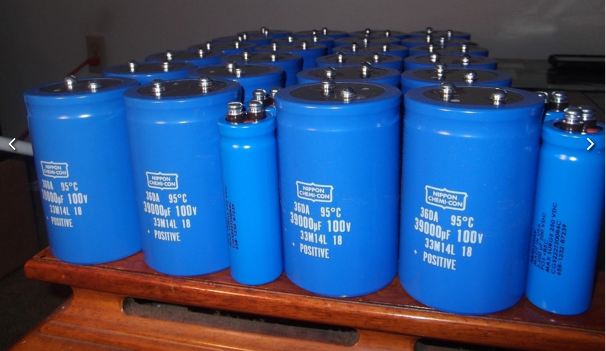

Now for your Mark Levinson No.33 I recommend just replace 24 PSU caps and regulator caps the reason the amp works fine now. It is similar to ML-33H. Here is the Picture of 33H that was very dull In sound. My customer in Europe.replaced the 8 power supply caps the original Red China made Philips with Nichicon caps amde in Japan and super high end worlds best Cornell Dubilier.

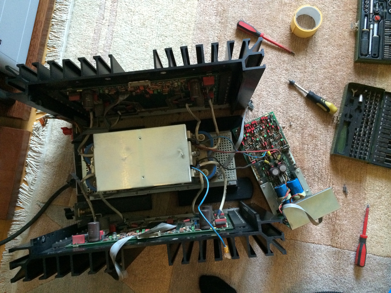

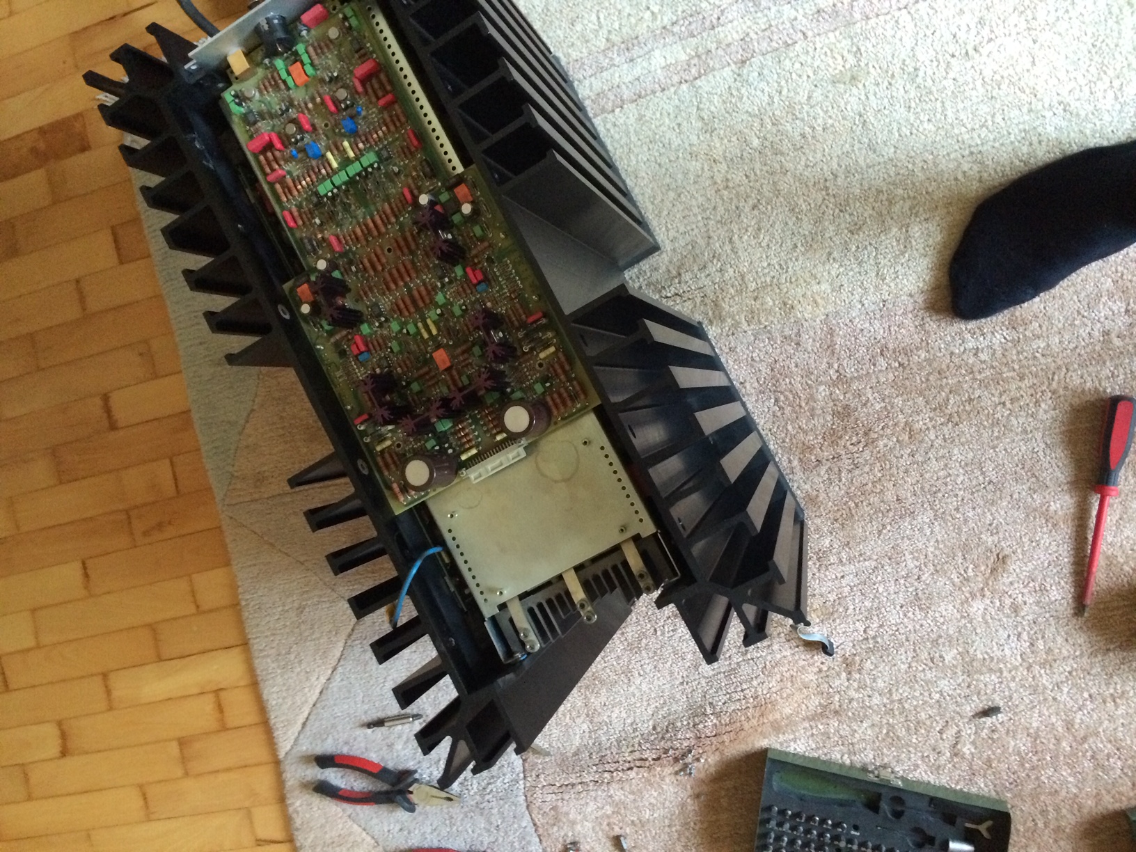

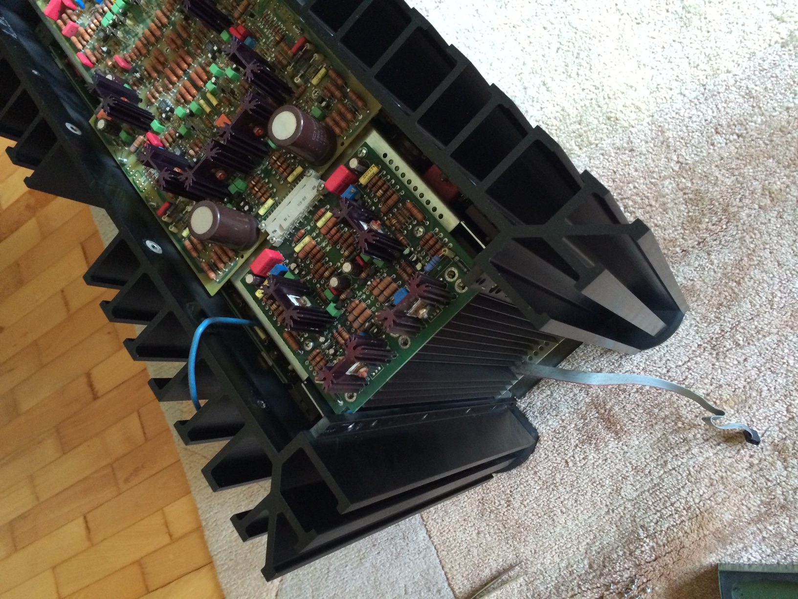

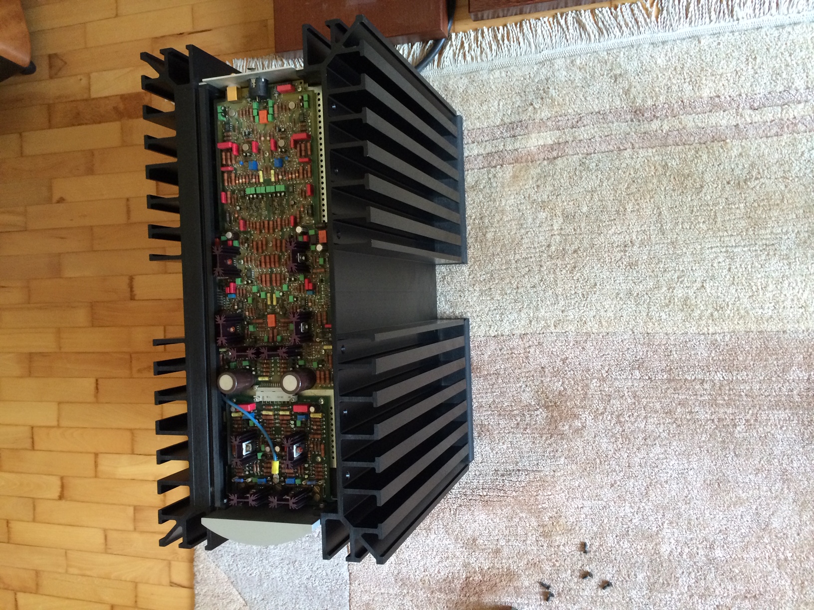

I'll post pics as I do it.
Do you have evidence that the capacitors in the board are not functioning well? Your amplifier starts up, there are no hisses or hums and it produces music without audiable distortion. This indicates the amp is stable and functions well, therefore the capacitors are doing their job. There are 30 year old caps which work fine. Have a read at the link below, a guy tests a 30 year old vintage pioneer amp and I quote ""It delivered 273.3 watts into 8 ohms and 338.0 watts into 4 ohms. It's a stereo receiver, but it totally blew away Denon's state-of-the-art flagship model in terms of power delivery!"
What i fear is that by replacing the capacitors you are trying to address a non-existant problem and may actually make things worse. A new capacitor brand may have different ESL and ESR from the originals, this could lead to instability so please think it over carefully.
Another reason not to change the caps is that currently you have a unmodified vintage audio set whose value will only increase in time, its potential re-sale and price value will grossly decline the moment you modify it.
How can 30-year-old receivers sound better than new ones? - CNET
Ur not the first one to say this.
I have revamped many amps , preamps it's always a jump in quality
I get the comment but I can't leave them and not make them new in spect again.
Do you have any measurements to say that there was a objective difference in quality after your modifications? If the original capacitors are working well, then by replacing them you wont be "make them new in spect again". Of course you will "hear" a difference after spending hours replacing 100's of capacitors, its likely psychological and your brain telling you it sounds better than any measurable difference.
