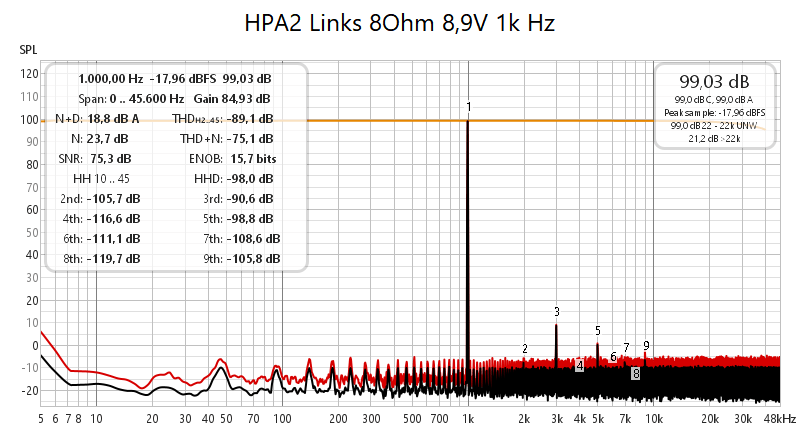

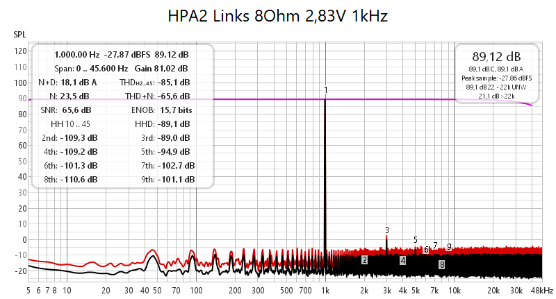

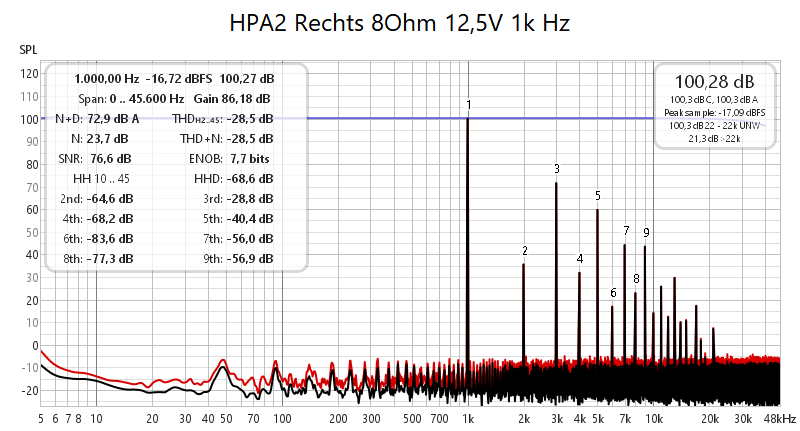

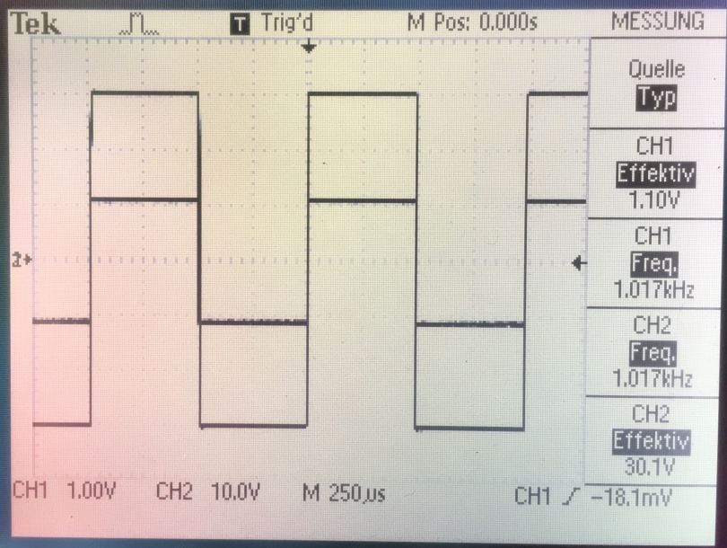

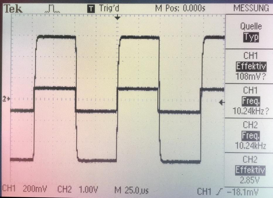

Hello everybody and Happy New Year 2024!

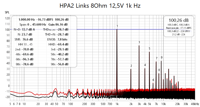

Using the free time while my Season's holidays I have tried to measure my HPA2 (see my earlier posts in this thread).
I started with a dummy load of 8Ohm (2x 4Ohm 100W resistors head sink mounted) and got some realy nice results for 2.8V (~1W) and 8.9V (~10W) ...but then I increased just a bit more (12.5V ~20W) and got substantial higher level of distortion (s. pictures Links=Left, Rechts=Right channel).
I was wondering if I simply overloaded the ADC (E1AC, high voltage input 43Vrms) but even with a voltage divider (10:1) I got the same picture.
Any idea what the root cause might be? Strange that both channels show exactly the same results...
Thank you for any help.
Michael

Hi huelskemper,
its a bit strange; have you checked the power supply caps if they have capacitance? It may be that big ripple on the plus/minus supply for the power stage is too big, therefore the distortion at mid levels.
good luck!
Dieter

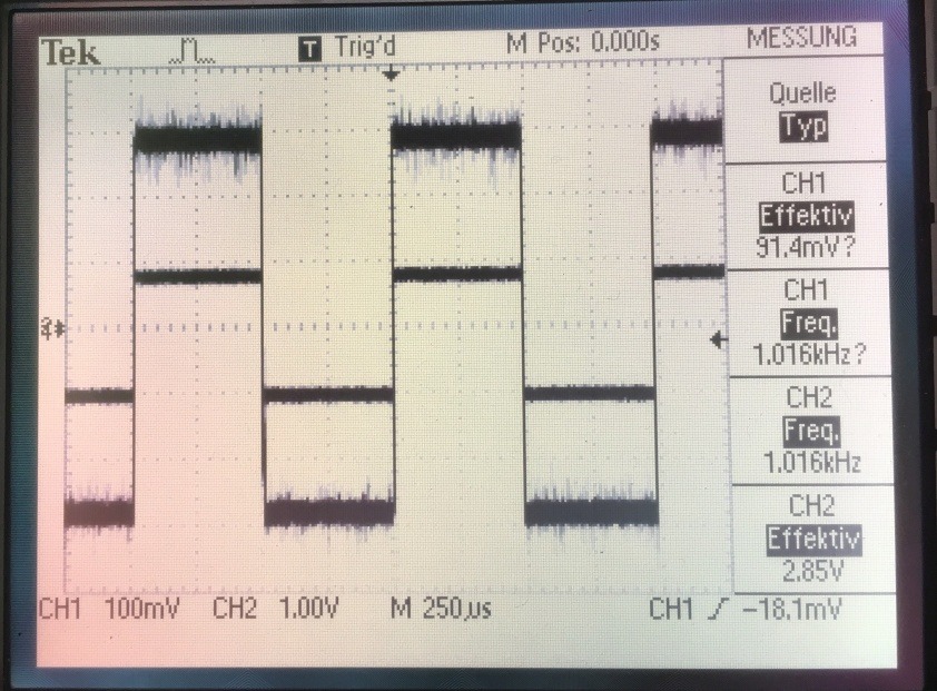

Hello Dieter,
thanks for your reply.
I have not measured anything in the amp yet but would expect to see 50Hz+harmonics if the filter caps were flat...stupid?

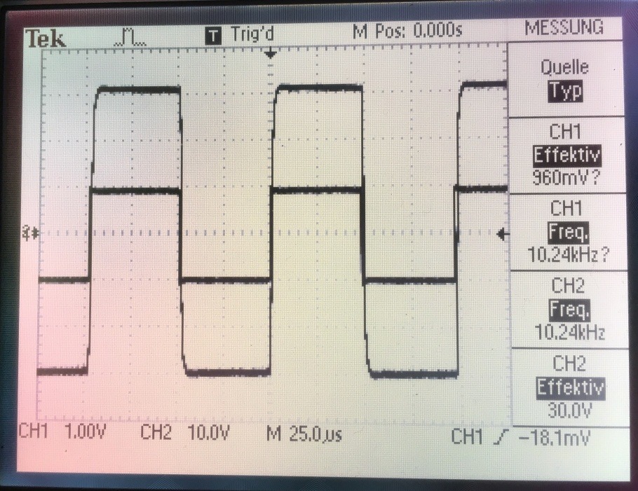

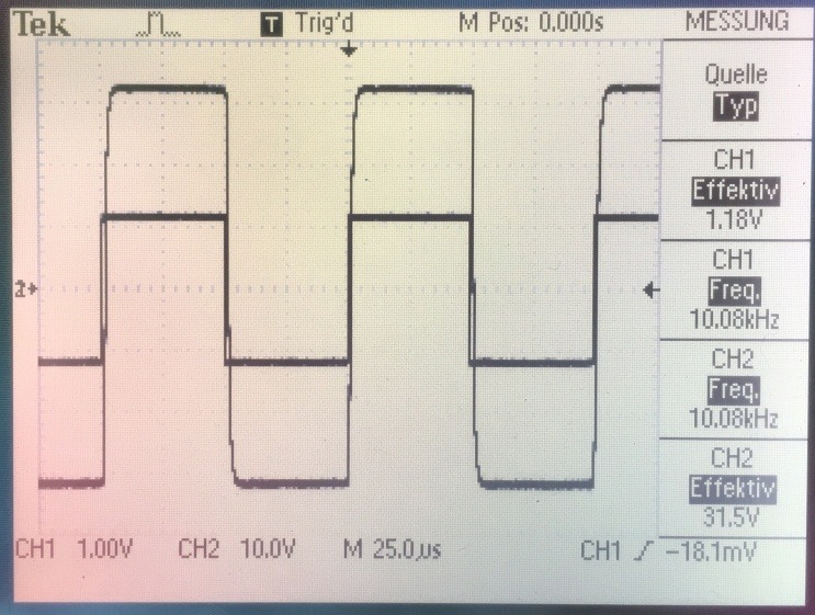

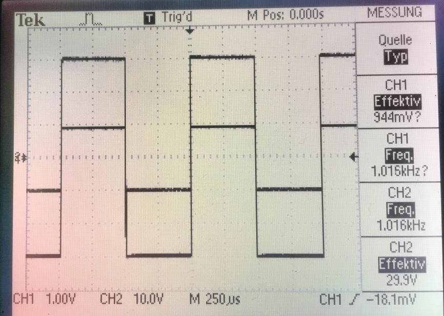

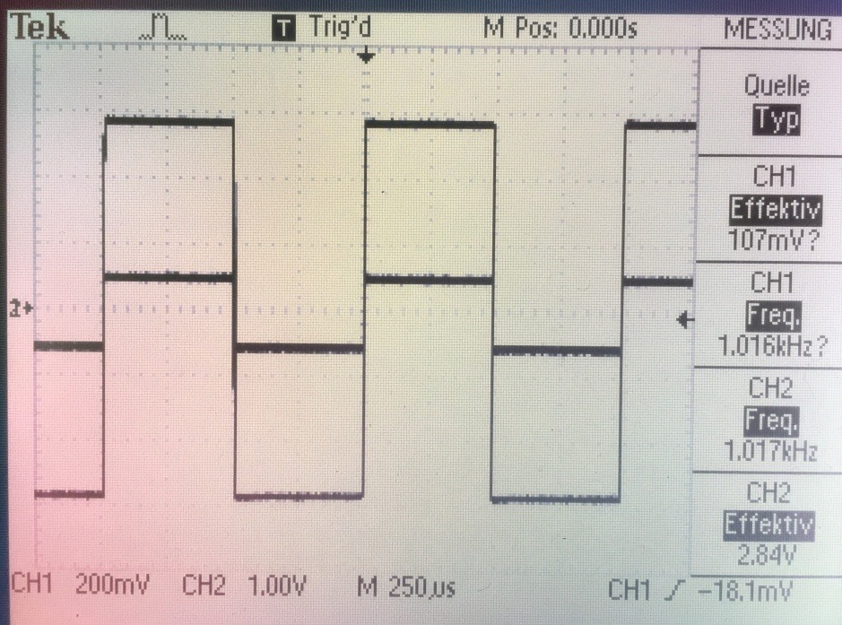

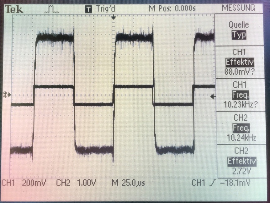

Yesterday I hooked up the amp to a signal generator and fed it with 1kHz and 10kHz square waves at approx 2.8V and 30V...looks really not bad (despite the higher noise level on the right channel for low input, I used the RCA input, normally only XLR).
Quite puzzled....
Best regards
Michael

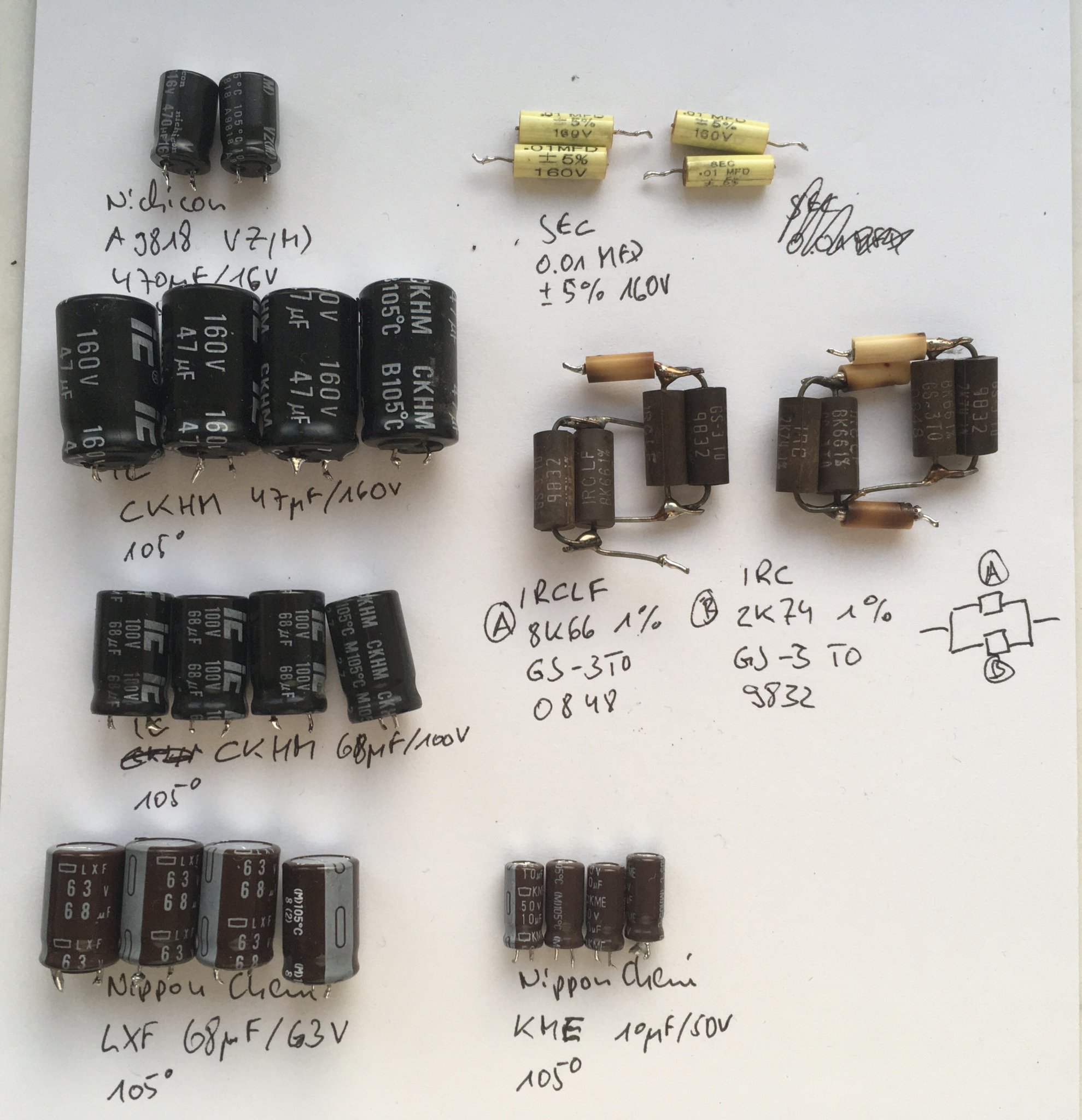

Hello Dieter,
sure.
On the picture you can find the parts I got in a plastic bag...but Mr. Krauspenhaar (Sun Audio) informed me that there have been some updates to the circuitry and he used "more modern components of better spec".
Below is from the invoice (translated):
Status:
Damaged PCB GND trace right channel input (...that was actually me hooking up a signal generator to the RCA input while keeping the XLR connected to the low-ohmic pre-amp 🙁 )
High frequency noise on regulated supply lines (both channels)
Several damaged or failed capacitors
Several damaged power resistors
Repair actions:
Repair input right channel
Replacement all electrolytic capacitors in both audio channels
Replacement potentially failing film capacitors in both audio channels
Replacement damaged power resistors in both audio channels
Update circuitry
Adjustment regulated supply voltages pos./neg.
Adjustment bias currents left/right
Quality control (measurements and listening)
He also mentioned that the decoupling foam between the heat sinks and the housings have eroded (changed from froam to tar like consistency). Therefore housing and heat sinks have been cleaned and new foam applied.
Full service was around 800EUR (incl. 19% VAT).
Best regards
Michael

Hi Michael,
thank you for the detailed info; all the electrolytic caps look fine for me - not bloated or similar. Have you checked the capacitance of some of them?
I learned also that Sun Audio is no longer the German representant of ML.
Any more info about "some updates to the circuitry"
best regards
Dieter

Hello Dieter,
you are right: the HPA2 was operating w/o problems. So no need for repair...but recommended maintenance after more than 20 years of operation.
Sun Audio has been for a log time German ML representative (and for all other Madrigal brands) but Harman stopped collaboration when they centralized their distribution and service network (2018/19?). The positive effect: They know the classical ML (and Proceed) stuff, have all the service information, still a lot os components and are open now to also provice support for products not imported by them (my HPA2 was sold in Sweden).
The "circuit updates" have been recommended by Madrigal while the product (market) lifetime. Unfortunately no details known to me...I also do not know which components have been changed because of these updates and which were critical with respect to potential failure.
I measured all components:
Best regards
Michael
- 10nF film caps (yellow) seem to be ok
- 47uF 160V seem to be ok
- 68uF 63V seem to be ok
- 68uF 100V: 2 measure in the nF range, 2 show 4-5% loss --> NOK
- 470uF 16V seem to be ok
- 10uF 50V capacity seems to be ok but 4-5% loss --> NOK
- Resistors 2k74 || 8k66 (2k08) measure all slightly higher (2k11) but show signs of thermal stress (white plastic pin sleeves show black tops)
Best regards
Michael
