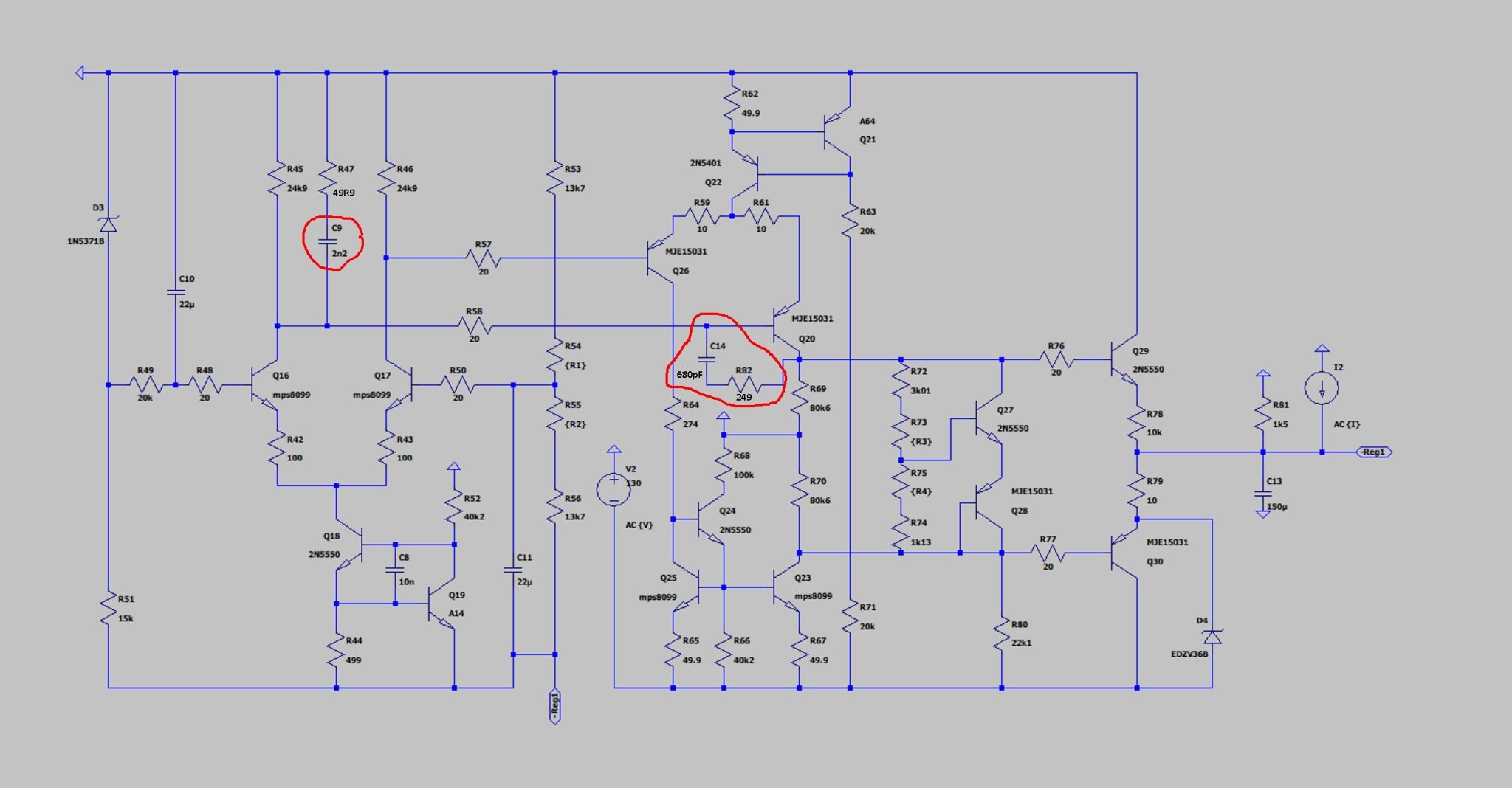

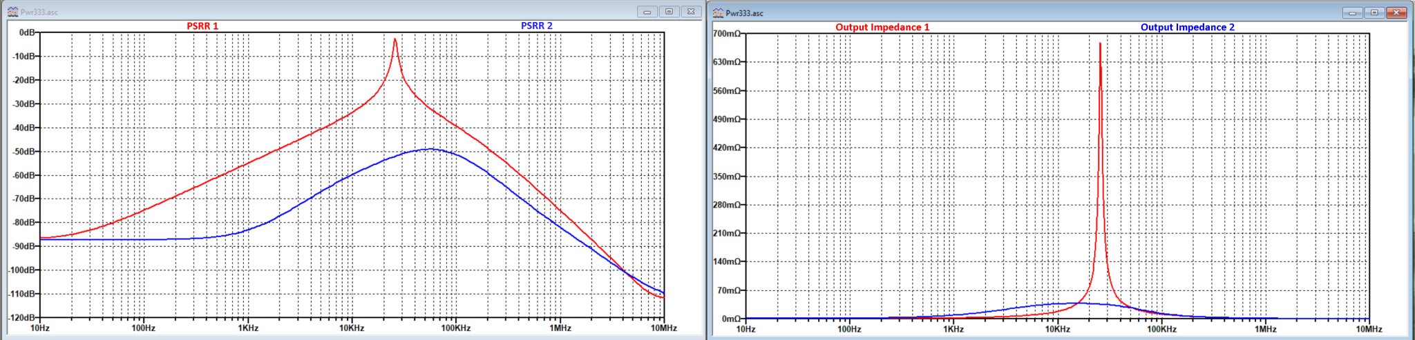

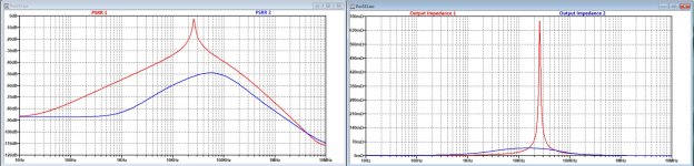

You´re a lucky guy with your 33H.
There is one thing you could improve and that´s the power supply.
ML always had a bit of a problem in designing proper stabilized power supplies, the 33H is no exception.
To improve some on that, they chose the complex way of generating a clean 60Hz power supply to feed the voltage stabilizer.
With some simple changes, both the power supply rejection ratio and the output impedance can be improved, see attachment from red to blue.
Whether this has any effect on sound perception, I've no idea.
Hans

It could be that this helps to get a warmer sound, because the power supply has the tendency to slightly oscillate at 20kHz.
Hans

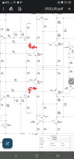

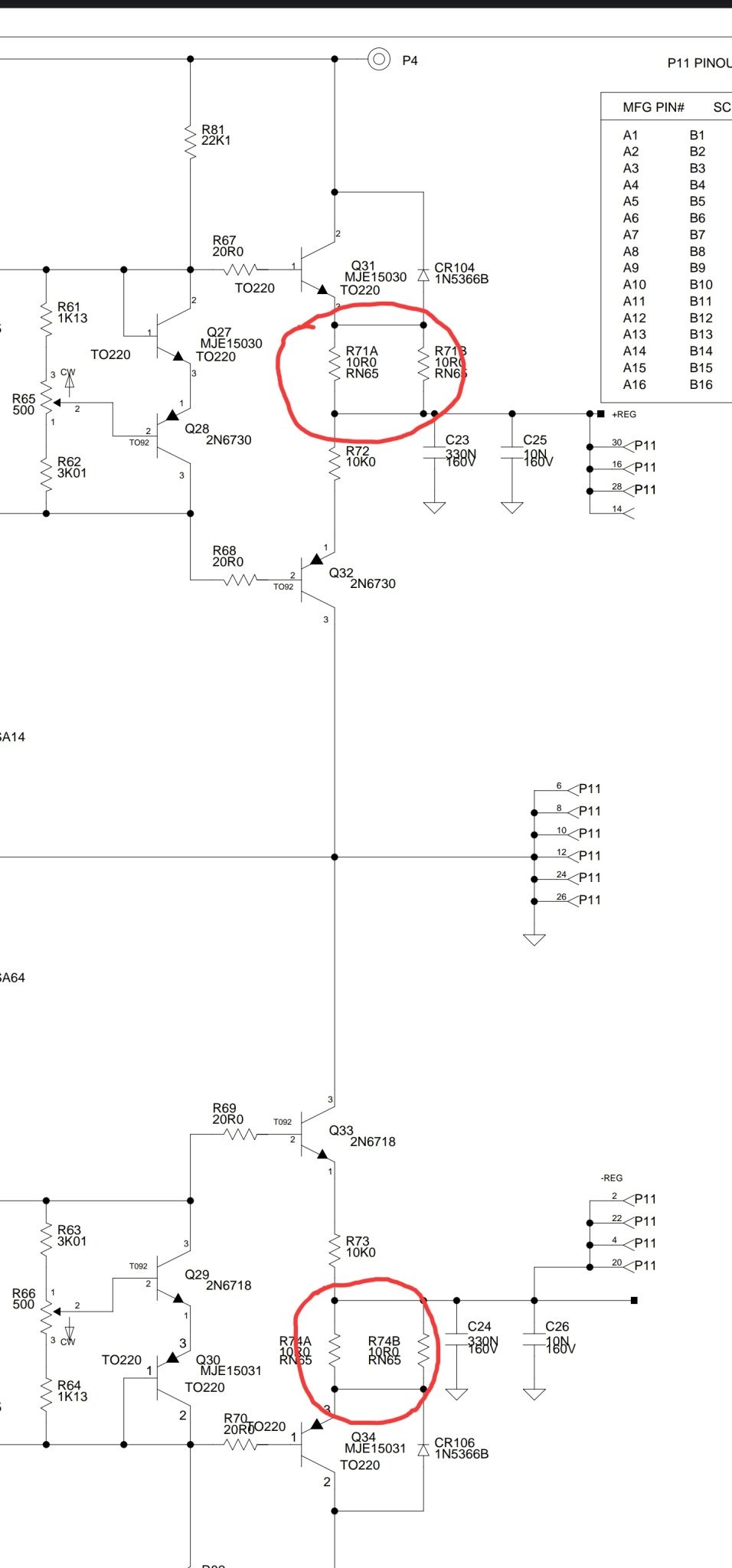

Sorry Hans
But I forgot to mention
There are few revisions of the voltage regulation board
Mine has instead of those 4 resistors RN65 10R
Mine has 4 resistors of metal oxide 20R each
How does those values influence the schematic that you have send ?
You are right, I overlooked this, but this was already included in my sim, a 10R (20//20) resistor instead of 5R (10//10), see the circuit diagrams I sent you.
So what you have is O.K.
Hans
Hans

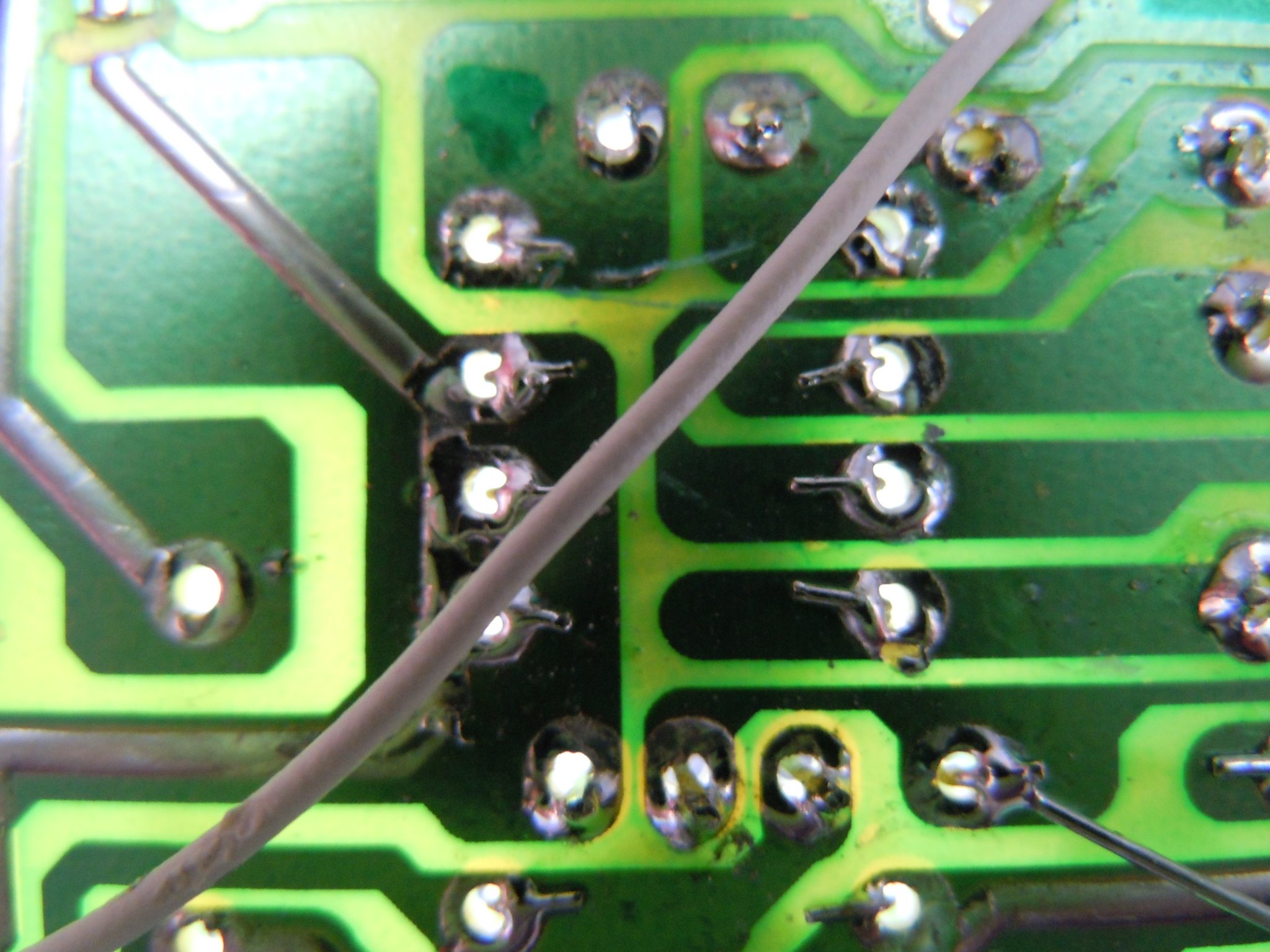

Assuming that an audiophile would not connect his devices with solder, and thus would not tolerate much solder inside his chosen devices, a suggestion: De-solder the entire device and re-solder it. Please solder in such a way - it is about the attention of signal, of current - that you can look through the holes of the board afterwards. But there are more hints, but I don't have to list them ;-)
THIS is THE basis for clean, dynamic, musical sound;-)

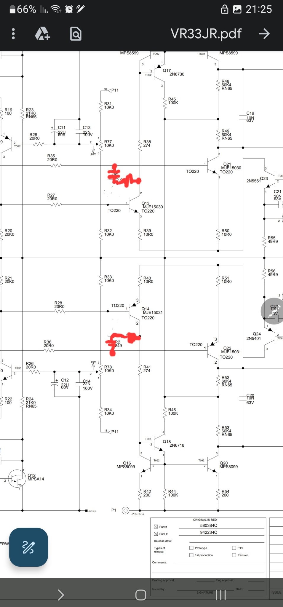

The biggest difference is that Q32 and Q33 are conducting much more current and that R71 and R73 are 2.2 R instead of the 10R (former 5R) that you have.Thank you Hans
Do you see any difference by simulation of the number 33 regulation ??
Parts of the values are different
I know from the ML No.26 ( more than 30 years old but with exactly the same topology) that the current through Q32 and Q33 should either be below 0.5mA or above 10mA.
But I’ll give it a try.
Do you happen to have some info on the pot’s adjustment settings ?
The other difference is that R81 and R82 are replaced by 1.4mA current sources, but I think the effect will be marginal.
Today I won’t be able to do the simulations, but tomorrow I’ll have the time.
Hans

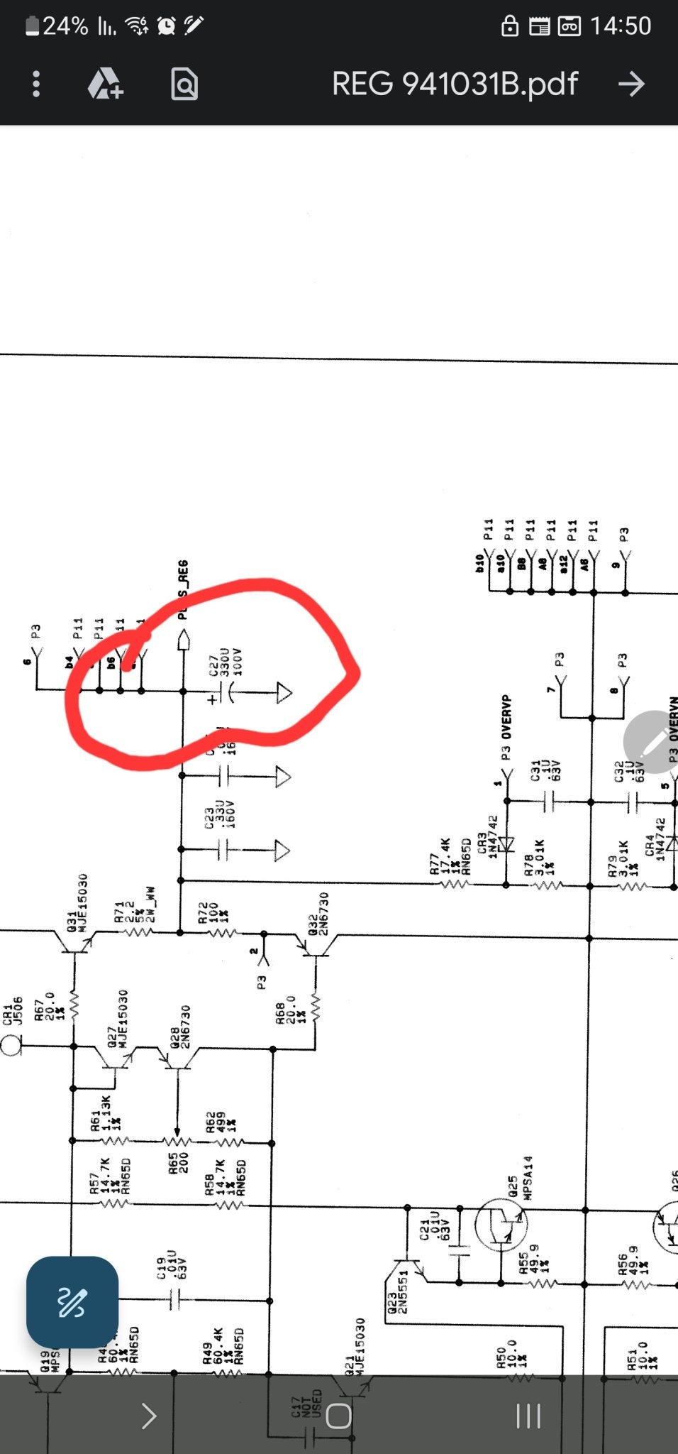

You have the same 330uF, but it is located at a different spot.There is another difference between those 33 and 33H regulators
As you can see at the end of the regulator the 33 uses 330uf
Just look at my sim and see that it was included.
Hans

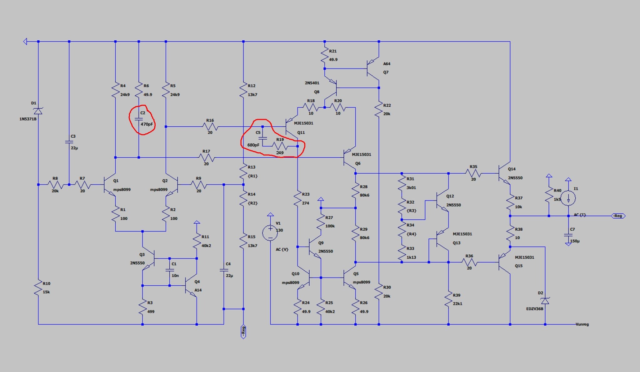

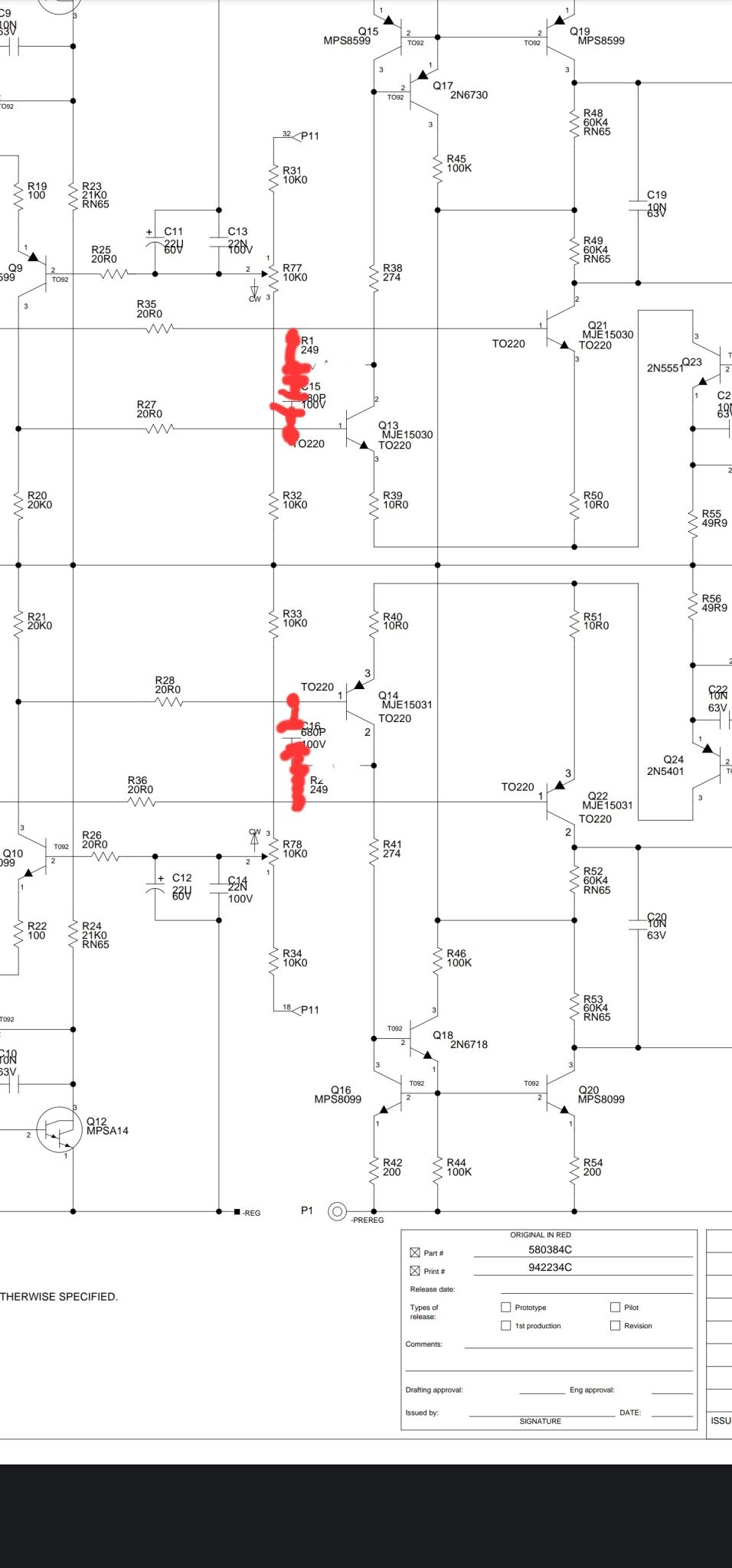

I found some time to compare both.
The 350uF instead of the 150uF at the regulators output adds little to the characteristics, after all it's a regulated power supply.
The changed resistor values at the output do not improve things either with the voltages that the 33H is generating.
One correction to the sims I sent you, these where for wrong supply voltages, after having corrected them for min 61V in and 57,5V out, I noticed that the 470pF caps that I advised to change for 2n2 caps can stay at 470pF.
So the only changes to be made are for the 680pF + 249R to be moved from Q13/Q14 to Q21/Q22.
Hans
