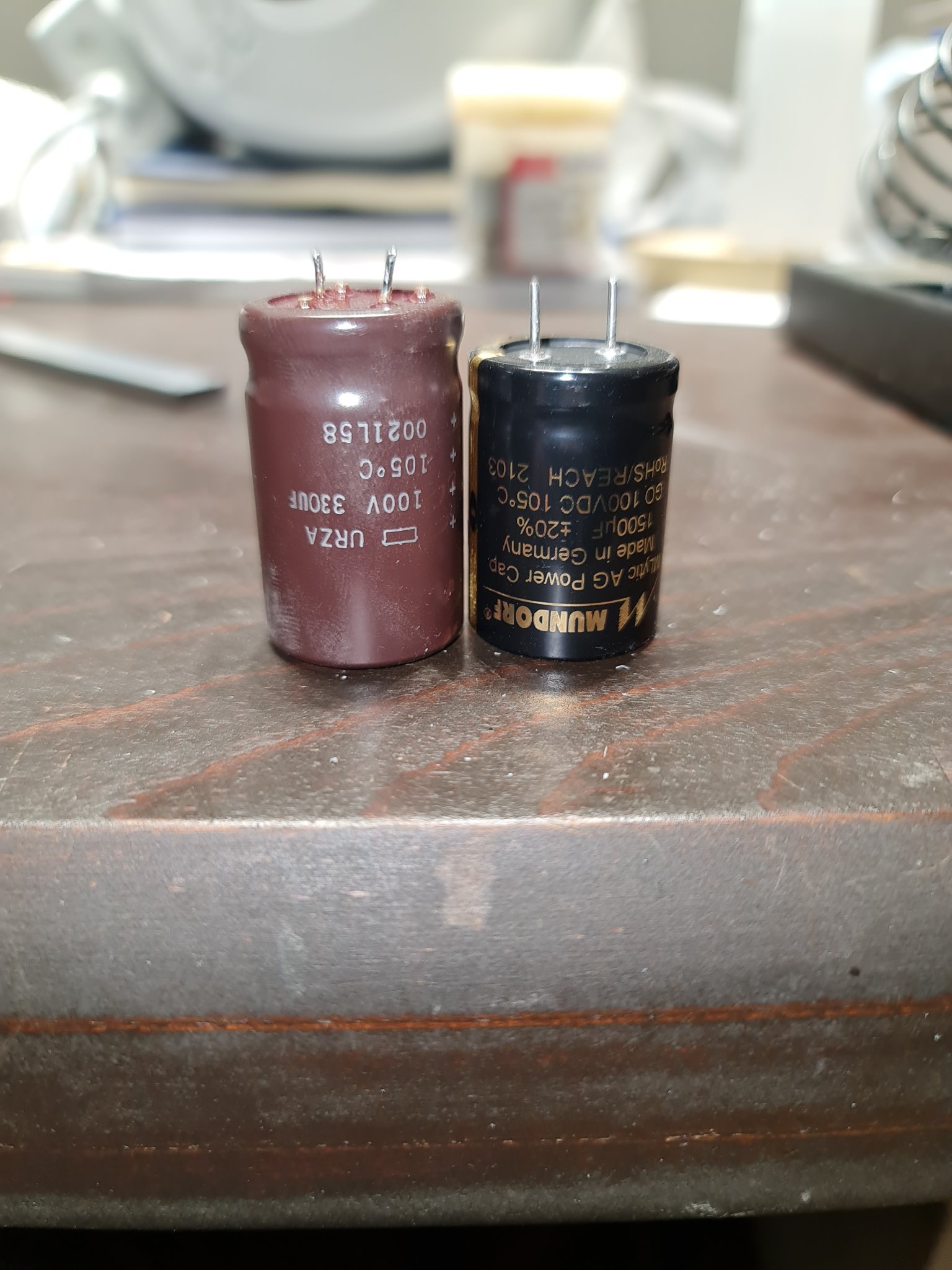

HERE IS THE ML-33H OVERHAUL USING WORLDS BEST PARTS SINCE HARMAN NOT ORDERING ANY NEW PARTS FOR POWER SUPPLY CAPS.
8 FILTER CAPS MADE BY CORNELL DUBILIER 60000uF 75V
4 REGULATOR CAPS 1900uF 250V
24 ULTRA LOW ESR HIGH RIPPLE 330uF 100V MADE BY CDE 301R331U100JE2 WORLDS MOST EXPENSIVE RADIAL CAPS.$19 EACH. (INCREASING TO 1500uF NOT RECOMMENDED.
36 CAPS ARE YOUR POWER SUPPLY.
ALL PARTS ARE CORNELL DUBILIER AND FEW UNITED CHEMICON ALL MADE IN USA NO CHINA PARTS. ALSO 6 NEW SURGE RESISTORS.
AFTER ALL THESE PARTS 33H WILL SOUND THE BEST LIKE NEW SINCE THE PWER SUPPLY CAPS IS OVER 30 YEARS OLD.
THESE PARTS WERE USED IN (3) ML-33H MONO BLOCKS.

I'm glad for you that you got everything that you need for the levinsons
We see things totaly different
Cornell dubilier is a good capacitor but my epcos has better specs mainly ESR which is the most important value of a capacitor
If you would bought my capacitors.. you would got free points that are critical to improve is those old beasts
Further more increase the capacity in a specific points helps a lot by its effortless ability of this amp.
Montana
These parts were used for my customers.
Anyway did you replace the big filter caps 60000uF 75V and regulator caps? EPCOS DONT MAKE THOSE BIG CAPS. You think Mark Levinson use a 1500uF EPCOS?
ONLY WAY TO FIND WHICH ONE SOUNDS BETTER WE HAVE TO DO A TEST MY CUSTOMERS LEVISON VERSUS YOUR ML 33H.
