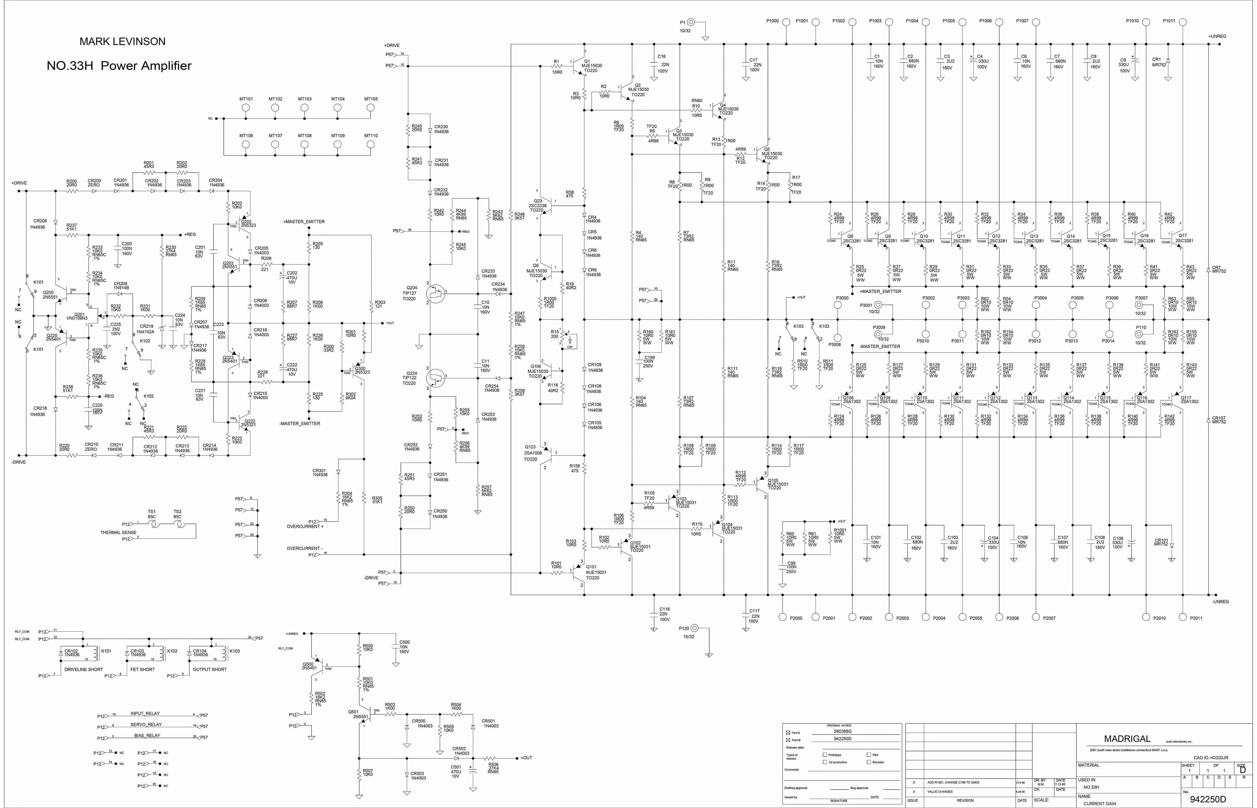

Yes Hans, I just found them on the Voltage Gain Board (I was not looking there). 3 per channel. I am just not sure if it makes sense to replace them - can they be the culprit?
A pop when a relay pulls in could be a difference between DC voltages on the two sides of the contact. I'd look at that first, instead of changing the relay. Use Pamona grabbers to hold on to some component leads so you don't mess the reading up with probe slips. DVM is fine for this check. In general don't use two hands at all when probing the amp with the power on. Especially one with 100 v rails. Any voltage over 25 from one hand to the other can stop your heart. (Sometimes)
Can't help much more without a link to the schematic diagram.
K3 is controlled by "Rel Con" which is not on this page. K3 applies rail power to the driver transistors Q33 & Q44 when pulled in.
K1 grounds the input going to U2 both sides. Coil not shown.
K2 shorts a timing capacitor to feedback of U1 when pulled in. Coil not shown.
I suspect relay control is a power up silence circuit, possibly at this price point also a AC off silence circuit. Rel Con is probably a timer somewhere.

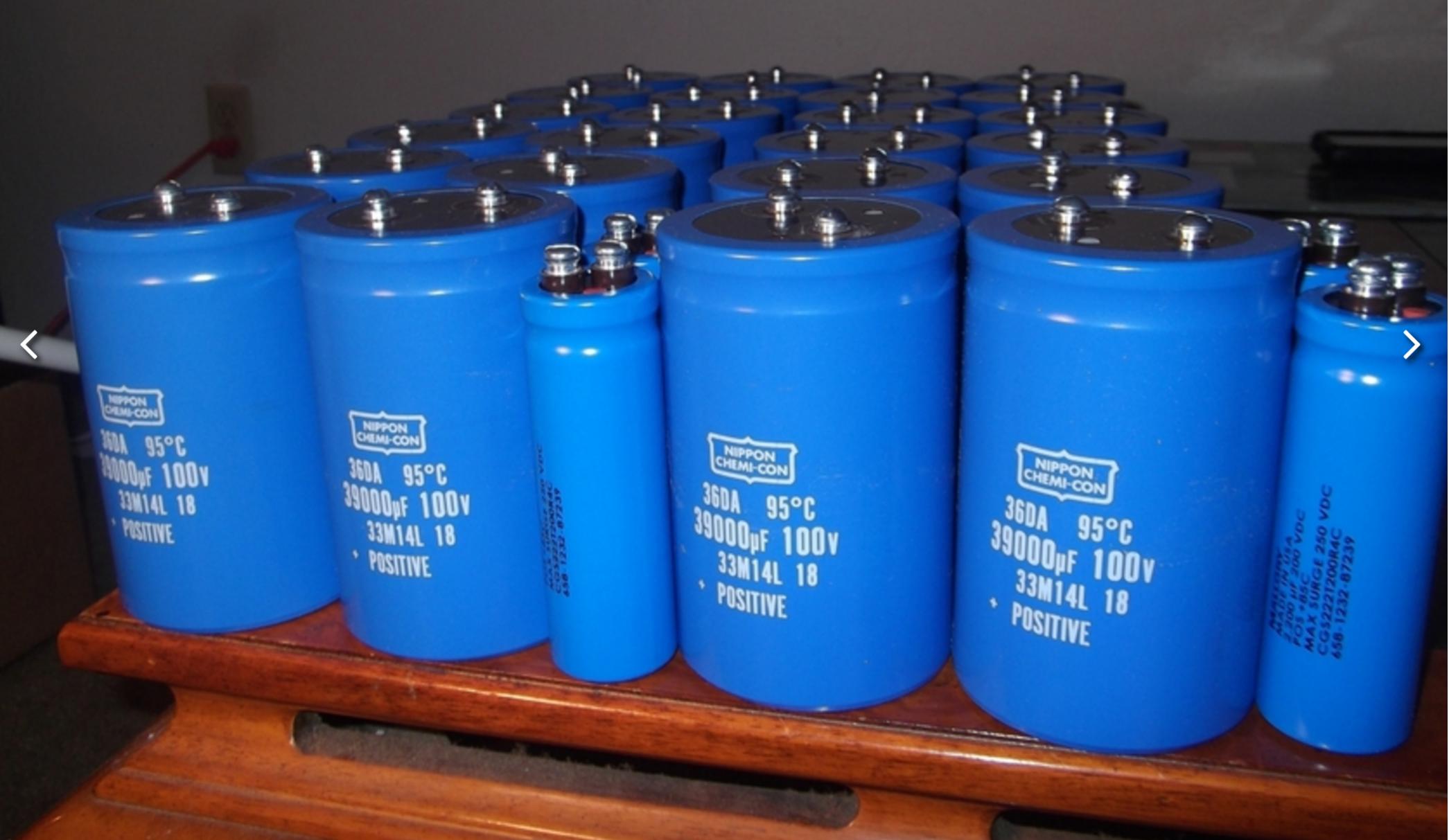

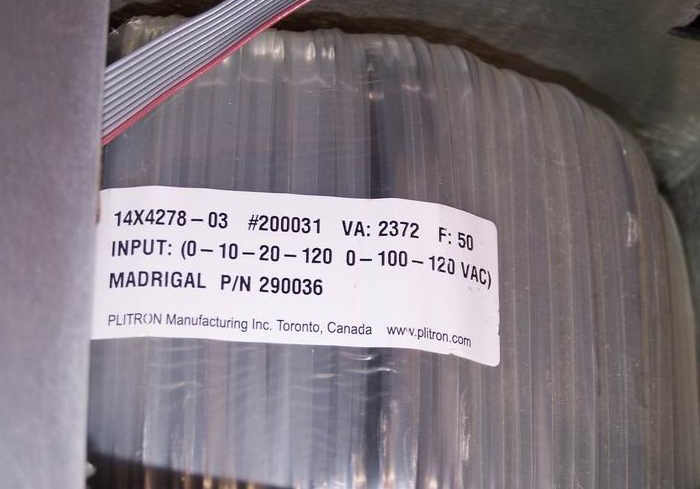

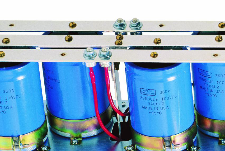

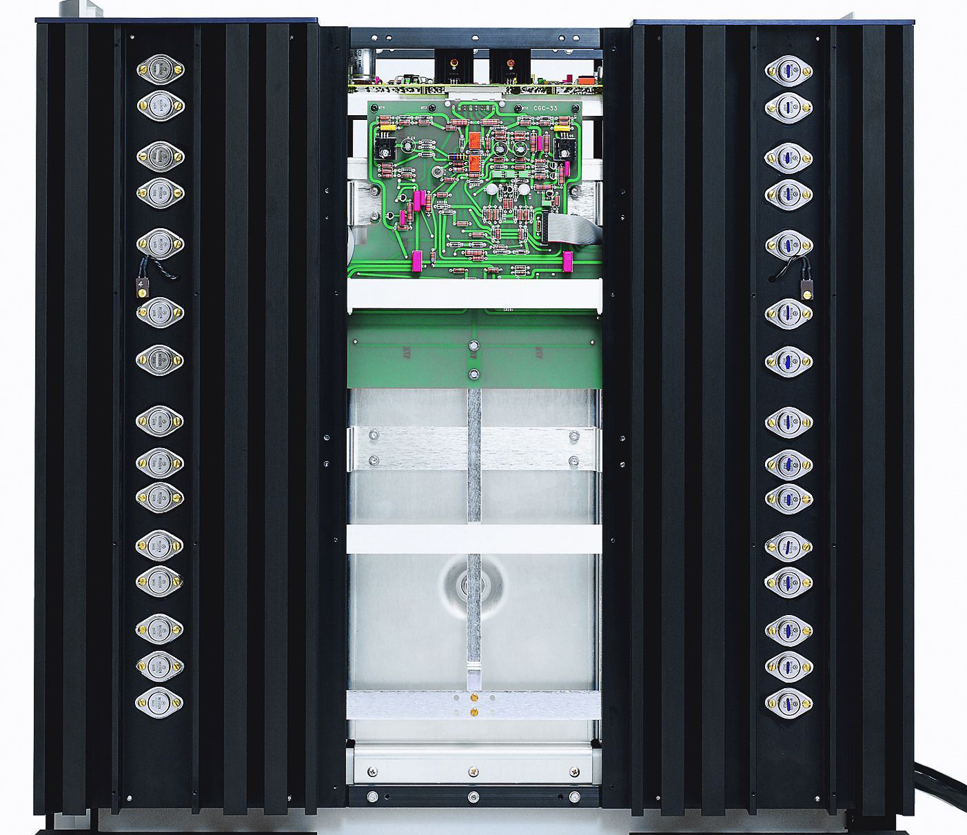

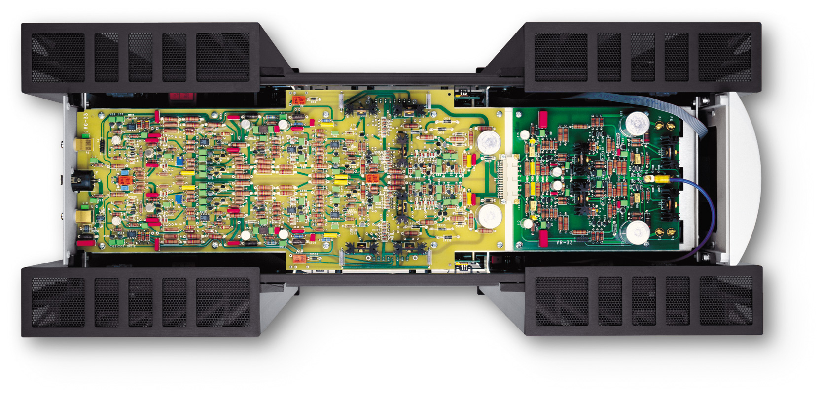

The working voltage of mark Levinson no.336 current gain board seems to be + - 110V. The working voltage of mark Levinson no.436 current gain board seems to be + - 118V, which is higher than that of No.33 and NO.33H.

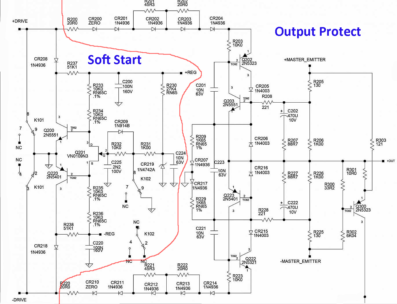

This 33 output section is practically just a bigger ML No 2x.x with exactly the same soft start and output protection, see image taken from the 33.
The only thing that is added are three relays that come into action when DC is detected on the output or in case of overheating.
The ML No 2x.x numbers shut off their mains supply instead.
Also the soft limiting of the signal, the bias setting and everything else is the same as in the older ML 2x.x amps, amazing.
