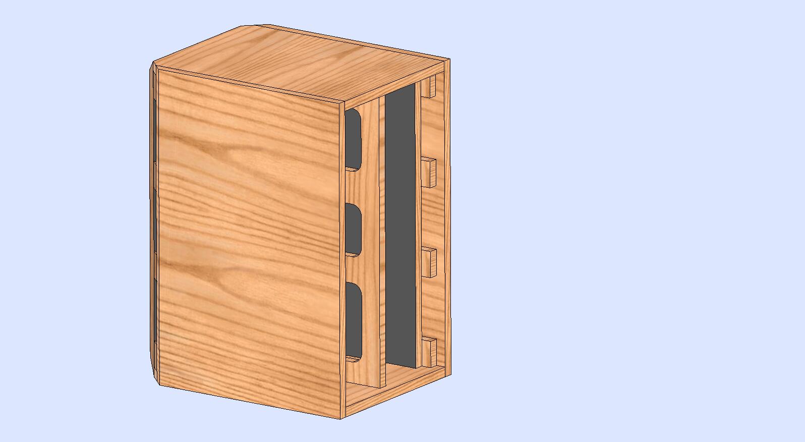

And an old snap-shot of the cad file for the same box:
Jeff's photo and sketch show it pretty well
It was 3 pair that one session. I hope this photo shows how the port divider strips extend to the back panel, as well as shows the cleat for insetting of back panel. Top panel was applied last in this build.

I'm hoping to put a Pluvia 7 in a milli-sized cabinet. I see the underlying 240x143x149 inner dimensions and I can adapt that for my particle board (something like 16.5mm thick). I see the 12mm gap between the shelf and the back wall and the 12mm high vent spacers, but I wonder about the port tuning.
mMarKel70 has two 47mm wide vents (25mm center fill + 12mm side fills), mMarKen6 has the same. mFonken has two 64mm wide vents (15mm center fill). The sketch in this thread for mMarKenP7 looks like it has much narrower vents, though.
If the P7 is very close to the EL70, should I stick with the same vent widths as mMarKel70? Or has the milli-sized P7 design been tweaked some other way?

Officially the details are part of the paid planset, but for the details (and a 47mm centre vent spacer) the mMar-Kel70 is the same. The difference comes about due to the evolution of the miniOnken tuning (for the really small boxes).
Do note that for your placement, sealed could well be a better match to your room gain (i am making an assumption based on your particle board reference). The vented box might well have a bump at the bottom — which you may like. You can always push the vented box closer to sealed by putting open cel foam in the vents if that is the case.
