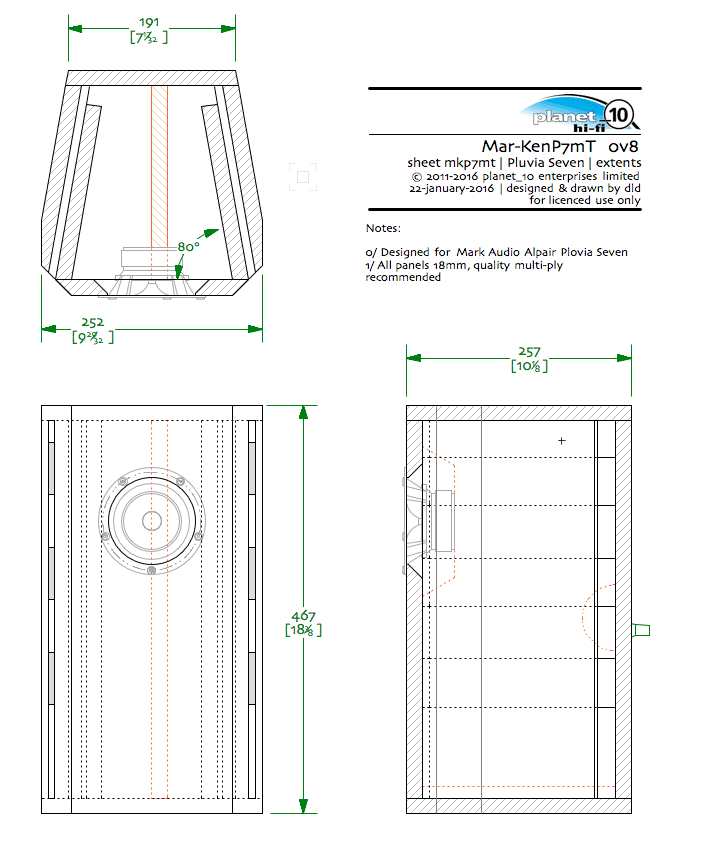

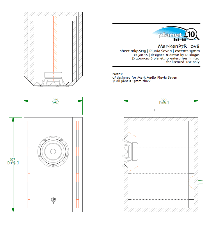

Poked by a member, i have started work on Mar-Kens for the new Mark Audio Pluvia Seven. Sketches below.
Drawings will be part of the CHR/CHP/CHN paid planset. I will need some beta builds thou. email me.

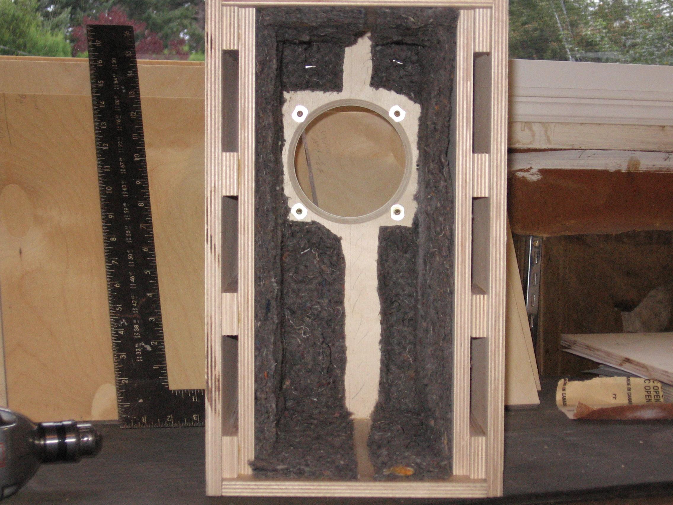

Any chance there are pictures of how it all looks on the inside when it's finished?
Not sure if this will help, but here's a pic of my old Fonken build from 2006, based on Dave's original design for the FE127e. You can sort of see the vent spacers act as stops, and attachment points for the rear baffle.
jeff
