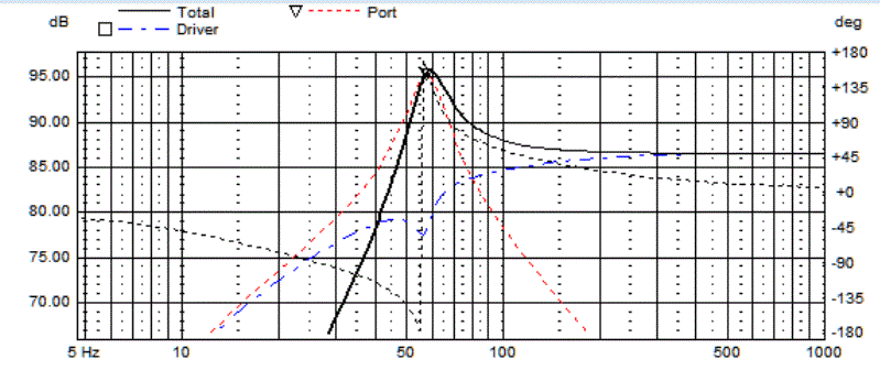

I wondered how you were supposed to turn this.
attachment.php
Into something attractive for the pensils. That's if simmed as a simple ported cabinet. If you have to add resistance to air flow around the vent it starts to make sense.

James F. Novak wrote.........
So it was Novak, good to know after all these decades, thanks! I actually learned about it during my visit to the Altec plant in ’68, though they used an impulse response to find the desired amount of damping to add at the vent. I was also made aware of Altec’s Don Davis’s and Alex Badmeiff’s book that had excerpts from some author’s paper/article you posted.
Having already seen how Altec did it, I tried it both ways and preferred the vent damping better overall, especially once I started experimenting with tower alignments [aka MLTL] later that year which usually either needs none or just a layer or two of double knit cloth tightly stretched over the vent the way I design them.
Note too that a MLTL's 1/4 WL action will either shorten the vent for a given tuning or lower tuning for a given vent length which in turn lowers the peak, so if SWAGGed in a reflex program you need to lengthen the vent to account for this. Unfortunately, I never saw a simple pattern, so just used a sufficiently large area vent located near/at the bottom and found the vent length using impedance measurements. With MJK's MathCad software though, folks can sim it all fairly accurately if polyfil is used.
