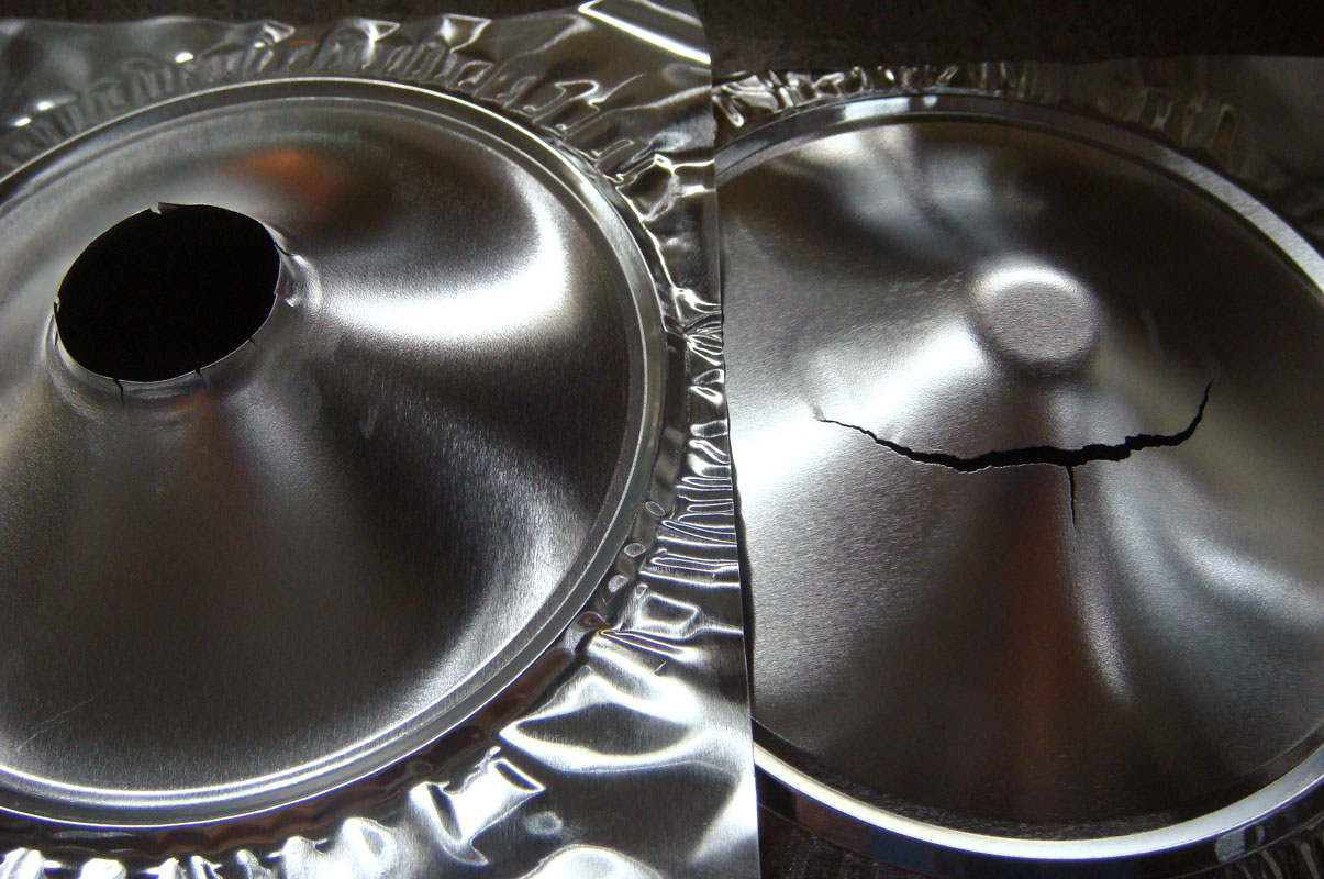

Hi Guys,
Out of interest, I thought you might like to see a pic of the rupture testing that we do on the Multiform cone press passes (see pic). We use these test pressings to measure the tensile strength and flex ratio at each press pass.
5th's last post (No. 34) is correct re my design work (possibly a fellow driver designer/maker in the making?). The is precisely the point about this aspect of my design work, that you can use the larger excursion with linear results, on non-regualar LF loads. 5th, description of my work is better than mine. Unfortunately my partial dyslexia hinders me. Apologies to members who find my texts full of typos and a bit complex. I have to think in "word pictures", visualising engineering drawings and components, associating them with a memorised word(s) as I type. While not 100% ideal, its a method that was taught to help me manage this disability but it takes allot of time.
A few months back, I did try using X- figures as a guide for running in and general operation of a driver. I got a hail of emails and posts on exactly how do diyers go about actual measuring the physical excursion while the driver's operating. It became a nightmare so that idea sort of got scrapped.
X-Mech is a measurement of the safe regular operation for a driver?. No driver maker that I know specifically quotes an Mech measurement for the "expressed" purpose to quote a safe regular excursion load. Commonly, X-Mech (or similar) is stated as the total mechanical stroke available from the driver's power-train. So until the industry agrees a comprehensive set of standards, all I can do is to advise on regular basis on this forum. Back in June-July, I put an advice note on all Markaudio PDF's that can be downloaded from the Markaudio site. I also started the Markaudio Aren't Woofers, thread so unlike most other makers, I am trying to help.

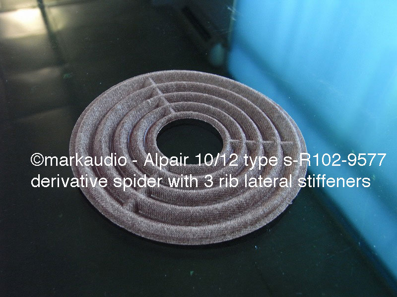

One thing Matsubara san and me working on is more advanced rear suspensions (spiders). We are now starting to use a spider with spines. We've done allot of work to control the resistivity at the outer excursive limits. Currently, all the latest batches of Alpair 10. Gen's 2's are fitted with this up-grade (see pic). The latest design of this suspension type has additional stroke resistance from 7.2-mm onwards, but that doesn't mean its "open season" to use the Alps with this upgrade as woofs!
I'll have to think some more on how to provide data or advice that is practical to use, meaningful to the majority of end-users. Just coming up with X-Mech, X-Max, X-Zing, X-Ping, X-Thingy........whatever we call it won't hep the typical Diyer trying to figure the next project. This measurement issue has been around the block so many times already.
Cheers
Mark
