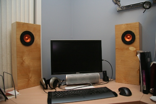

I have them for about a week now. Overall – that’s exactly I was looking for.
Design is not too complex, to be impossible to implement, same time not too simple – to be interesting and challenging enough.
I like the way they sound – clean and powerful. Way better than my old Quest 5.1 set (to be fair I paid 100CAD for the whole set including active sub).
Treble is incomparable to my other pair of OB-RAW with ribbons, and base is incomparable with my Cerwin-Vega floor standers. But that’s PC speakers – sitting in front of me right now, playing music really-really sweet. They not take half of my room. They even not take a lot of my desk. They don’t mind to play in the corner, right against the wall.
So, one more time: thank you HareBrained, really like them.
