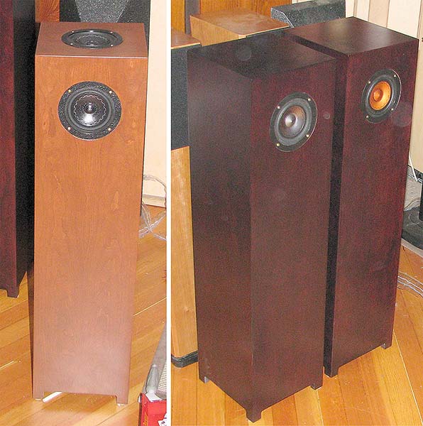

We have just finished 2 variations of a microTower ML-TL for the CHR (and EL70)
I have started a separate threas as there are many variations.
http://www.diyaudio.com/forums/showthread.php?s=&threadid=148901
dave
