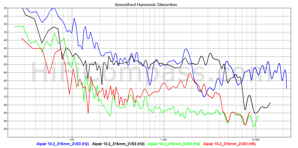

I did found some test results of a Mark Audio driver at HiFi Compass. The Alpair 10P The measurements include Harmonic Distortion, HD Frequency Response plots. I had forgot about this site. There are test results for many drivers posted, including a new metal cone from Purifi. https://hificompass.com/en/speakers/measurements/markaudio/markaudio-alpair-10p The measurement for the metal cone looks like one would expect. The paper cone has a rise in distortion mid band at 550Hz for some reason. Results from one driver, so who knows.

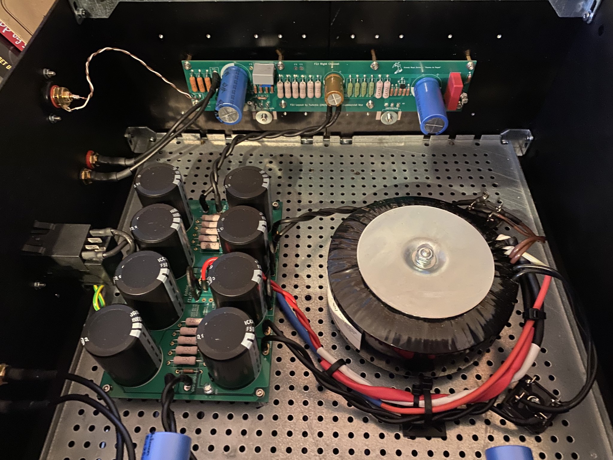

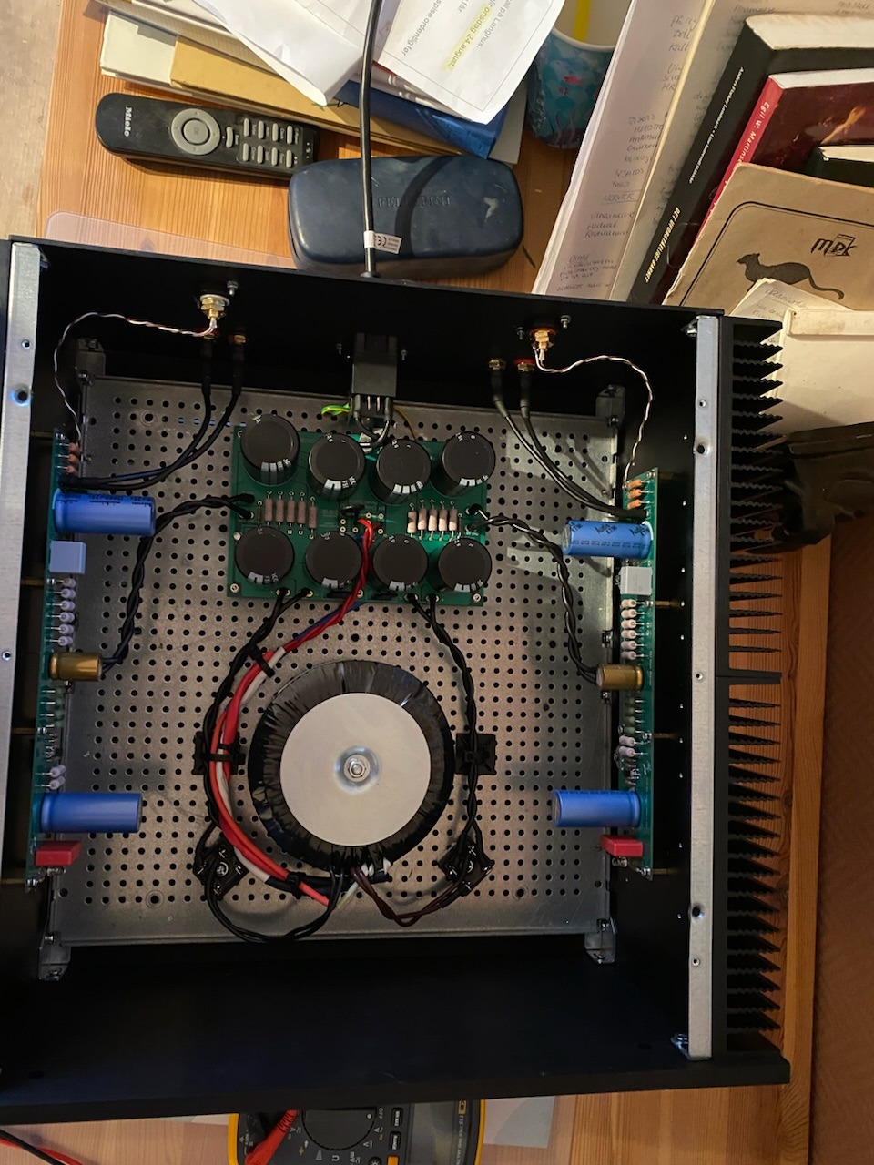

Well a couple of weeks on, I gotta say the F2(J in this case) and 12Ps is a match made in heaven. Mid range is tamed, the transistor radio tendencies are gone, highs are more extended, and bass is just moooooore.
So far everyone that has listened to it didn’t wanna stop.
And that is before any tinkering.
Simply love it.
Andy

That is a thing of beauty. Nice job. So good when it sounds right. I've been working on designing a box for an amplifier this week, and deciding on the layout of the boards and connectors in the box is my least favorite thing to do.
I agree, it is a real hassle. But thank you for the feedback! PS: you probably know, but the F2 is a current source, so some of the things I commented on are parallell to Papas article on the subject.
For this amp, I tried Pa’s First Watt layout. Boards are not made by me. I wanted to see how his layout works, since it contradicts some of my audiophoolery assumptions. And it works very good!! Though, the tranny buzzes, so a new one is being made as we speak. Will try a dc blocker anyways and hopefully get a refund if that doesn’t work.

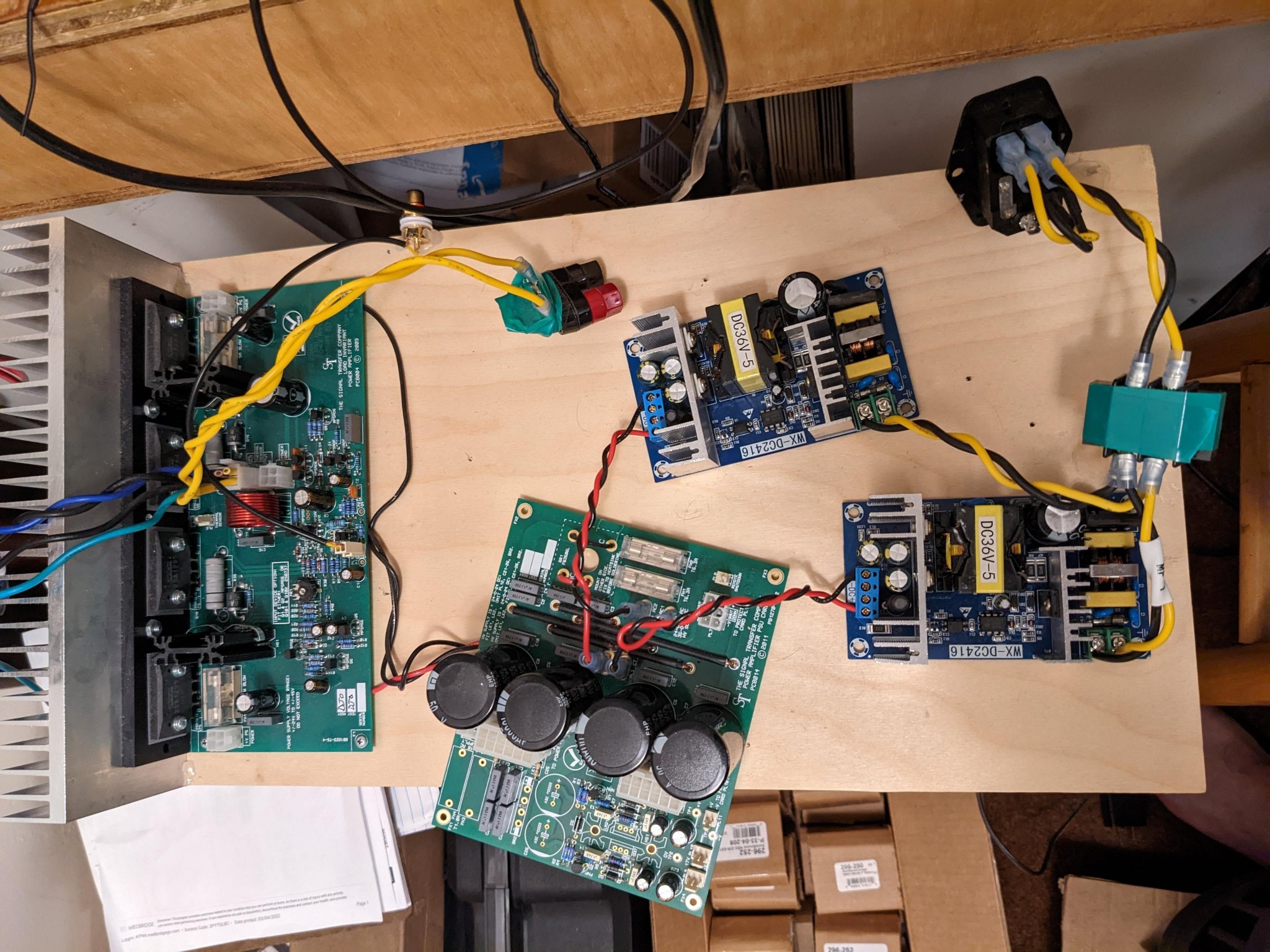

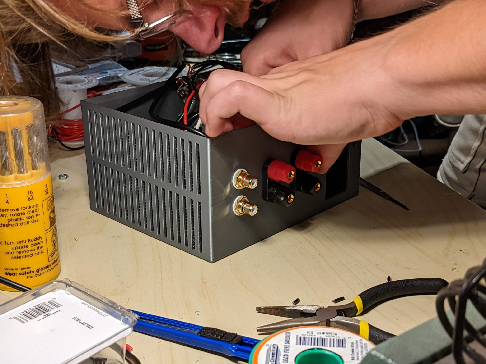

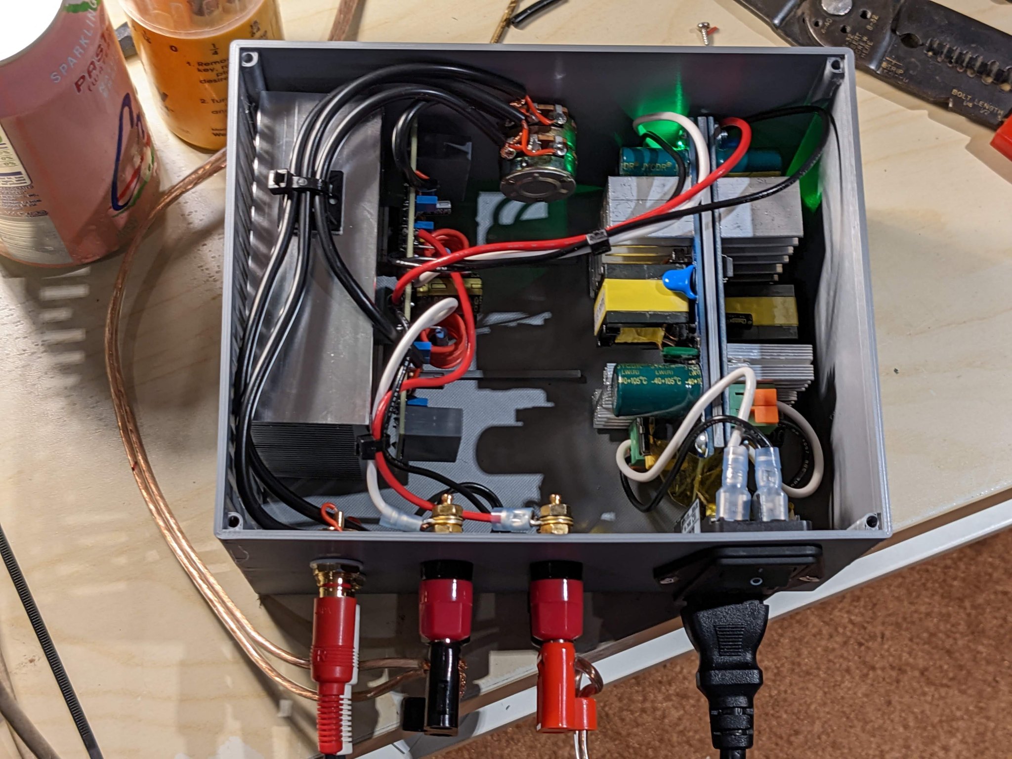

I bought the Douglas Self Load Invariant kit a while back and I decided to build it as two mono-block amps with switching supplies for light weight. I will mod it to be a transconductance amp as well. Mr Self wasn't real keen on the idea when I asked him about it, but I tried the mod with the spice model and it looks fine. I was inspired by my son 3D printing a case for his amplifier build last month, so I'm trying to shoe horn the Self boards into the size case I can print with my printer. Here's a picture of the Self boards on plywood and a few pics of my son's LM3886 amp in the printed case. My case will be hitting the limits of the printer at 250 mm x 200 mm as the heat sink is 250 mm long.
