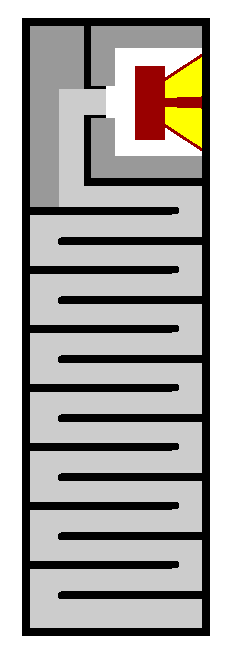

Sealed aperiodic TL
I am not sure should a sealed enclosure with an acoustic labyrinth inside be called as transmission line, but I may try that.
The whole point is in damping the system acoustically enough that you don't even think about dampen it more via back EMF.

A half-wave (ie sealed) aperiodic TL is a real possibility in terms of getting the resonant peak down to make it suitable for a current amp.
A heavy taper allows it to be shorter, the B&W Nautilus is the poster child for this. Here a prototype:
I used a similar idea (but quarter wave), aperiodic TL, to make a FR most suited to an OB (Visaton B200) work in a box.
dave
A tapered sealed TL with variable stuffing from very loose at driver to tightly packed at small closed end works very well to flatten impedance peaks. TL doesn't have to be long - even 12in is sufficient to act as an acoustic black hole. This is basis of the Dagger TL. Dagger is a tall 3-sided pyramid. 3 sides prevent side to side reflection resonances. Gradually packed taper slowly absorbs sound like a Wood's horn, but for sound energy vs light absorption.
