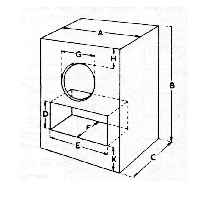

Could a ventilation opening A > or even Sd possibly also work as with many housing designs of the Philips 9710 M 01.
Can you give us example of such cabinet (housing). Link, plans, pictures?
Mark Audio Alpair 12 P Gen. suggestions
Hallo Davor,
I found some build suggestions for the Philips 9710 m 01 with big vents here,
especially the "corner vented enclosure" with a 222 qcm vent
tannoy
and at :
Applications Philips 9710 M | PDF | Loudspeaker | Ellipse
the attached drawing should be "3. basreflex kast" as I remember.
Kind regards
Stefan
Hallo Davor,
tannoy
and at :
Kind regards
Stefan
