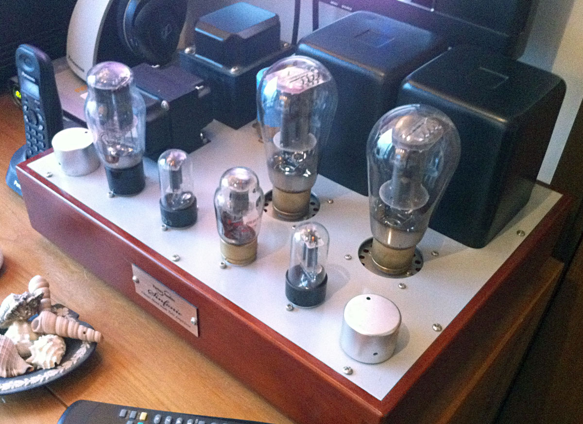

Hi Andy,
Here's 2 pics of my Tony Wong 300B I use at home. The valve (tube) combination of this amp work well (Full Music 300B's, Full Music 6SN7, Japanese Vintage rectifier and Russian 6SN7's on left/right channels. The valves are getting a bit tired as we use this amp around 8 hours a day on average. We run all audio through this amp (local and cable TV, CD, DVD, etc.,)
7 watts of 2A3, should also be nice for the Alps.
Cheers
Mark.
