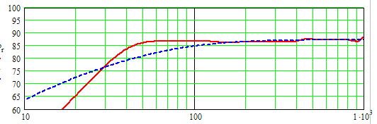

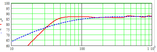

Anyway, a basic sim of JG's MLTL and your slightly smaller one with the same 0.5 lbs/ft^3 stuffing density:

For simming a vertical bottom exit vent, just subtract the vent length from the total length, so whereas JG's vent is 44" down, yours would be 41.5", which as you can see in the sim makes a completely inaudible difference from a cab design POV; though in-room your vent will sound different to some extent depending on how much vent/floor gap there is and whether it's firing at a reflective or damped surface.

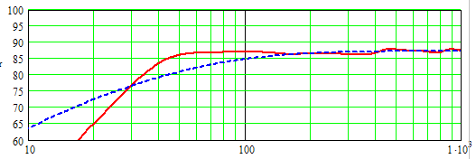

Yes, the model shows the 5" port gives better low-end extension. If I have the port vertical out the bottom (the speaker will sit on 1.5" spikes over carpet) then to keep the 44" zport, the total length of the speaker will be 49". This looks quite good in the model, but then I agree this is "splitting hairs", since the differences seem very small from the original.

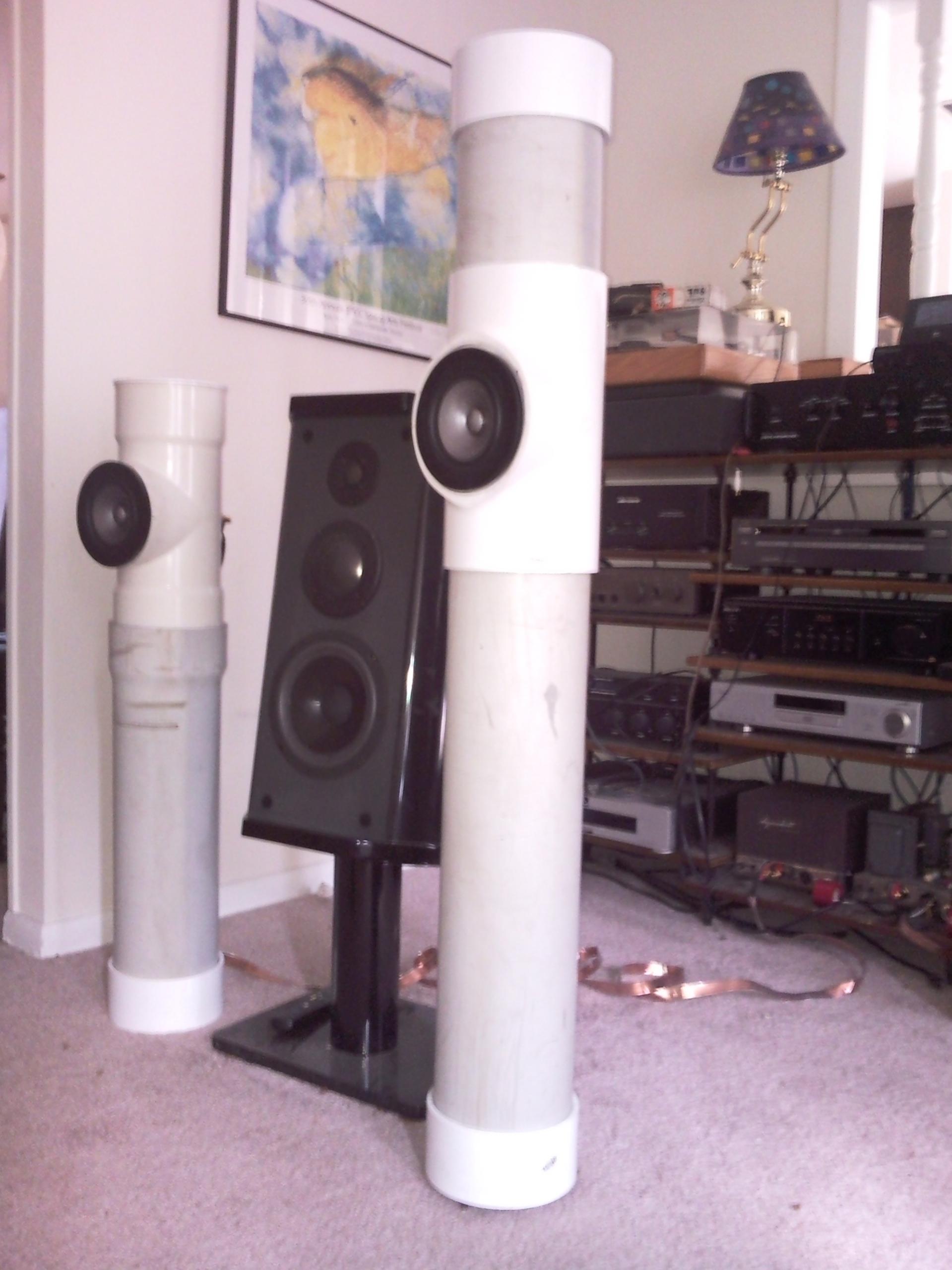

PVC pipe MLTL proof of concept
In the course of this project I have learned more than I ever wanted about PVP pipe specs. It all started with a local source of "Schedule 40" 6" PVC pipe. The first Tees I bought off of ebay turned out to be for drain pipe, and did not fit. I was however able to jury-rig one up with a scrap piece of Sch 40 pipe to mount one of my Alpair 10.2 EN drivers (from Dave) for break-in. It is on the left of the photo. Shorter than optimal, but actually sounding very good!
I then bought some real Sch 40 Tees (much more expensive...) and came up with the speaker on the right. It is close to Jim Griffin's dimensions (L=46.1", Zd=16", Zp=46", So=Sl=182 cm2). I am planning to cut and inch off the top to give L=45.1, Zd=15, Zp=45. (I have found that Martin King's sheets don't like L=Zp.) There are 25 lbs of lead shot (inside old socks) wrapped completely around a 5" vertical port (1" radius) firing out the bottom. It stands on 1 3/8" spikes. It is still breaking-in, so I can't comment on sound yet.
This is truly an easy project for those of us wood-working challenged. The only real trick is getting the driver mounted securely and as close as possible to the vertical column. The drain pipe Tee was much easier to work with, and may be practically identical in performance. The Sch 40 Tee presented an oblong opening after I cut off the horizontal arm. I used 1" long rings cut square (with a band saw) off the ends of the 6" PVC pipe, fitted and glued to the inside of the Tee opening, and screwed the drivers to their cut ends. I cut open each ring to the proper length (circumference) and placed them in a 300F oven for about 10 min. They come out as soft 1" wide strips of plastic, maleable to any shape. I molded each to the opening let it cool and glued (welded) it inside the opening. When dry it was ready for pilot holes and mounting screws. PVC requires more torque when turning the screws in the pilot holes than does wood, and I stripped one screw head. Fortunately Dave sent me a couple of relacements, thanks Dave.
OK they are cosmetically challenged. I am soliciting advice on beautification. I am considering fitting a whole body sock for each speaker made of grill cloth fabric.

Another possibility might be wrapping the top and bottom sections with carpet and allowing the t and end caps to remain as is. Really looking forward to hearing your comments on sound quality once the drivers break in. I'm guessing the rounded shape will help them disappear and image like gangbusters!

Whatever works best overall with the room decor/WAF unless you want them to stand out like a 'sore thumb', in which case I'm partial to brite white, accent shaded with Dayglo orange to create a Creamsicle 'look' 😉.

One added benefit of using automotive carpet is the backing might be helpful in dampening any structure borne resonances. Might be subtle but then again sometimes all those little things add up. Another thought too is you might want to try some kind of a "footing" under the speaker, such as a wood, marble, granite, that will allow the port opening to fire into the room more without getting muffled by the carpet and its underlying padding. This would be easy enough to try both ways and see what you prefer. Again "kudos" for a nice design!

I went over to MJK's Yahoo Group, and with Martin's guidance, I have modeled the speaker using a double-sized driver positioned halfway between the forward-firing driver and the top of the TL. Yes, there is more ripple because of the higher position of the driver on the column. The bass also begins to fall off 10 hz higher because of the relatively small cross-section. The only way to prevent this is by doubling the cross-section of the TL and the port.
