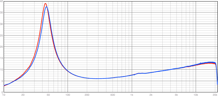

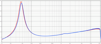

GM said:Without an accurate, high resolution impedance plot
I can post one later today after i get out of the field
dave

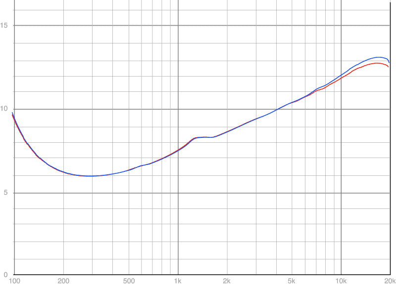

Hmm, Re has been measured as 5.4 ohms, so how come the impedance has already fallen to ~3 ohms at 10 Hz? Is this the right plot?
GM
GM
GM said:Hmm, Re has been measured as 5.4 ohms, so how come the impedance has already fallen to ~3 ohms at 10 Hz? Is this the right plot?
GM
That is an artifact of the measuring system.
dave
OK, thanks, then it looks like Re doubles around 6 kHz, so using the above formulas:
R ohms = 6.75
C uF = 4.912
FWIW, assuming the HF roll off is an artifact also, then at 0.1028, Le calculates a little higher than published which changes my previous zobel's capacitor from 1.58 to 2.256.
Never having used any formulas other than the ones I listed, I don't know if there's any audible difference between them, so choosing a capacitor value anywhere between 1.58-4.912 uF may be close enough.
GM
