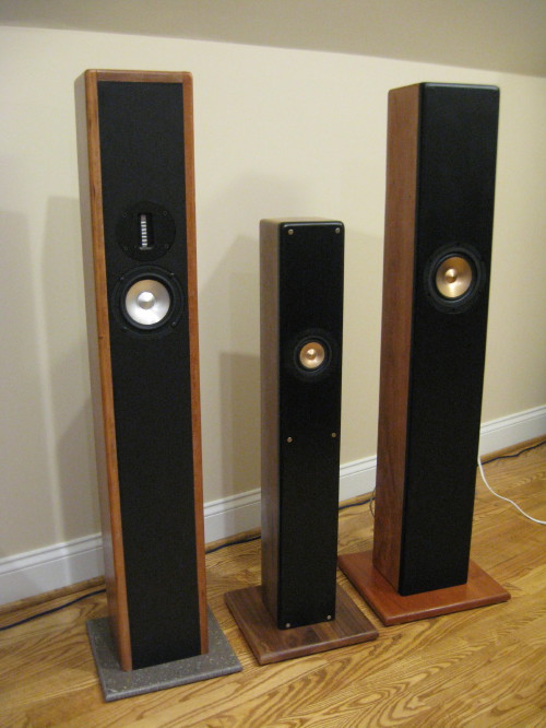

Re: Photo of Three MLTLs
nice looking speakers Jim
edit: probably not, in scottmoose's design the driver is much more towards the top of the line
edit2: I should look at the new threads first, before asking
it's here
is that the same as presented by Scottmoose in this topic http://www.diyaudio.com/forums/showthread.php?postid=1711973#post1711973Jim Griffin said:...... the Alpair 6 MLTL....
Henkjan,
Thanks for the comments.
Actually I competed my design effort two months ago. But between then and vacation, illness, and such the boxes were not assembled until a week ago. While Scott's design is similar, I patterned mine after efforts that I completed a few years ago for the Jordan JX92S and 3" Tangband variants.
Jim
Jim

Re: Re: Photo of Three MLTLs
Er, crikey, I'd forgotten I'd done that one. Nope, as you noticed & Jim said, they're somewhat different. Similar, but then, you'd expect that out of raw necessity. Anyway, nice boxes Jim & hope you're back to normal.
Henkjan said:is that the same as presented by Scottmoose in this topic http://www.diyaudio.com/forums/showthread.php?postid=1711973#post1711973
