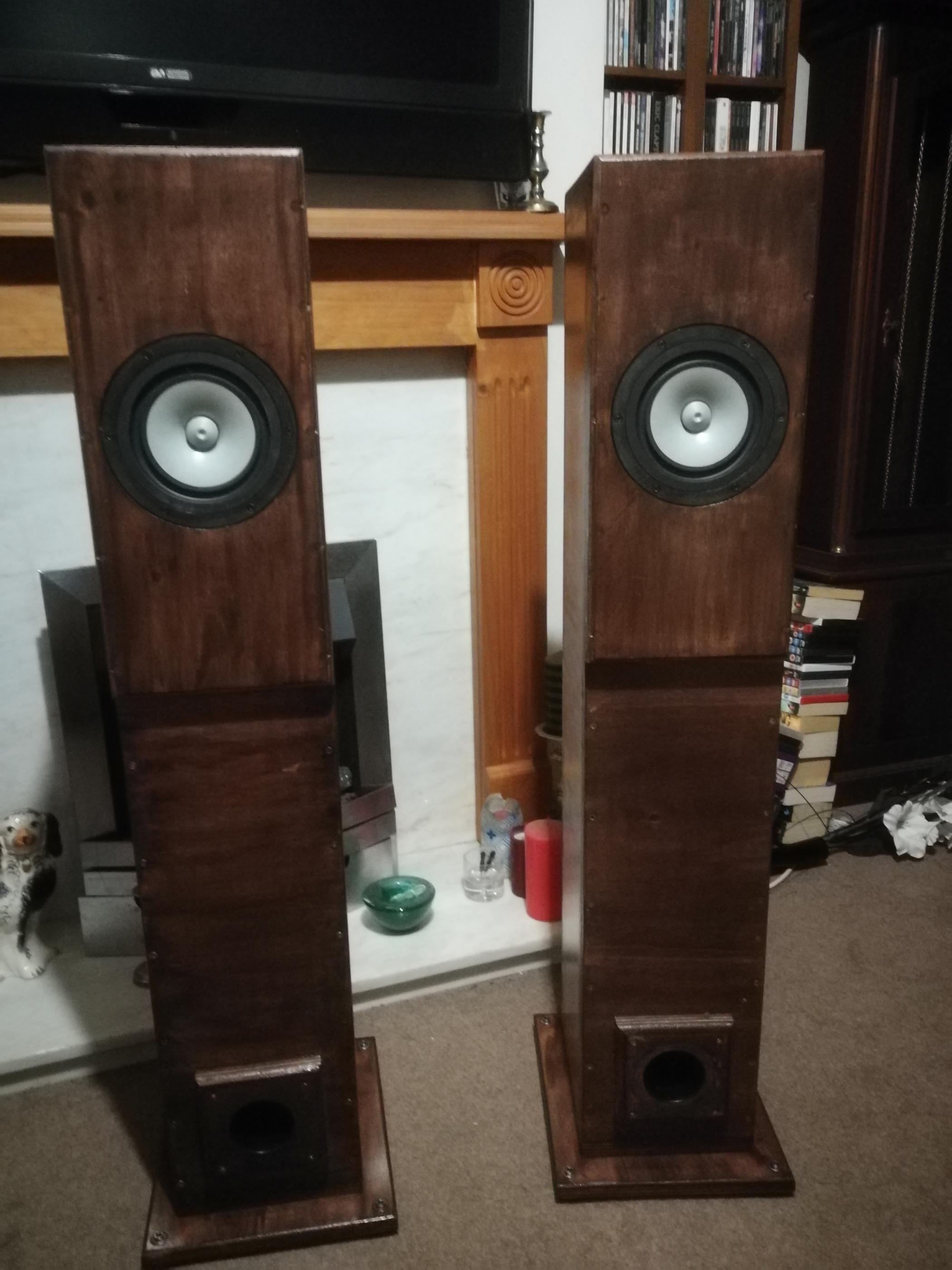

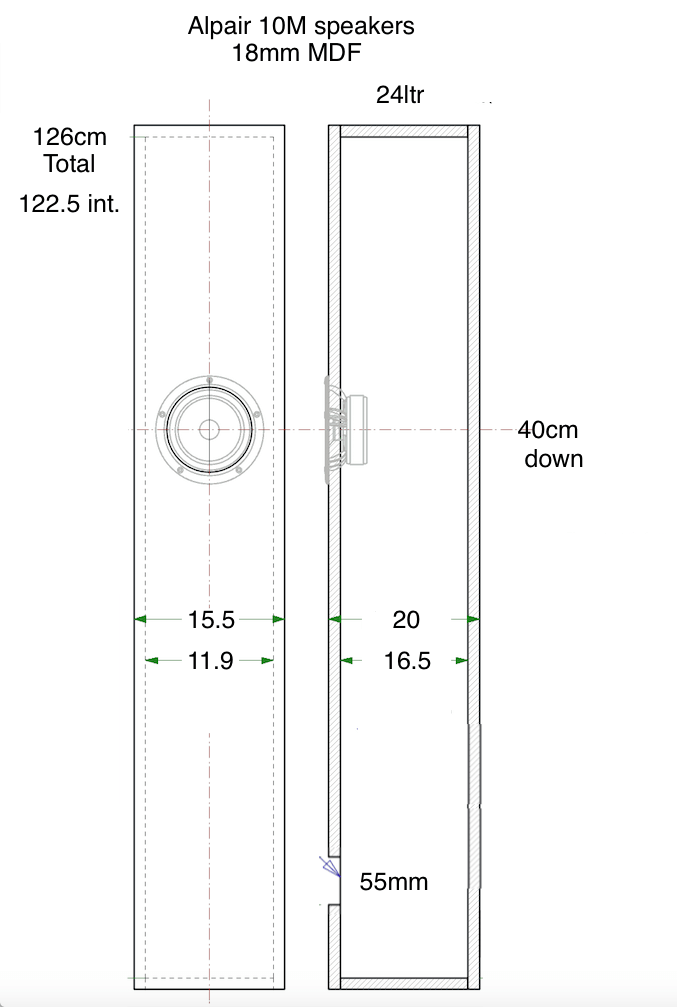

I have my Alpair 10.1 in 24ltr cabinets as shown. They are actually 5 sided, but I've adjusted the measurements for rectangular to make it easier. The actual front of my cabinets is 155mm wide. I have no idea where this design came from - does anyone know? I bought them as they were. 18mm mdf build.
At present there is just a 55mm diameter hole for the reflex port. Can somebody tell me how to calculate the tube I need to tune the cabinet? I have 2x tubes 11.5cm long. The interior is slightly tapered, 44mm at front and 42mm at the back, interior diameter.
