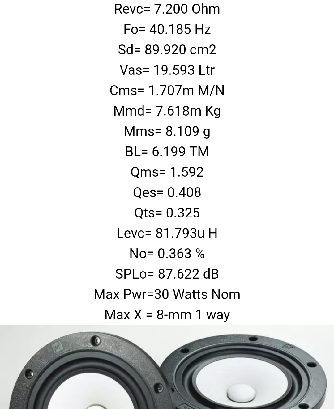

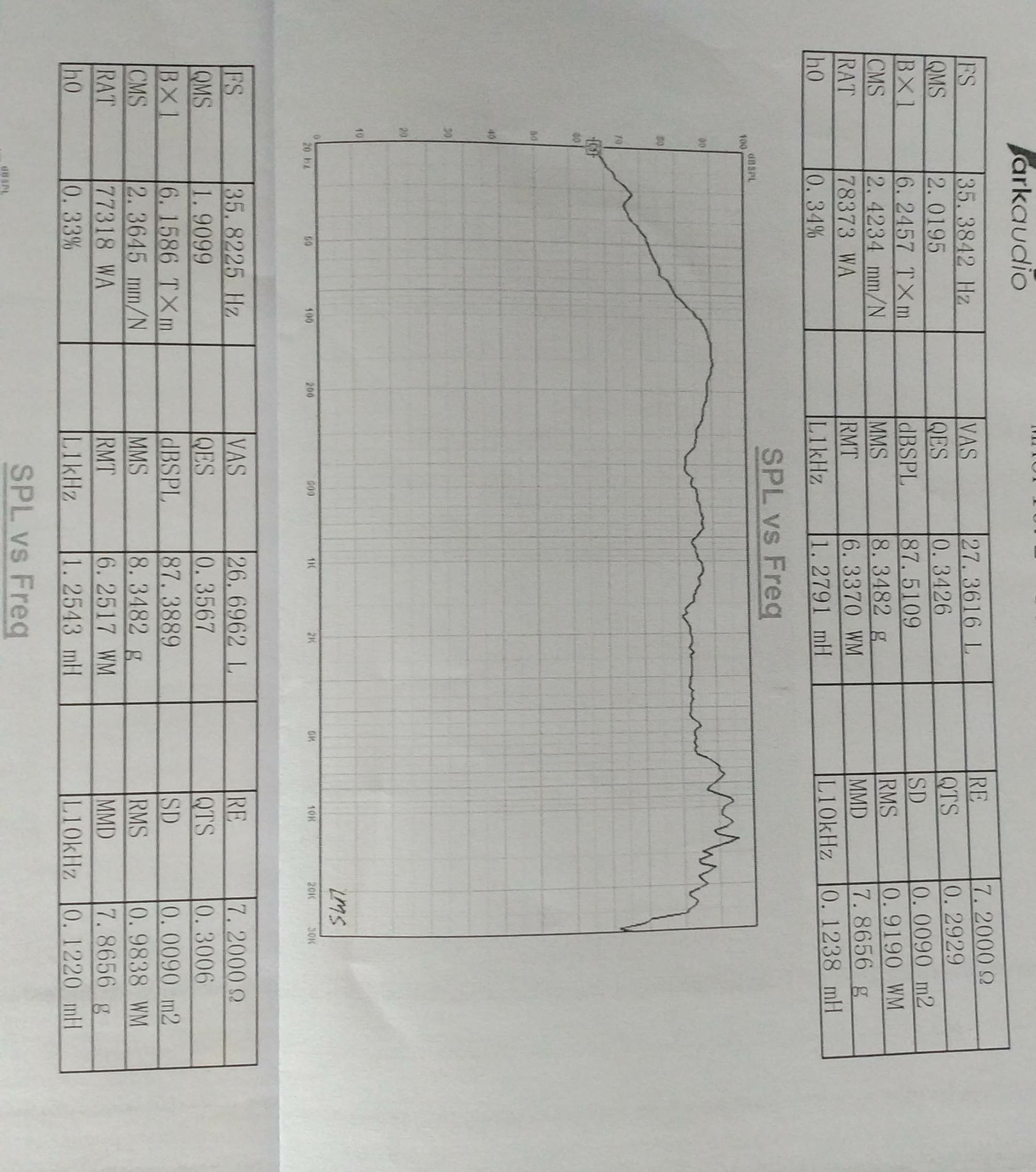

Hi all,
So I've pulled my drivers and tested them using the Dayton DATS V3.
I'm noticing right away that something is a bit...off.
Either the published specs are wonky, or the DATS isn't measuring correctly. If it's the latter, it very well could be something I'm doing wrong.
Regardless, the F(s) is measuring nowhere near what they publish on the MA site. The DATS is reporting around 41-42Hz (there's some variation I'm not wild about), but the site claims an Fo (is that the same?) of 38.266Hz.
Also, DATS reports a Q(ts) of ~0.396-0.422, whereas MA publishes 0.316.
Now I'm not gonna begin to claim to know enough about any of this to really comprehend the nuances of the various factors, but variations that large seem like they might account for some of the performance issues I'm experiencing with the set I've built using Jim's MLTL design. If he modeled it based on the published specs, and mine aren't operating at those specs, wouldn't that cause it to sound different? Or am I overthinking this?
I will note that these drivers are fairly thoroughly broken-in (60+hrs), so I don't think that's the issue.
Any thoughts appreciated.
-Mike

Rather close then; assuming 41Hz, DATS is giving you a figure only 6.67% from stated; assuming 42Hz, it's 8.9%. That's pretty good. All measurement systems will give different results due to the differing ways they work & how they're taken.
I've just finished measuring 4pr of drivers from 'a company'. No names. They're a major supplier, well known, well regarded, and have impressed me very much indeed. Excellent units, excellent pair-matching, fantastic build, great features. Out of the box, I was getting a 25% deviation in Fzero (Fs) from published. Hammering them with a 20 minute programme of infrasonic sinewaves, as usual, Fs, Qe, Qm, Qt dropped, Vas increased. They're now within 10% of advertised, which is pretty standard production QC tolerance. More of which in a minute.
You have DATS v3; this is the latest version and actually rather good: far more so that the earlier versions. You can adjust the drive level; maximum is 11.4dBu (about 2.883v). You want to see how T/S parameters change with voltage input, as Dave explained above? Go into DATS, open the Impedance Analyser menu, and select the DATS Linearity Test. Change the number of sweeps to 5, and increase the highest level to 11.4dBu. Let it do its thing and take a gander at the results.
T/S parameters also change, sometimes quite significantly, with local climatic conditions (ambient temperature, pressure etc.). For instance, I've measured over 7% Fs deviation in various units from a similar change in centigrade (room temperature).
Unlike a midbass, you can't hammer the MA drivers to full travel with LF sinewaves: they're low-mass wideband drivers, not heavyweight subwoofers and not able to be pushed that hard continually. The long travel is there to handle short-term loads -brief LF dynamic peaks etc. So it will take a while to properly break in the suspensions, which will drop Fs, Q, increase Vas etc.
