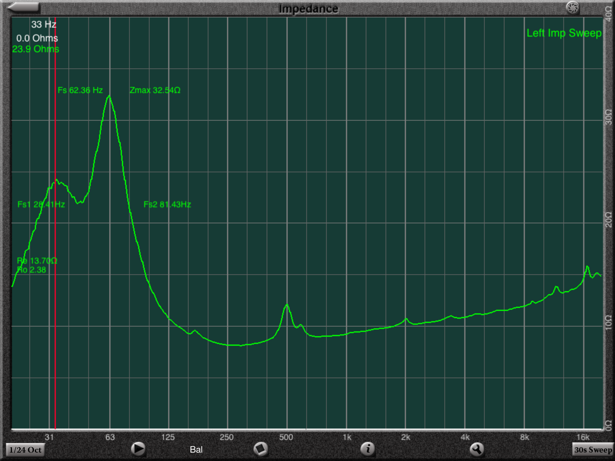

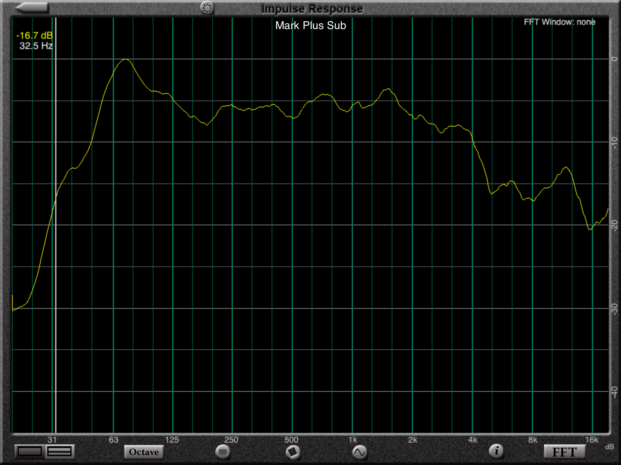

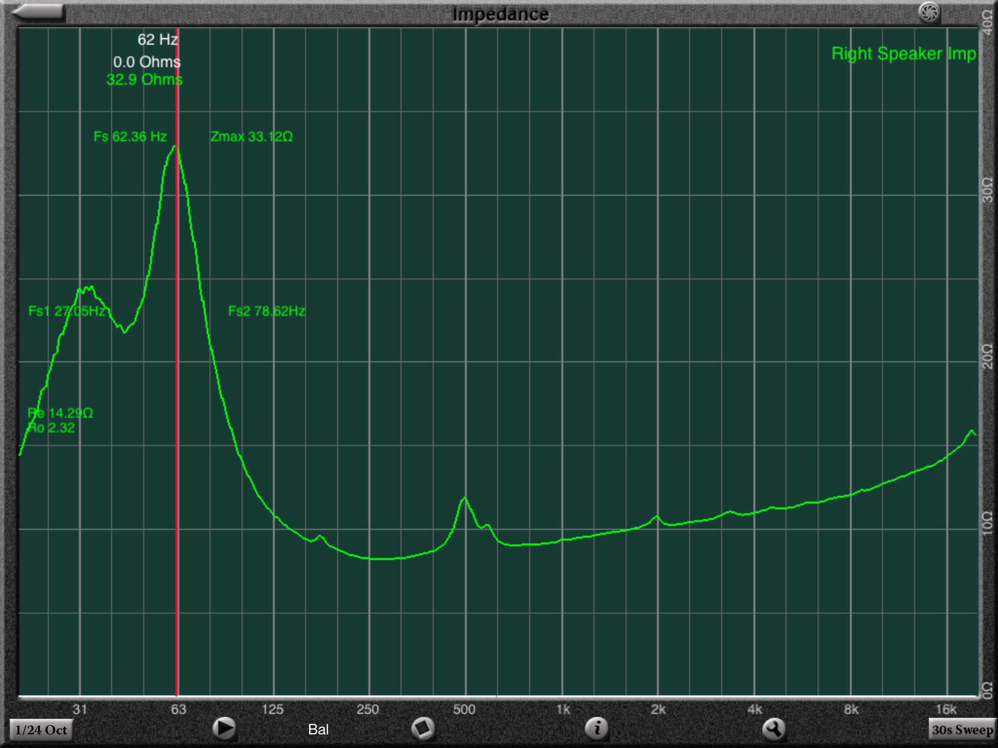

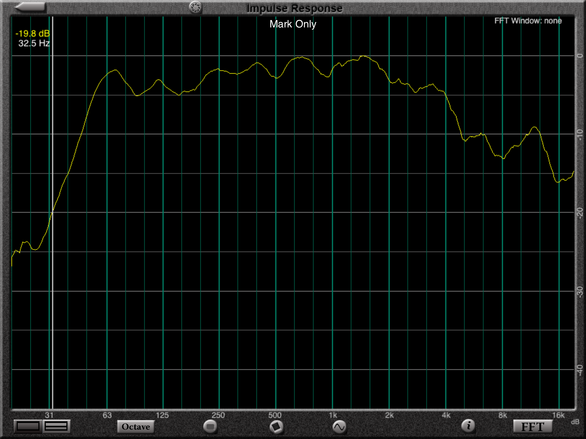

Impedance and Frequency Response of SuperPensils
Here are the impedance graphs of the speakers as well as the frequency response graphs of the Mark Audio A12P in a SuperPensil.
Looks good! Someone smarter than me can answer the ? about the first impedance peak at ~28Hz, is that from the tuning of the transmission line?
The second graph with the sub looks like a big bump at about 70 Hz, but it sounds quite balanced that way. It's nice to have the treble shunt on the decware, which acts as a nice BSC in a sense and rolls off the highs quite nicely.
