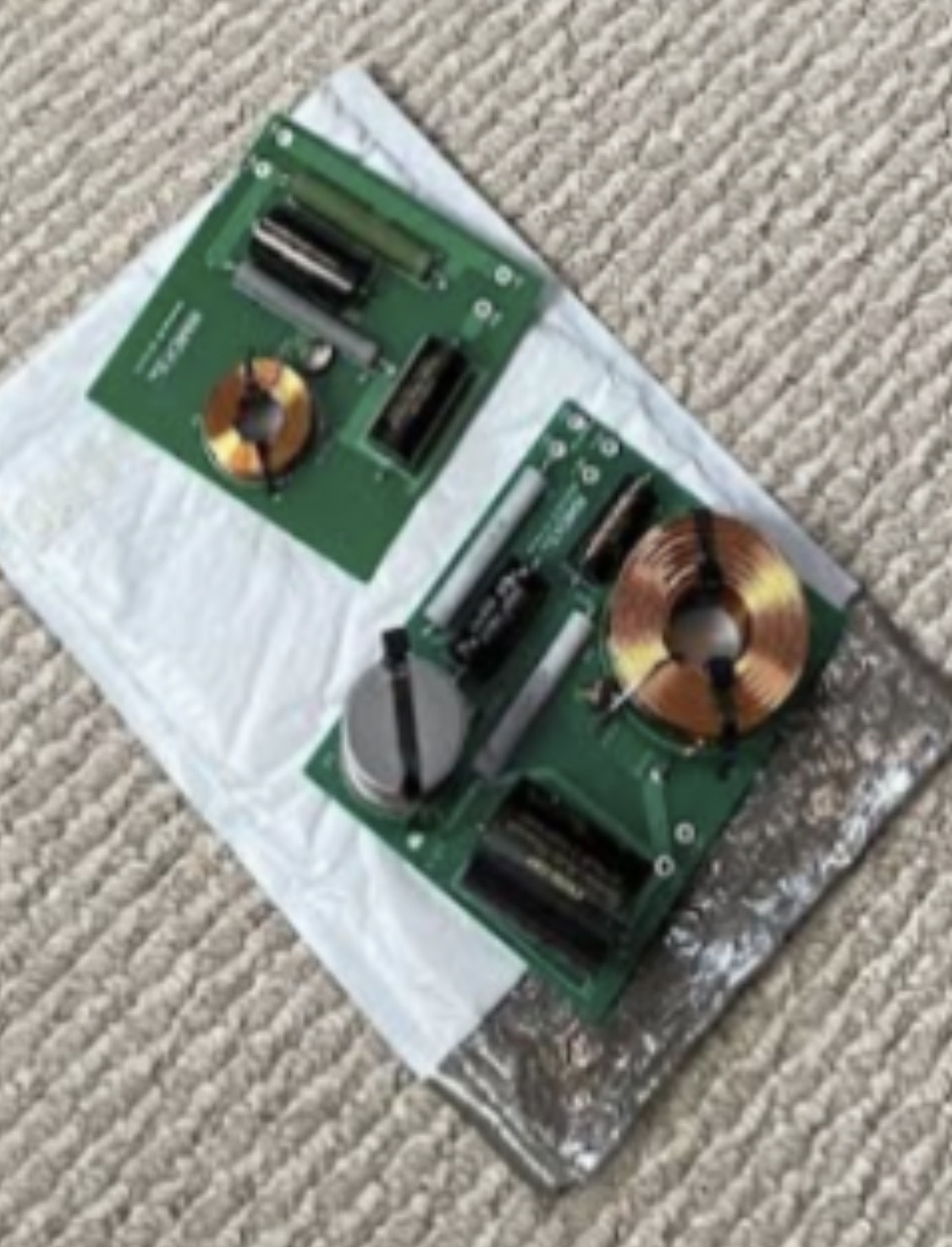

There’s nothing fancy about the crossover. The Purifi PTT6.5X is so well behaved the LP filter needs about 3 parts for a 1.5-2Khz LR4. All wave-guided tweeters bring the tweeter back in the z-axis, helping with time alignment AND you don’t have to worry as much with cabinet edge diffraction so you can tune your crossover using on-axis measurements and the rest of the off-axis falls into place.
One of Erin’s earlier previews shows good quality parts in the crossover but values were not shown for obvious reasons.
Reactions: Samps
Thanks! What’s that silver cylinder component? Inductor of some type?
