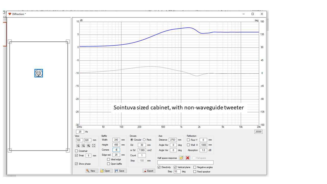

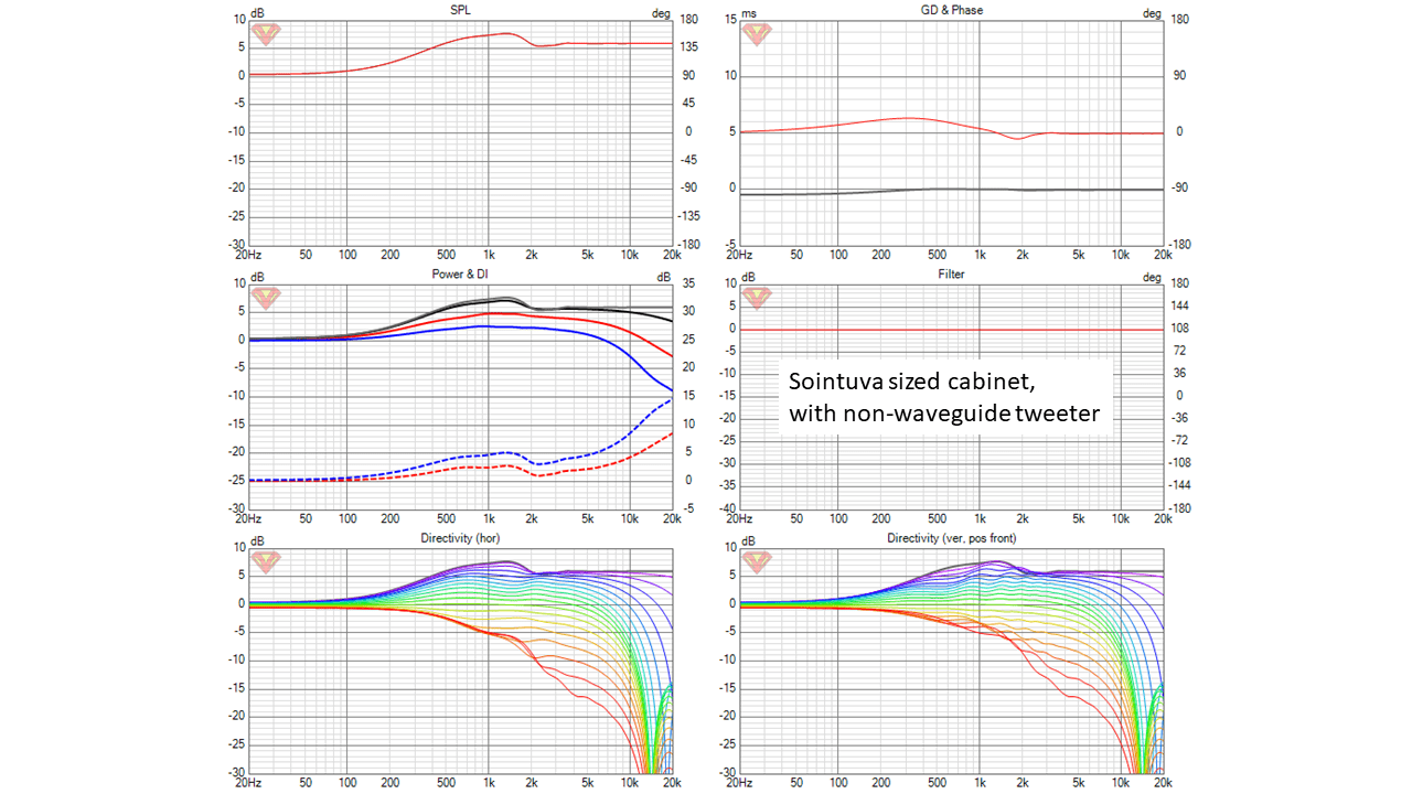

Regarding the Sointuva - I would love to see the spinorama data for the tweeter alone. I am curious as to how much baffle effect is present in the waveguide tweeter response.
If it were a flat-flange tweeter, we could make a reasonable simulation with VituixCad. The speaker is 240 mm wide by 450 mm tall, and I estimate the edge radius to be 25 mm. I guesstimated the position of the tweeter. With a normal dome tweeter, we would see an on-axis baffle gain (diffraction hump) of about 2 dB from 800 to 2k, centered at about 1.3k. However, with the waveguide, I am certain the response would be quite different. I speculate that the influence of the baffle size/shape is less important. But how much so?

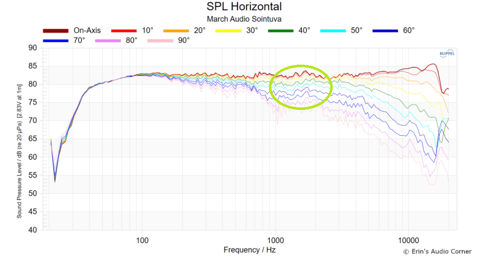

There is very little diffractive ripple in the measurements just a bit as shown here but that is below the crossover frequency. The waveguide and physical tweeter size make it become quite directional beyond 3K. Not much gets to the edge.

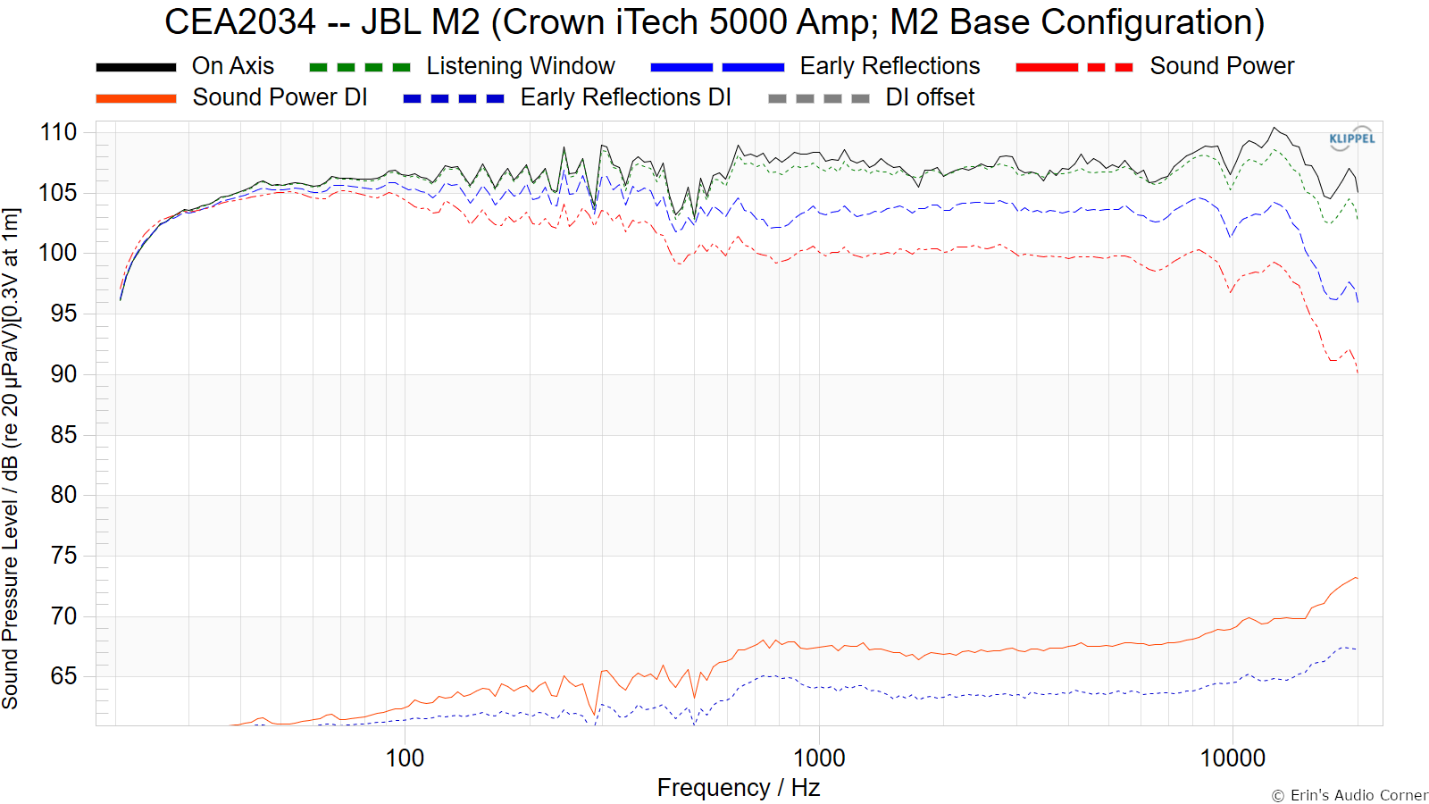

I’d even think JBL M2 is not a constant directivity speaker
To be clear I am on the same page, the speaker as a whole, I'd agree. But the HF portion, I'd disagree. Above 800Hz to about 8kHz, DI is practically ruler flat. See image below.
FWIW, my anecdotal, personal experience is that - when a speaker is designed for flat on-axis response & has flat DI (in the treble, at least) that it will sound bright in-room and would benefit from sidewall absorption. Or, you can use EQ to shelve it down if that's easier.
Yes, and keep in mind that this data is 1/20th-octave. Most backyard, gated measurements aren't going to show that. Even if they are gated to 5ms (which is on the higher end of the "typical" 3-5ms), that means you'd have only a data point at 1000/1500/2000Hz. Those little ripples aren't going to show up. Certainly not to the degree that we see them here. Better yet, they're practically constant. A small little filter here or there will iron those out. But, I'm not even sure it's necessary, all things considered.
