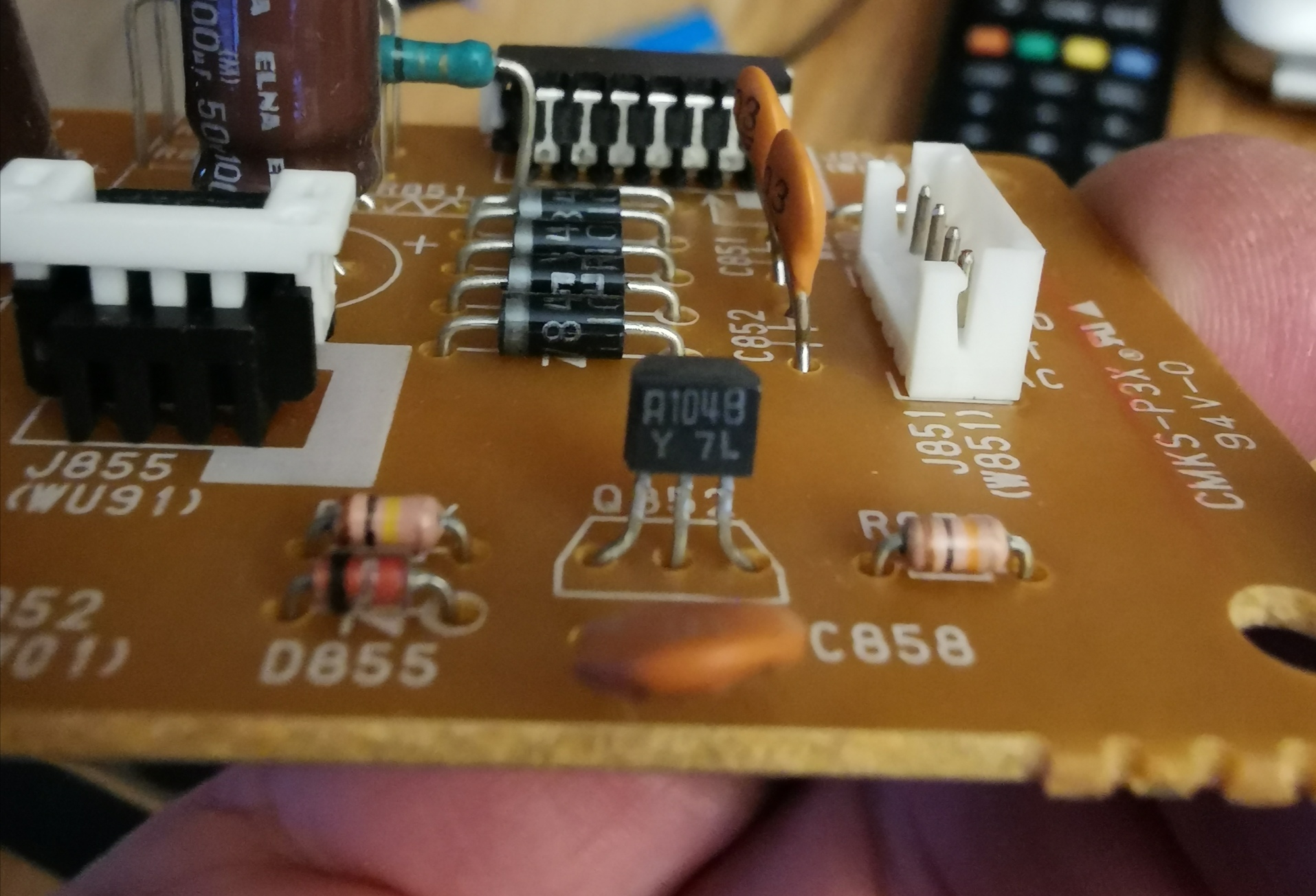

First observation of the evening is that the 24v showing at that wire link remains present when the headphones are plugged in, which sounds like it shouldn’t be the case.
Secondly, yesterday you said to check around the area of the 852 transistor on the little power board P851 just above where the headphone jack is.
That 852 transistor actually has 24v on all 3 legs, and that remains the case even when I plug headphones in. I’m fairly sure that’s not right, it wouldn’t make sense to me, so I’m wonder if possibly that transistor has failed open or something and it’s having a knock on effect down the line?
The power transistor nearby has 5v/1mv/33v across it, which again doesn’t change whether headphones are in or out.
The little diode next to the headphone relay has got 24v both sides of it, phones in/out.
As there's no 'load' (under the current fault condition) on Q582, these readings are not surprising (if you enable the 'MUTE' function, the BASE voltage may drop by 0.666V :devily:).
Q851 is a +5V regulator and you've confirmed that it's fully-functional. :up:
As the relays are currently not energised, that's expected. However, if that diode (DN51) or DN03 are open-circuit, the TA7317P will be destroyed. Explanation.

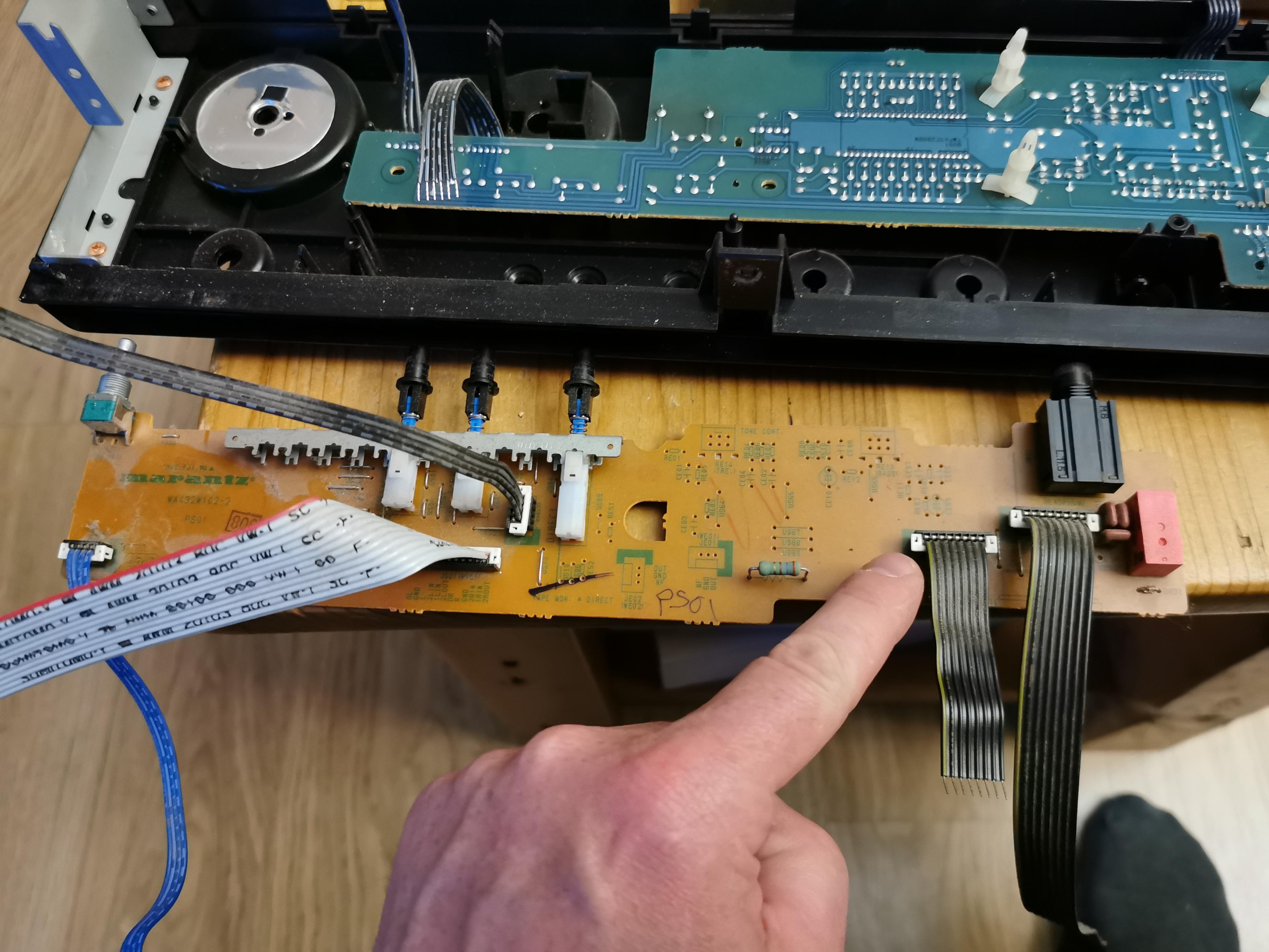

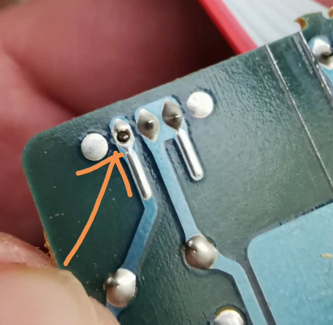

OK now I think I'm getting near part of the problem at least.
I removed the front panel and removed the 4 attached boards and inspected them.
Instantly spot that the connection of the cable from P851 power board to P501 control board is proper nasty looking, and appears to have been messed with before as it looks like a big patch of flux or something around it. These connections are all super close to the headphone relay which is not doing anything.
Now something odd about this setup is where that cable begins on the little power board, it has a track feeding each core of the cable, but where it joins this big board only 2 cores actually appear to go to anything!
Seems like a single layer pcb so I'm assuming the other cores have no purpose, maybe for a different model where that board does more stuff perhaps. I'll check the diagram to be sure.
Anyway, despite looking bad they seem to have good continuity, but I don't think it's a coincidence that this looks bad and appears to have been resoldered, while there's an issue with the nearby relay, and the transistor on the board feeding this appears to have shorted open.
So I guess I'll have to order one or a few of those transistors to replace it and see if it helps, unless there's some sort of temporary bodge just to see what would happen if it was working briefly?

...Now something odd about this setup is where that cable begins on the little power board, it has a track feeding each core of the cable, but where it joins this big board only 2 cores actually appear to go to anything!
Great observation... And only 2 x conductors (pins 2 & 7) are used in this amplifier.
And that PCB is a bugger to remove.
The resistor to the left of your finger in the 3rd picture is where the +24V loses some volts and becomes +17V. Check that it's still 270R.
...and the transistor on the board feeding this appears to have shorted open.
"Shorted open" is an oxymoron. :cannotbe:
Be aware that Q852 has several components across it which may cause erroneous readings on your DMM. If in doubt, remove it and test. However, a short-circuit is always close to zero Ohms (0R).

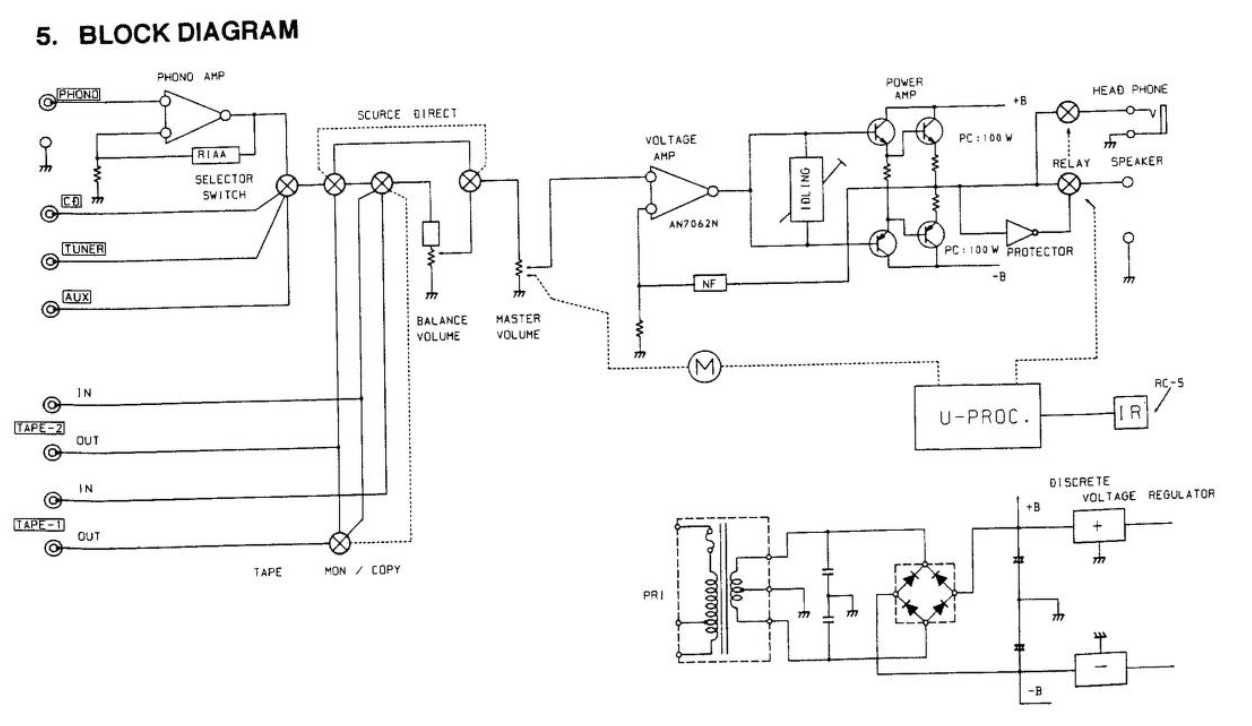

I'm not so sure that in this amp, the RC controls the inputs as the selector switch is a mechanical device. Also, the block diagram in the service manual shows that the UC only controls the speaker relay (for mute) and the motorized volume control.
