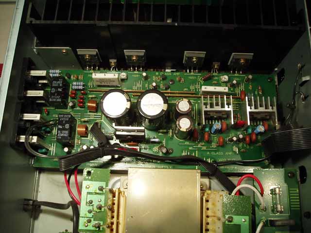

Hi Brent
Done some pics on the Kenwood.
Can't seem to work out how to attach multiple images so have emailed to you. Bloomin noobs..........
Started this thread a while ago
http://www.diyaudio.com/forums/showthread.php?s=&threadid=89068&perpage=10&pagenumber=1
and Rich has put down info on what he found when he popped the hood.
Dunno if its enough to give you some ideas.......
Jim
Jim
- Marantz PM66KI amp.
