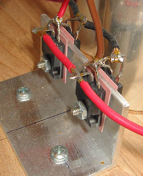

Ran amp quite hard last night and all is good. The amp now runs at a warmer level without the heatsink getting too hot. The treble defo has more attack with the bass appearing to be tighter. This could be due to the higher idle current and or the heatsinks. The heatsinks are dead to ringing.
Here are a few pics of the sinks in situe
Brent
Brent
rowemeister said:NOTE – VOLTAGE TO OUTPUT IS NOW 46V (WAS 38V) THEREFORE THE OUTPUT WATTAGE SHOULD BE 80W INTO 8 ohm AND 100W INTO 4 ohm.
Looks terrific mate. I'm glad you got the heatsinks in there and idle current up nicely.
Why do you say "100w into 4ohms"? Why not 160w into 4ohms? With double the transformer and massive caps, what is limiting the current into a 4ohm load now?

Well I'm basing it on the PM17 for now until I have proper proof.
The PM17 is rated at 100W into 4ohm with a voltage of 44V.
Yes my TX and caps are larger so maybe the output is more.
At the moment I am running the standard output transistors on the heatsink (100W max) to make sure everything is ok.

Excellent. Well if one transformer could muster 2 x 100w before, then two can surely manage ~ 2 x 200w. It's an amp with balls now 😉

Hi Jim
I find the AC caps much better than the FK, they are more natural sounding. I have tried various plastic etc caps and non came close to these. I believe a small fortune would have to be spent to better them. I use them on the output of my cd player too. Use the FK on a 12 or 5v rail in your cd player,I find the FK are hard to beat here.
Idle current, don't go above 20mV (100mA). I originally had mine set to 25mv and after about half an hours listening at an avarage volume the heatsinks were cooking. The lower idle voltage its set too pushed the minimum temp up and when driven harder they got too hot for comfort. If I hadn't got the large caps fitted I would have bolted another heat sink to the inside of the original ones. I do think the original heat sink is very good at dissipating heat, but of course the higher idle current pushes the boundries.
For the bridge it is quite straight forward. As long as the diodes are the correct way round you can't go wrong. The original bridge runs very warm in the 66 but my 4 TO220 package items run fairly cool.
