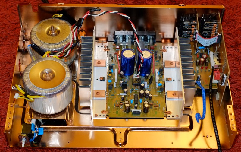

To answer the question about capacitance ... from the beginning of the 3D
I have done quite a few mods to this amp now so I thought I should post a pic.
The most noticable mod is the rather small res caps. lol
The bass is very good from these caps and no loss of treble etc.
Maybe this is too much. But 2 nice 47000 uF ... :rolleyes:

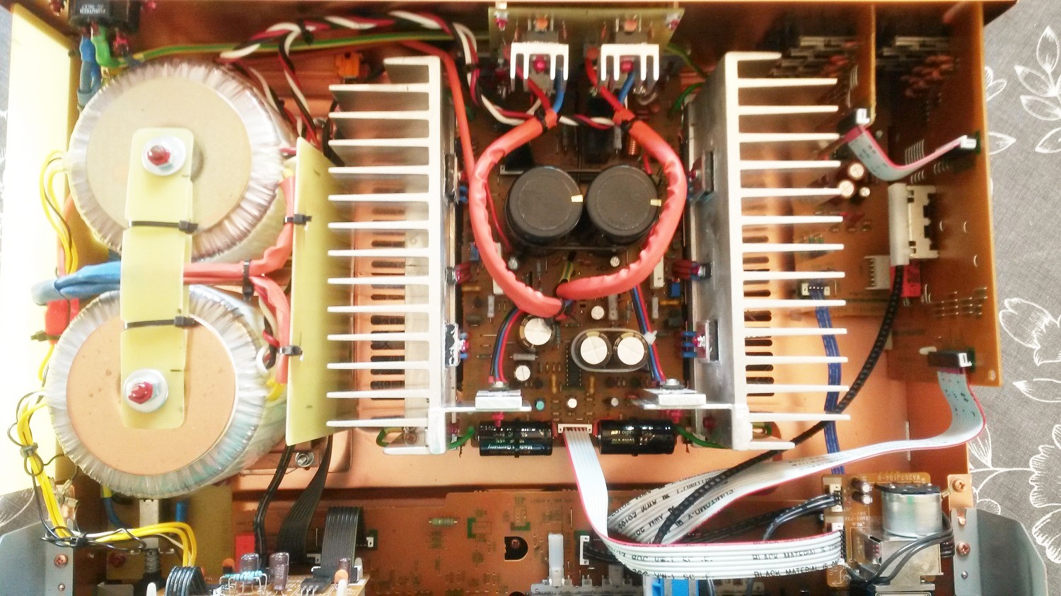

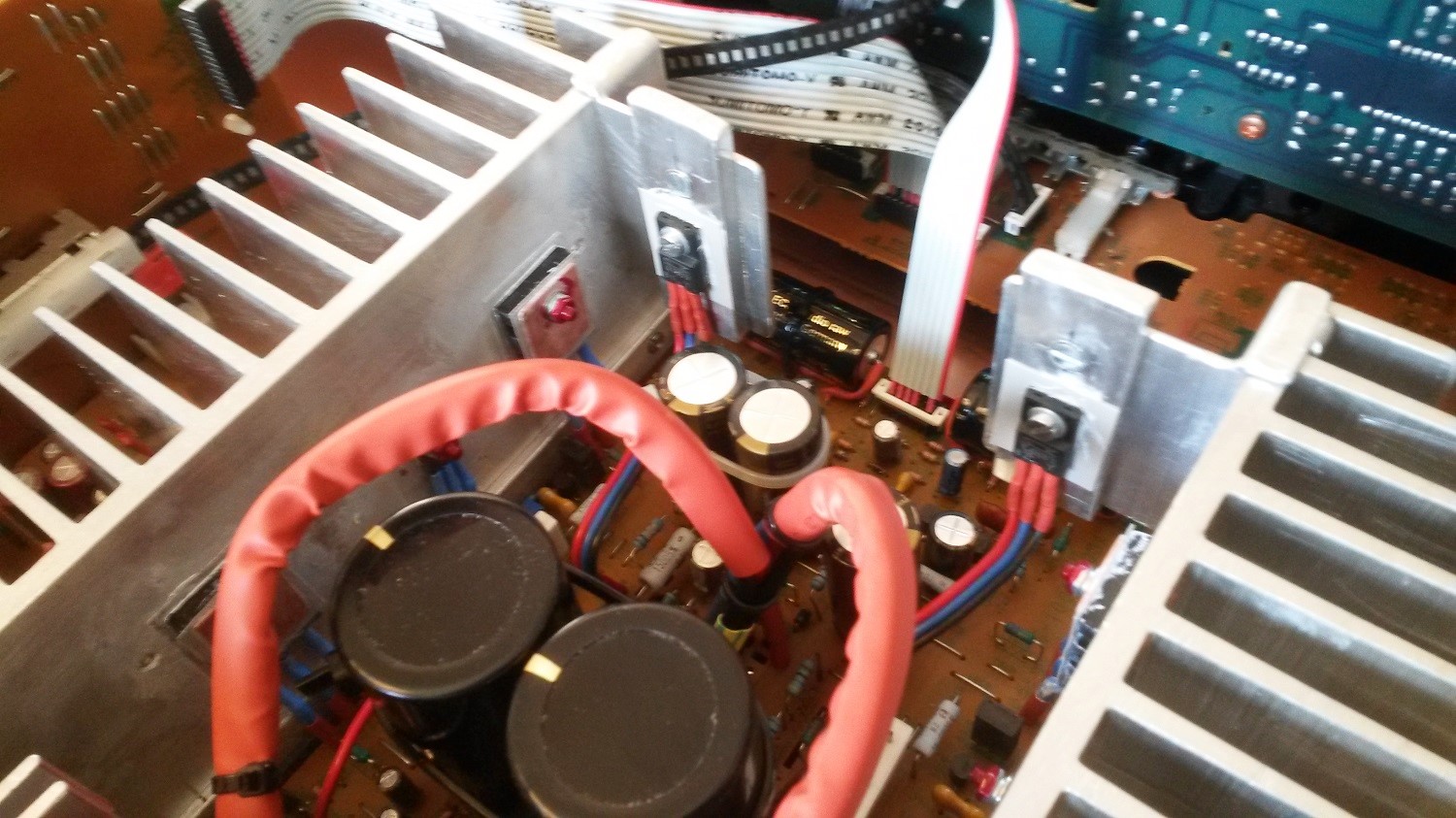

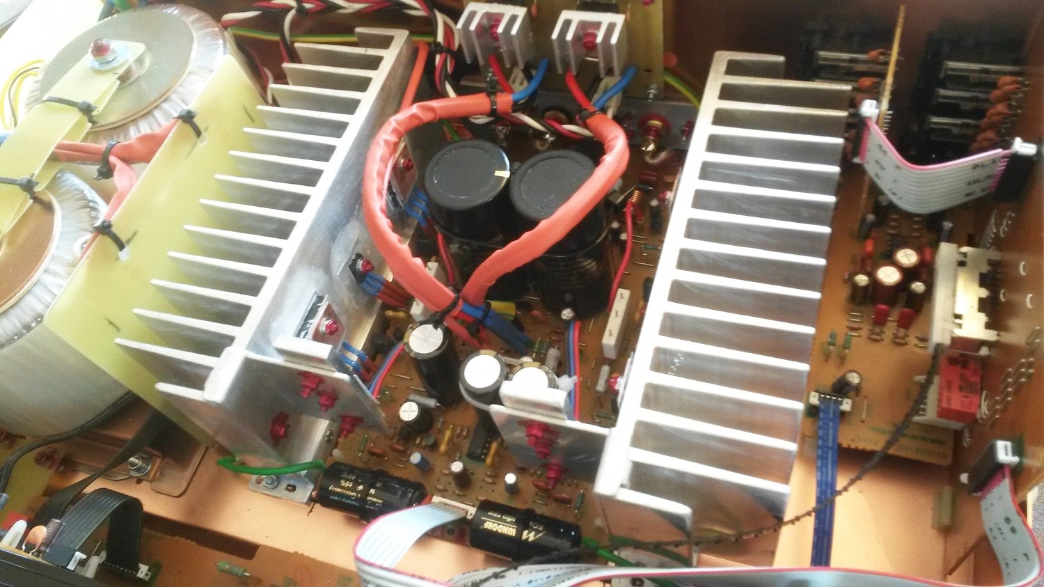

Hi Everyone,
The PM 66 KI mods topic is still alive.
Let me please share with You few modifications I did for this 20-years old stuff.
I followed Fidelity Audio with majority of suggestions and changes. Main are:
1.
additional trafo
note: dedicated rectifier bridges are kept (power lines are connected in parallel „after the bridge” - on the „DC side”). Bridges are on separate pcb.
2.
Main power transistors are now 2SA1943/2SC5200 (with idle current close to 150mA)
3.
Addtional small heatsinks for Q801 Q802
4.
Main caps: 22000uF/63V Mundorf M-Lytic
5.
Main board input caps: 100uF bipolar Mundorf
6.
Other caps replaced following Fidelity Audio guidelines (including 1% silver mica)
7.
Volume pot replaced with 50k Alps Blue (motorised)
The results are very good. It is definitely new life for this „old” amp.
Big thanks to Fidelity Audio for this thread He started (december 2005).
Regards/Marcin
