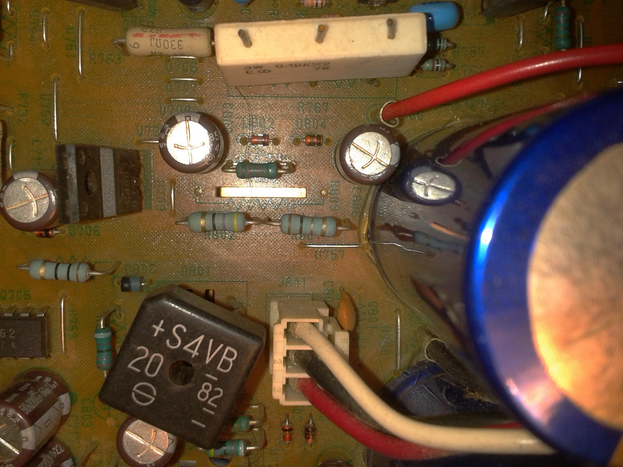

Hi Guys, posted in another thread a while back but had no luck!
I had the problem of the power LED coming on and no clunk, so I opened up my amp, replaced both the 47R that are known to go and also a 1.2k that looked very charred.
Now my amp turns on, does the "clunk" but still refuses to have any output.
Does anyone have the slightest idea what may be causing this? This is my first ever project and it's stumped me!
Hi and welcome to the forum.
There is something of a problem with finding a schematic on the web for this amplifier to be able to help. You have the part in front you and resistors have colour bands, which are a code for the resistance value and tolerance or some have it written in shorthand form like 120R or 1k2 which means 120 ohms and 1,200 ohms respectively, for example.
Assuming it is the value you want to know and not some exotic part brand you a5re trying to source, you could tell us what you read and send us a small, clear pic, attached to your post.
r802
hi ian. thanks for your welcome and reply. i have taken a pic of the resistor,it is the left hand resistor of the couple in the middle. i think the bands are gold , black , purple , yellow . if you could cofirm its properties for me i would be very grateful. thanks.
r802
hi mooly.thanks again for your interest,i have a mate who is going to meter test and do the soldering if needed next friday,im just trying to get the bits i may need before hand, resistors are cheap so if its not that thats the problem its no loss financially,i jsu cant get my amp up and running quick enough !!!! i will look at r801 and r 803 also. thanks for your help.steve
