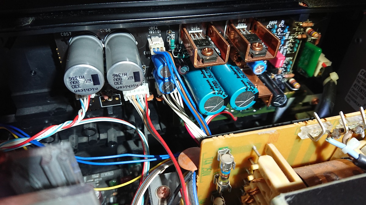

I've a PM80II on my desk right in this moment, too... @TO: Check the two 330µF/63V Cerafine at P851... Mine were cooked and showed 1,1 and 1,5 Ohms ESR (!). Replaced them with 330µF/80V Nichicon UBX 150°C-types. They would last longer than the whole amp now... Also check every (!) solderjoint on P851... They're horrible... Some of the 1 Ohms-resistors on P851 were out of range, too. If they are imbalanced you could get some offset, too.
Thanks for further advice. I think a thorough check on P851 needs to be done as I've suspected something going on there. Just to clarify, I have redone every single solder joint on all boards, but the quality on the traces is very poor, so several are vey brittle and crack easy. Espescially around where heat builds up.
When I find the time I will do this, and get back with feedback on behavior. I noticed one thing though - when playing music and protection mode kicks in, it seems like the power indicator LED's on P701 is kinda pulsating in tune with the music/beat and faint audible noise from somewhere inside the amp following the beat
