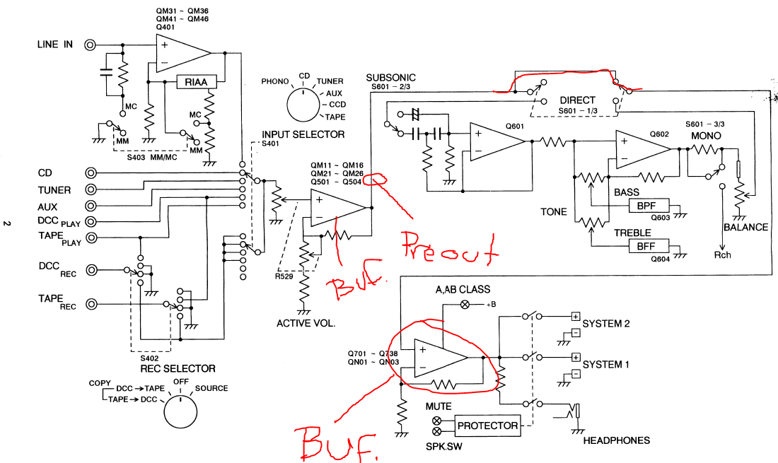

So I have another question if I may..... In near future I really need a pre-out in my amp and wanted to build one into this one. Was thinking about taking it out from J502 on P501 board. Question is - do I need to build a buffer?

J502 on board p501 is fed from buffers so yes that should be fine for a pre out without additional buffers .

Nice! Thanks. Is this the buffer circuit? Of some unknown reason I was hung up in that a buffer was made up from opamp circuitry
What you have circled is the output stage of one of the discreet opamp type circuits , the whole thing includes the rest of the circuit in the above photo . More correctly the whole of the above is one of the 2 preamp gain stages which offers buffering to the next stage . Strictly speaking a buffer is a unity gain stage able to drive a lower impedance than the preceding circuitry so yes the circuit circled is a buffer but it exists with the rest of the circuit , like the power transistor part of the main amp boards .
I think I get what you're saying, although I feel impared by my lack of knowledge. After doing some googling I see what happend. I've been reading about buffering preamp outputs to isolate and not impose impedance variations to existing circuitry. I did not however look at other than integrated opamp examples, so I could not see the buffer (symbol) per se in the preamp circuit - if this ramblin made any sense 😕😉
So concidering the block diagram, is this about right regarding exixting buffering?

Ref Post 127 what you have circled are the preamp gain stage and the main amp gain stage both of there outputs offer buffering , one to drive the tone control stage and the other to drive the speakers . As I say if you reduced there gains to unity you could call them buffers .
Yes but the output impedance of the preamp circuitry at J502 on board P501 means you should not require an additional buffer unless you want to drive a low impedance , anything 10K ohm and above should be fine .
Got it. So basically a buffer is much the same as a amp circuit, but without the gain.
