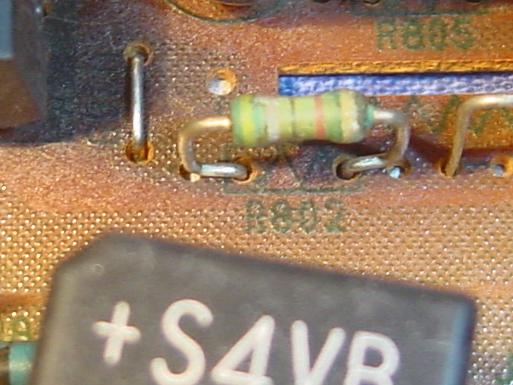

I have the same problem with my amplifier, but having found the R802 resistor, i'm not sure it is 47ohms. Could someone have a look at the attached picture and tell me if I am being stupid? I think I see yellow violet black red then maybe gold or grey? I have tested it and it is broken.

Thanks for the quick reply Netlist, but I have tested the 802 and 807 resistors, and pretty much every other one as well. I know that the 802 resistor has gone on my amp, but I don't think the colours on the 802 resistor look like 47 ohms. I'm new to this though so happy to be corrected if the fairly faded colour bands in my picture are those of a 47 ohm resistor.
Tigger01
Its definetely 47 ohms even after looking at your burnt out resistor. It would be read from yellow violet then black. A lot of people including myself have replaced this with ease.
You can actually just cut off the burnt out resistor with a sharp pair of cutters making sure there is enough of the legs left sticking out to solder a new one on top. This saves you from having to gain access to the PCB from the bottom. I did this to mine over a year ago and its still running perfectly
I think a lot of people may have gone for higher wattage 1W/2W or even splashed out on exotic ones. I would stick to a low wattage say 1/2 w which would only set you back 8p in Maplin.
My reasoning is very simple the resistor will open/blow if something goes wrong as before. This will protect the rest of your costly and possibly hard to find components. This might not be the case if you use a higher wattage resistor as you may end up with a costly problem upstream.
Keep it simple, mine is still running fine and I have used it everyday for months.

hi guys - thanks to all who tried and tested Netlist's suggestion of r802 r807 as the target for replacement/repair for the 'power up led - no audio' problem.
I would like to add that replacing r802 did not solve the problem in my case -even though r807 seemed serviceable when tested with dvm. However - replacing both r802 and r807 got the PM66 ki audio working again - for those who were unsuccessful with a srtaight forward r802 replacement, try replacing r807 as well.
