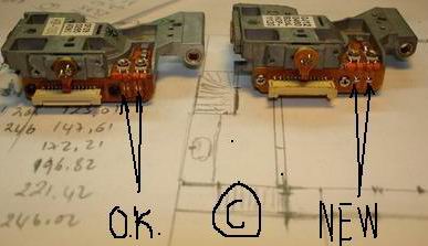

Anyone have insight to this before I mess with it again?
If the blob is there, you need to remove it.
Is there because during shipping, the coils would move too much (due to vibrations) if left not shorted. I think that even for the whole assembly, the coils are shorted during transport, because the vibrations will be identical.
Not to nitpick, but the shorting blobs are there to prevent static damage to the two laser diodes(one for cd, one for dvd/etc.), and, although I have never personally seen a laser diode get static damaged, it is as likely to happen in a laser shipped by itself as it is with a laser shipped in a mechanism, unless the mech also includes a servo board for the laser to be plugged into.

I replaced the laser system, took off the solder blob from the replacement mechanical assembly. My Marantz SA-11S1 runs like new again. CD's that wouldn't play before load right up.
This Laser is different than the original (1200W) - perhaps it is an improvement given that the 1200R didn't last long.
I re-used the old assembly and replaced the laser pickup (original 1200R with a new 1200R) and re-assembled. I left the two solder blobs in place until I ever need it.
