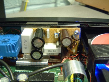

rowemeister said:How good are these caps for decoupling?
N type
I was looking at the Nx HiQ 0.47uF
I was thinking of using these with the BG 10uF 50V ones.
Brent
I think the BG's are a good choice, especially the N/Nx, but a good film cap should do even better than a BG. It's still an electrolytic! For the smaller values I'd go for a MKP or PPS.
Ray.

Those caps on my clock pre reg/psu pcb are EVOX RIFA.
Not the smallest caps in the world
Brent

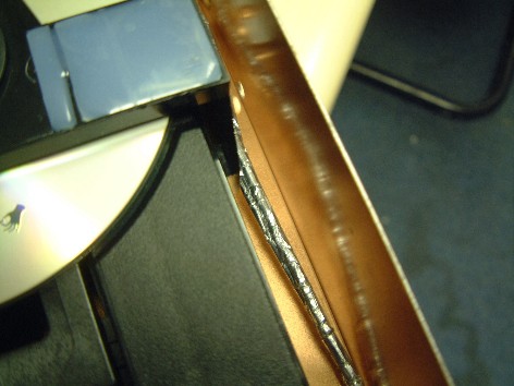

awpagan said:
only two questions
how did you run the power line to the transformer at the front of the case?
allan
I ran mains wire around side of mech to it, I shielded the cable with double layer foil. This is touching the chassis all the way round so is grounded.
Here is an old pic
Brent
