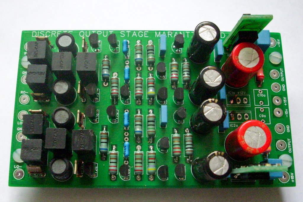

Not sure what values were used in the picture that's on Rays site. I believe this is Steve's board. Not sure what player its for. I wonder how much difference it would make to the filter or if the cap value could be changed to compensate for a 2k2??

Filter should be the same tho!! The SA8400 diagram show both resistors as 2k7.That's the older none cfp board

I thought I recognized my board. It's a cfp board, btw. I use it in one of my 8260 players, nearly identical to the 8400. The filter resistors are 2k87. I got them direct from Texas Components. They will make any value resistor that you like, and send them anywhere you live. The resistors I got were just under $7 each.
BTW, the next version of the board looks a bit different, though the filter section is the same.
