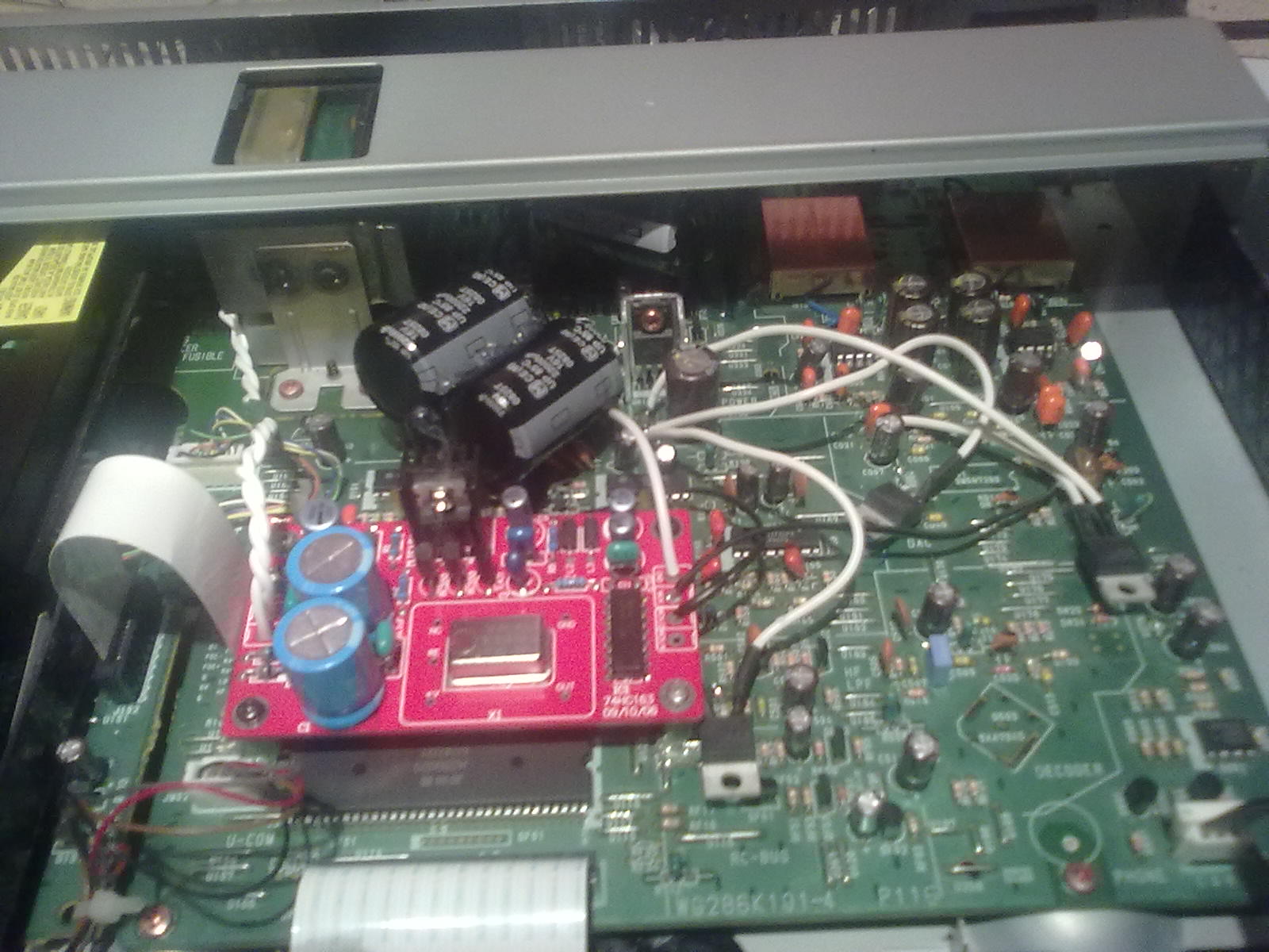

...any chance to build a divide-by-8-circuit which can be connected directly to the 16,9344 Masterclock for BIT reclocking...?
Also i could need some clarification about reclocking the decoder. In the standard CD63 the manual shows that the clock-signal is looped through the dac and then seem to run straight via a 100R into the decoder's CRIN.
This is leading me to the asssumption that it should be possible to run another coax from the clock to the decoder...
I know this has been dicussed before, Brent stated at that time that doing so, is giving issues (for some reasons).
On the other hand i see in the MKII/KI Manual this "arrangement" of resistors and small capacitors around the decoder's clock-input which have been implemented for some reasons i guess; and it makes the reclocking more complicated because of the coax-cables capacitance (there is a 10p cap in series with the clock signal)....
So, if this is necessary, why is the "clock-feed" for the decoder working in a standard CD-63 at all? What am i missing or misunderstanding? (...probably everything...)

Mickie. I think it's something to do with phase.
The clock output from the dac is buffered and I've not had issues running a buffered clock straight to the decoder. However, both Brent and I have experienced issues when running the clock straight to the decoder from the oscillator with no logic buffer.

I'm having trouble fitting a Tentlabs XO2 to my KI. I had originaly fitted a clock but wanted to clock the servo so I replaced my old audiocom clock with a second hand XO2 but it will not work. It reads the disc but soon as a track starts it jumps skips hops and stops. I removed X101 and R126. I used screened cable from the clock with the servo end screen not connected and the inner connected to the right hand hole where the resistor was. I'm sure this is right isn't it? Because the clock module is on the right of the case the wire to the servo is about 4" long. Could this be the problem? If I make it shorter I have to make the other (16.944) one longer. Any help would be much appreciated. Barry
Hi barry ,I'm having trouble fitting a Tentlabs XO2 to my KI. I had originaly fitted a clock but wanted to clock the servo so I replaced my old audiocom clock with a second hand XO2 but it will not work. It reads the disc but soon as a track starts it jumps skips hops and stops. I removed X101 and R126. I used screened cable from the clock with the servo end screen not connected and the inner connected to the right hand hole where the resistor was. I'm sure this is right isn't it? Because the clock module is on the right of the case the wire to the servo is about 4" long. Could this be the problem? If I make it shorter I have to make the other (16.944) one longer. Any help would be much appreciated. Barry
I used ordinary wire on mine clocked the dac @ 16.934 and the servo @ 8.46 wire length should be imaterial your connections are ok must be a duff clock.

Is the output marked mck1 or 2 barry ?? do you have a counter to check output frequency.

You should be able to work out the right hole to put it in. I can't say which that is from memory, though.
Otherwise, maybe it doesn't like the long lead but I think 4" should be just fine.

Simon, my wife thinks 4" is just fine but unfortunatly when I measured it, (the cable that is) it is more like 6". I did put it in the right hole, the hole on the right where the resistor was. I followed the circuit diagram. I'm sure that's the right hole. (you will have to ask Frances) If it was the clock module, I can't think what components apart from resistors could be duff! My silly scope blew up 4 years ago, so that's no help.
