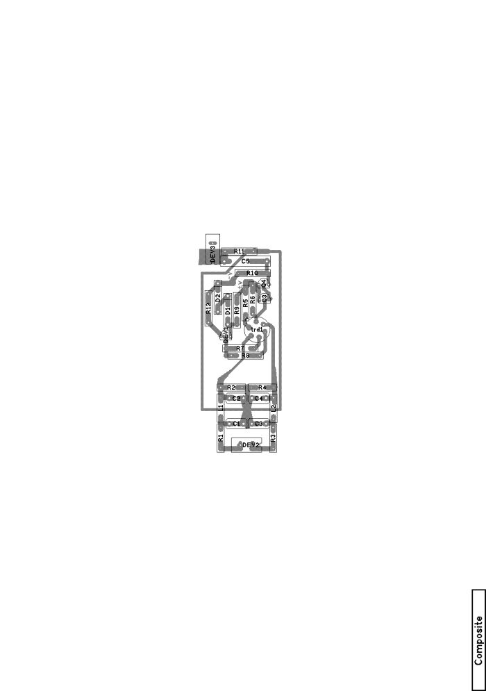

i made a pcb for the filter buffer, small enought to sit over the opamp to hdam circuit.
allan
