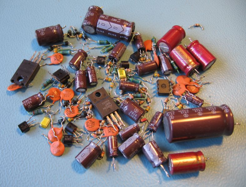

Hey, I was thinking about posting an even more explicit one.
But I have another one that shows some loose parts 😀
Ray.

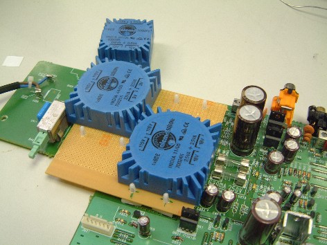

Transformer
Hi.
What news on the Super-Tx ??
I see new reader Griffymark is looking for one as well !
Andy
Hi.

Re: Transformer
Funny you should ask.
I have a KI with duff (or should we say previous owner knackered it) TX.
With no news on custom TX I am going down this route for this player.
poynton said:Hi.
Andy
Re: Re: Transformer
Outboard Tx - I like it !!!
Re: Re: Transformer
Seriously .. It does give more flexibility in power supply design.
Farnell do a Tx with 4 windings - multiple 5v supply?
The only 'problem' is the heater for the display.
Andy
Andy
Re: Re: Re: Transformer
Yes the heater supply is my only going concern. I will have a spare 12ac winding on the little TX and was planning on dropping the voltage through a potential divider
Brent
Andy
Brent

Those TX above are for another CDP.
And my player at home weighs 7.16Kg lol and the rack it fine lol
